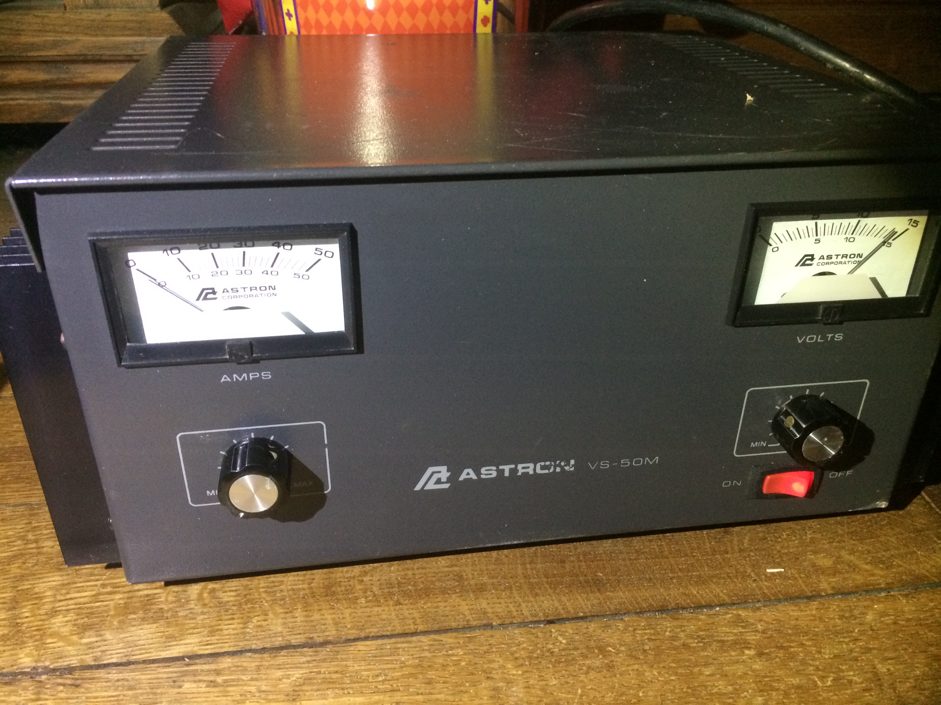

Yep, even better if you keep it in your garage (25 kgs...)
Probably many of them, used, can be found in the US.
I was lucky to source a used VS-50 in Belgium

Default Looked like a battery charger
I had a key programmed last week. Brutal had a large roll around power supply. It was big and heavy.
It looked more like a battery charger. I have used regulated supplies at work for years. This definately looked more like a charger.
Worked great, key was programmed in 20 minutes or so.
He is a Master Tech, if a charger would not be stable he would not use it.
