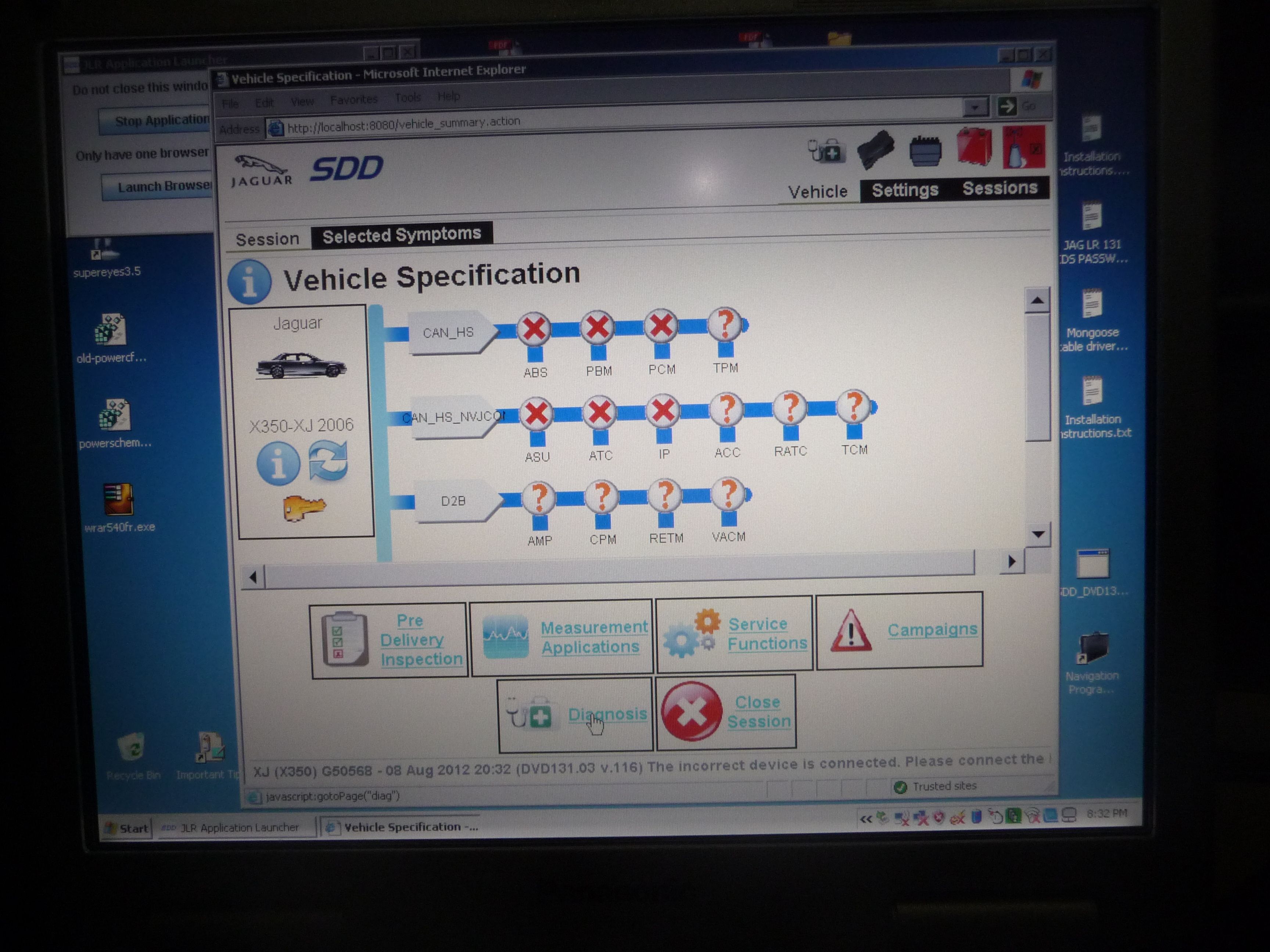

So, to be sure I understand correctly (and for others as me, not geeks):
- you start SDD on your laptop with the date put at (whatever it is, in my case with v131.03 my laptop's clock is always set/blocked on August 2012),
- you then plug your VCM or Mongoose in the OBD2,
- you wait for VIN recognition, and here it comes:
Do you start a new diagnosis session by clicking on the bottom box on the SDD screen (which will then store data first)?
Or do you go straight on clicking the icon with the two curved arrows on the left of the SDD screen, which in principle should restore the initial vehicle data?
Attached Thumbnails ECM Not Communicating With SDD - RESOLVED-sdd-startup-screen.jpg
Old Mar 21, 2017 | 03:06 PM
  #66
joeleerj's Avatar
Joined: Sep 2016
Posts: 357
Likes: 80
From: Memphis, Tennessee
Like you I have v131.03 and it was also blocked to August 2012. So, the first thing did was advanced the date to December 2013. After that I connected the SDD as normal, entered the VIN (my ECM would not communicate), waited until the SDD collected data on my car. After that the screen below was shown. I clicked the green icon next to the key. Then the other screen appeared. After clicking agree, I then entered campaigns and flashed the ECM
