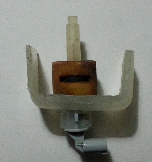

I had the low coolant msg prior to replacing the reservoir, the nipple broke due to an error on my part while doing something else. I honestly believe the connector is at fault, but will need to test it after the holidays.
I intended to post photos of the sensor in my first post and forgot....I might cut open the old reservoir and post photos of the float and internal baffles.
Attached Thumbnails Engine Coolant Low - Error displayed in Message Center-sensor-1.jpg   Engine Coolant Low - Error displayed in Message Center-sensor-2.jpg   Engine Coolant Low - Error displayed in Message Center-sensor-3.jpg   Engine Coolant Low - Error displayed in Message Center-sensor-4.jpg

Here it is:
Cross section of the sensor mount and float.
Note: The float is soft and easily damaged, contains a magnetic ring that encircles the sensor.
Attached Thumbnails Engine Coolant Low - Error displayed in Message Center-20161123_181627.jpg   Engine Coolant Low - Error displayed in Message Center-20161123_181639.jpg   Engine Coolant Low - Error displayed in Message Center-20161123_181656.jpg   Engine Coolant Low - Error displayed in Message Center-20161123_181817.jpg
