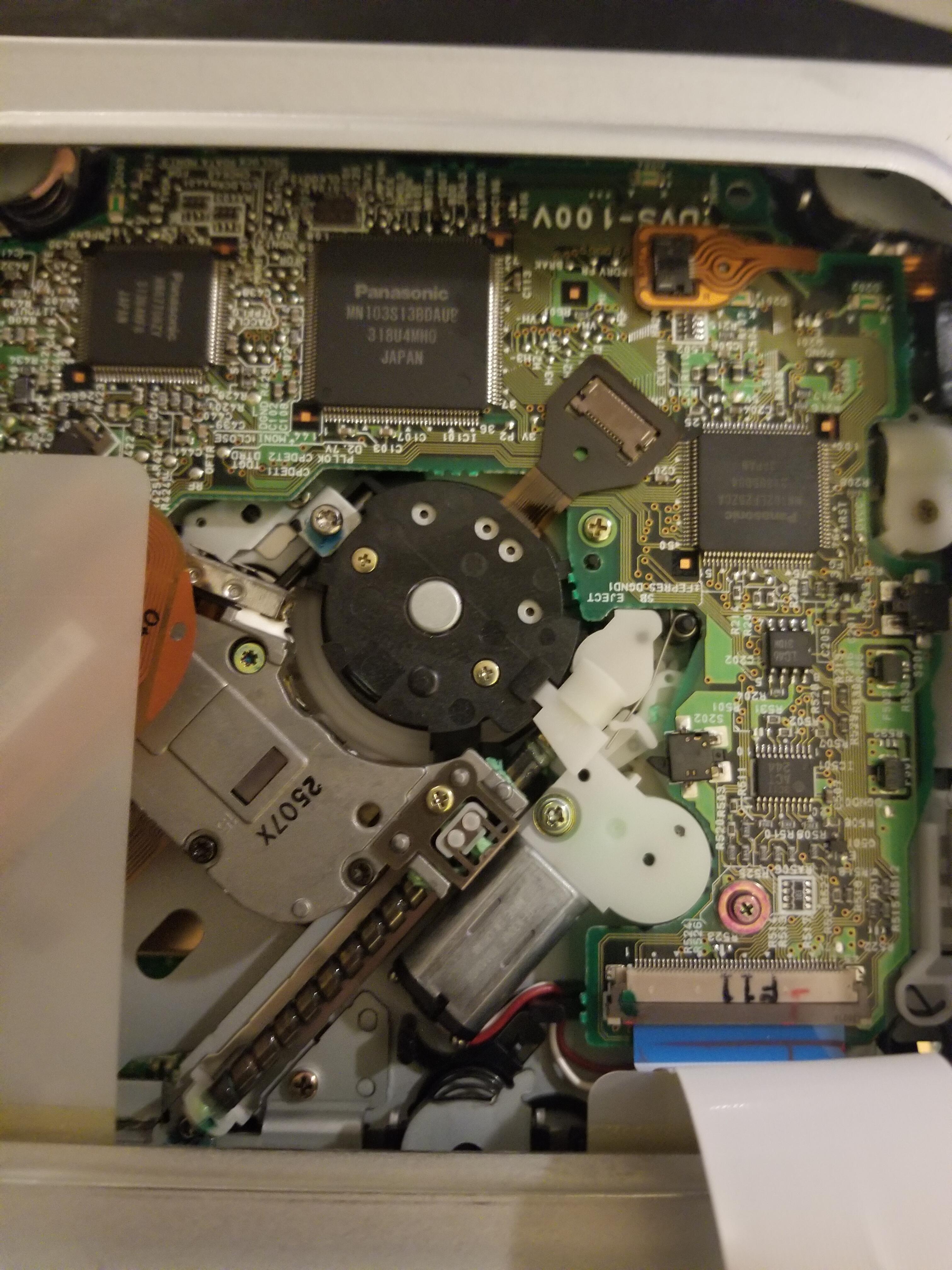

Condition of the replacement unit was a bit dingy, my old unit was cleaner - it was probably sitting on a shelf. Nonetheless, who cares - it works
I opened the old reader unit.
It's basically 4 Phillip's screws (3 in back and 1 behind the front cover) pop the front cover off and remove screws.
Upon opening there was a distinct burnt electrical smell to it.
These units run hot in the stack in the boot.
Not much air flow. Nothing didn't really stuck out upon inspection but the motor that spins the DVD ROM looks spent, if that makes sense. Also, the small ribbon in the second pic looks like it has a burnt spot as well.
Attached are few pics.
The actual DVD driver is held to the circuit board with again - 4 Phillip's screws...
Also, there is a battery soldered to the board and what looks like a memory chip, hence the previous saved locations, etc. despite being disconnected for a while before I installed.
In nav options you can simply delete all previously stored locations and start fresh.
2003 technology at its finest.
A simple drive around should get the nav in the right spot w/ the GPS antenna. I went the extra step and did a hard reset as I started putzing with calibrations.
No lag time while driving like before.
Again, its antiquated technology and not that I use it but if it's in my car it has to work.
