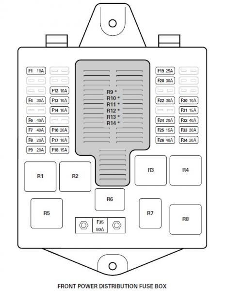

The air suspension of my X350 seems to be faulty.
Its rear has gone down, but the instrument cluster does not show an error message.
The compressor was checked and runs fine when 12V are put on, but during driving it does not work.
The ASM or ASU seems to be in function as well, because after starting the engine, the ASM presents +13V on PIN 12 of connector CR91 (still a mystery).

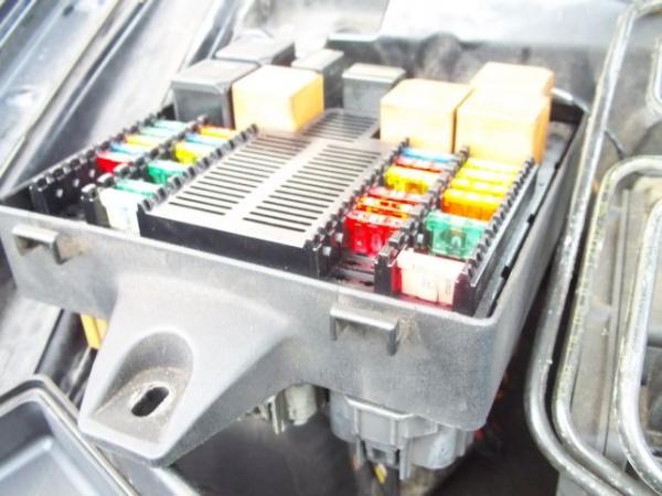

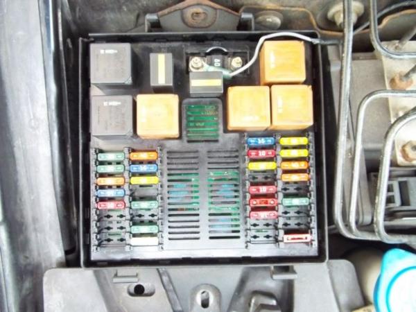

But the R1 relay (air suspension relay) of the front power distribution fuse box (Reyesl published a PDF here) constantly gets +12V on PIN 3 and no current on any other PIN no matter if the engine has been started or not.
I swapped R1 and R2 and checked low beam and high beam to ensure that R1 is not the culprit.

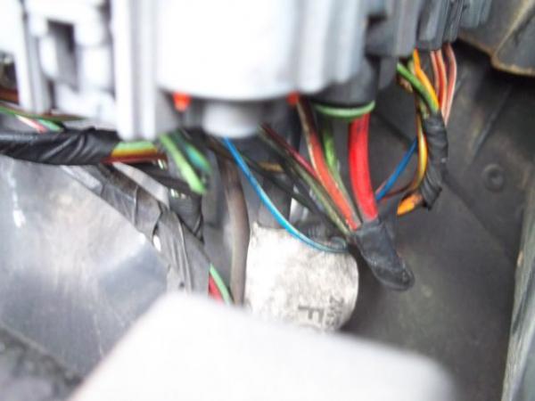

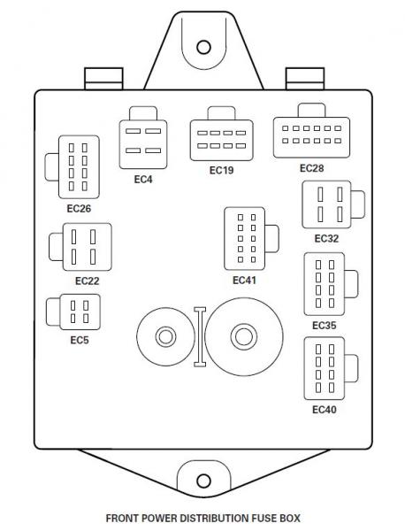

Time to check the downside of the front power distribution fuse box.
The incoming +12V cable connector from the ASM is EC40-1.
The outgoing +12V cable connector to the compressor is EC32-2.
The problem is I cannot check them because I cannot lift up the front power distribution fuse box far enough.
The harness is too short and getting there from below could be very laborious.
Do you know how to check the lower connectors of the front power distribution fuse box ?
Maybe the ASM gets stuck in an unfinished check procedure and therefore cannot present any error code.
The vent solenoid valve of the compressor could also be the trigger of this fault.
I did not dare to put any test current to its connectors.
How would you check the vent solenoid valve and is there any way to put it back to order ?
Thanks
R1 is back in the front power distribution fuse box.

Peculiar !! If the system has flagged nothing, it must think the suspension is at the correct height, so suspicion must fall on the height sensors. Other thing is you maybe need the sensor values recalibrating. This is a shop job with the relevant Jaguar software on a lap-top. The laptop is plugged in to the diagnostics socket and then used to raise the car to the correct height front and rear, and the system then 'knows" what the correct height sensor outputs are.

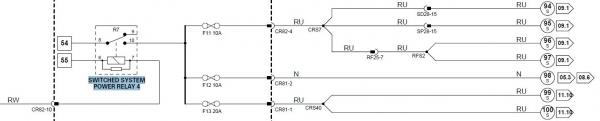

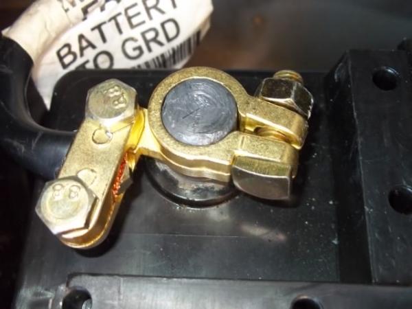

Talking Culprit found
Peter Brecklinghaus of british car service, Essen found a workaround:
R7, which contains SSP4 (Switched System Power 4) relay, should trigger the ASM to stance mode over fuse 12.
But there were no +12V on fuse 12, so the ASM stayed asleep.
He carefully gave 12V B+ to fuse 12 for a second when the ignition was on.
(If you plan to DIY better know what you are doing and use a cable protection fuse under 10 Ampere.)
The ASM began to initialize and check. Next thing he did was to start the engine.
The compressor behind the left front bumper gnarled and soon the car was lifted onto its normal position.
A short test drive showed no functional disorders.
Unfortunately this procedure has to be repeated after the car was parked for more than 30 minutes and the ASM has fallen into sleep mode again.
So a defective relay (R7) kept the ASM in its koma.
Because it cannot be replaced Jaguar calls it a 'Non serviceable PCB relay'.
That means a new rear power fuse box is needed.

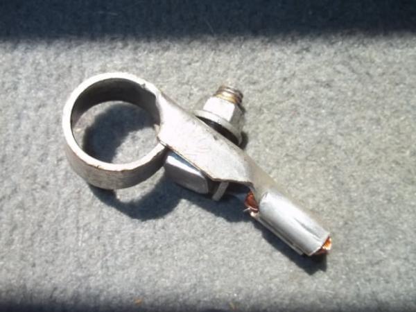

But who is responsible for the death of R7 ?
A loose connection of a defective clamp on the minus pole is under suspicion.
It was not possible to tighten this tinny looking clamp any more, so it was exchanged for a more solid model.
What else can we do to protect the poorly buffered controllers in the Jaguar electric circuit ?

Good work tracking down the defective R7! If you can access the solder terminals of that relay, you may be able to find a suitable replacement from an electronics supplier such as Mouser or DigiKey - I'm not sure what the equivalent supplier would be in Germany, but I'm sure there is at least one.

Exclamation Affected by Switched System Power relay 4
These circuits do not work when SSP relay 4 (inside non serviceable PCB relay R7 of the rear power distribution fuse box) is defective:
94 LH REAR FOOTWELL LAMP
95 RH REAR FOOTWELL LAMP
96 LH REAR ASSIST HANDLE (MAP LAMP, COURTESY LAMP)
97 RH REAR ASSIST HANDLE (MAP LAMP, COURTESY LAMP)
98 Air Suspension System
99 Rear Seat Heaters
100 Rear Seat Heaters
