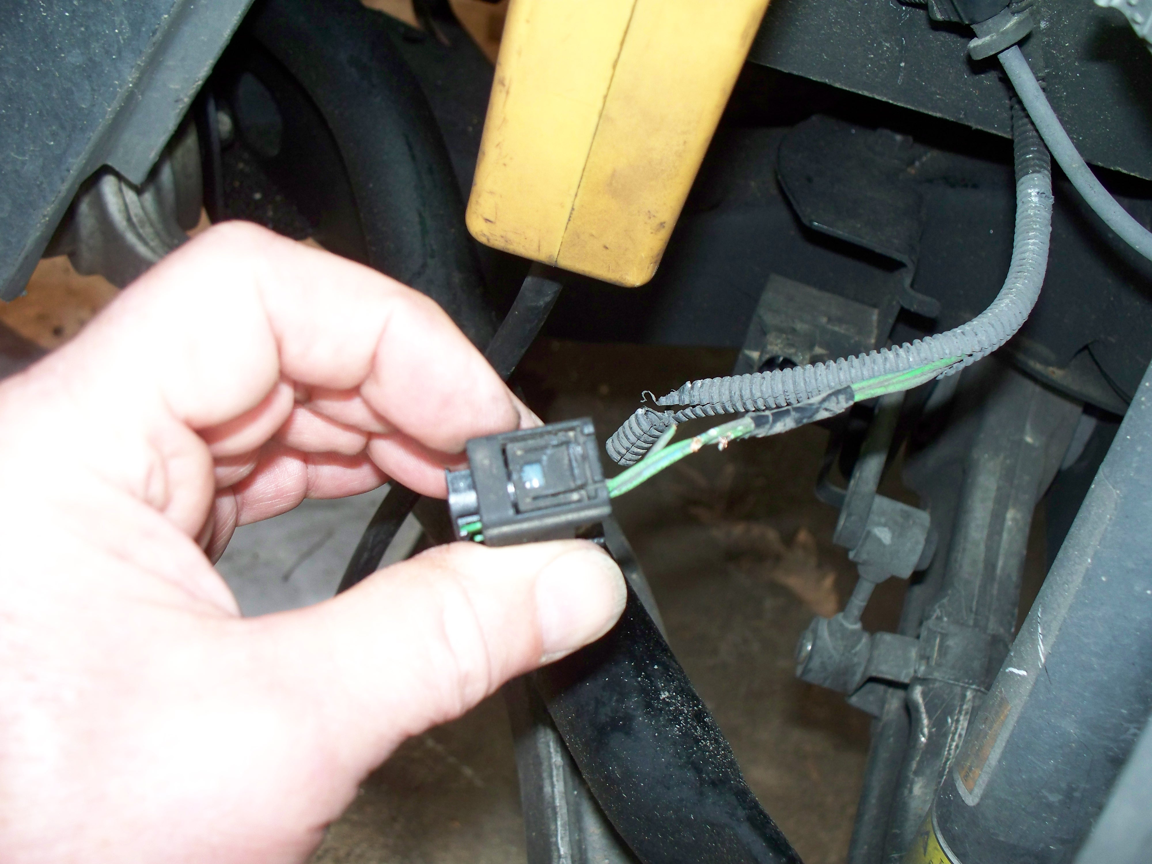

I got the SV8 up high enough with wood blocks and two floor jacks at the OEM jacking points and took one wheel off to find the problem with the level sensor – a broken wire inside the sheath. I love it when a fault cause becomes obvious.
A soldered patch wire, some heat shrink and tape, and a short drive to let the compressor wake up, and it is back to normal. Unfortunately that also means the usual front end clunk is back too, but that's for another day.
