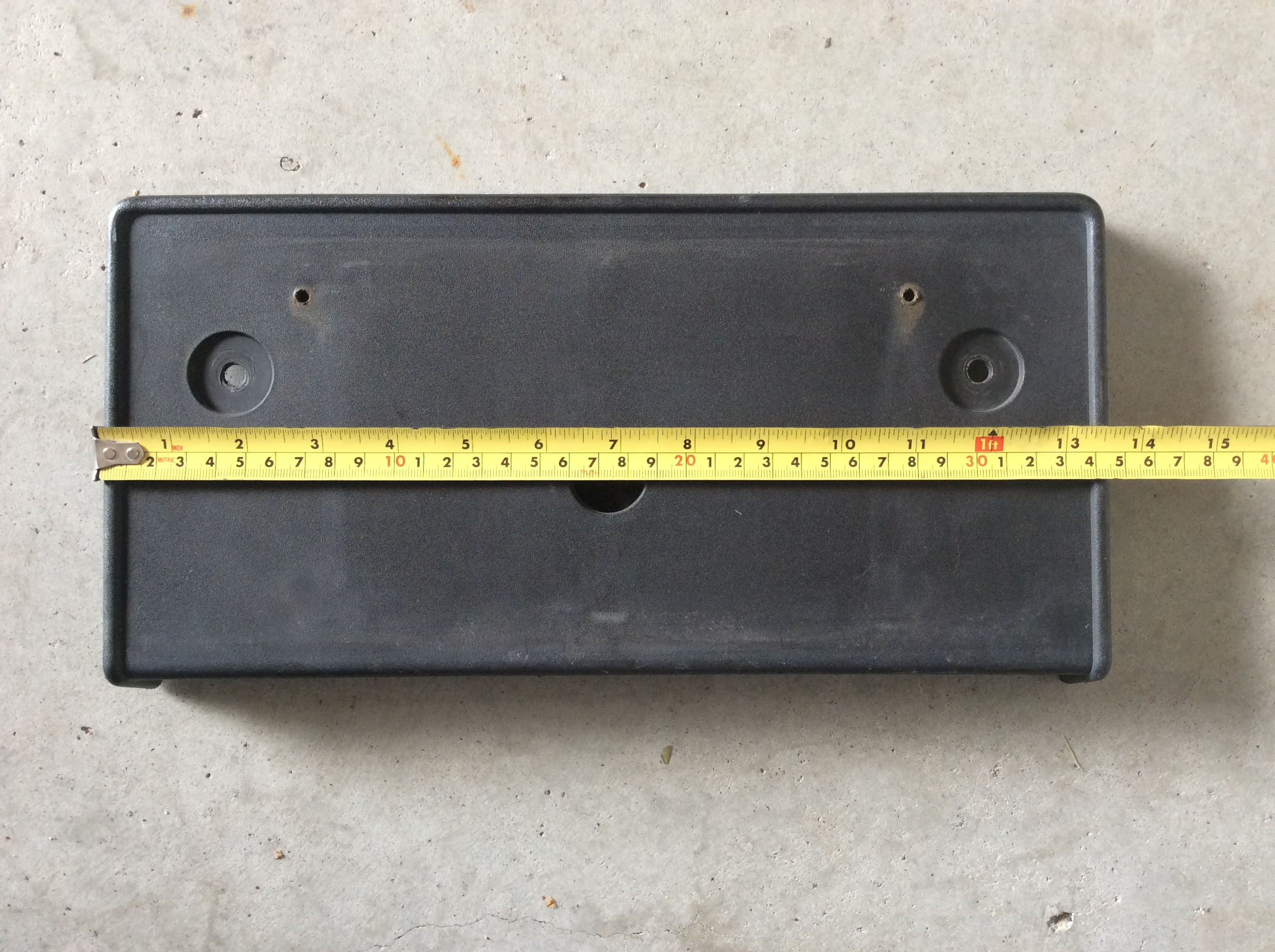

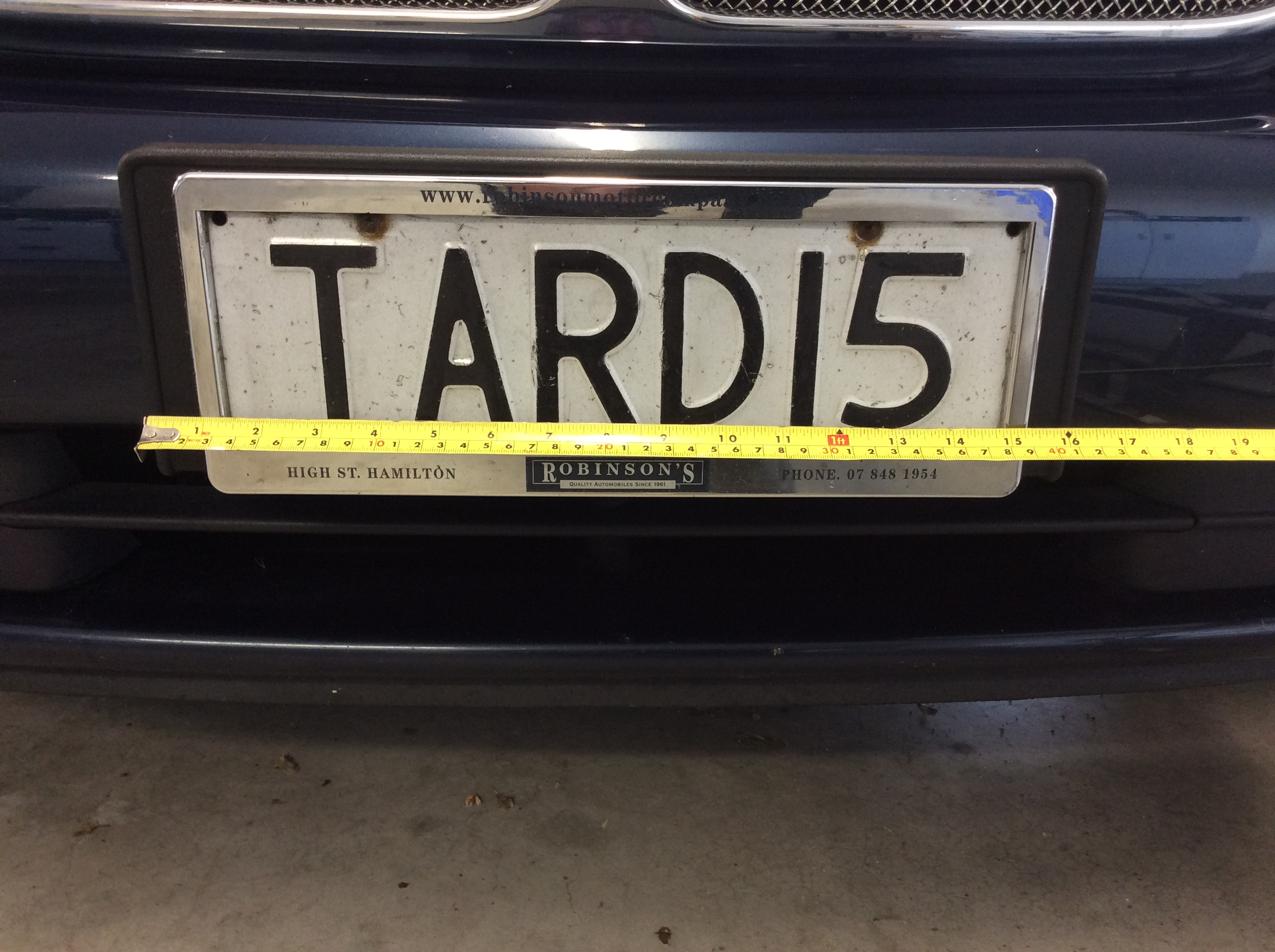

As requested:
The first photo shows the old, narrow, Japanese market plinth.
The second photo shows the new one fitted to the car.
The new plinth shields the plate itself from the parking sensors. The rough plastic surface of the plinth obviously damps or disperses the sensor signals enough not to register.
