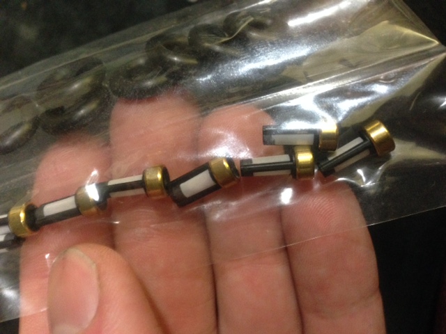

You can see in the pictures below the difference between the new filters and my old ones. 7 of the 8 old filters didn't have any filter left on them at all.

Hi XJ8JR,
Thanks for the photos! That's really interesting that the filters were deteriorated. When I cleaned the injectors on our '93 at around 190K miles or so, the filters were filthy and half clogged, but the filter mesh was still intact on all six injectors. Can you think of any reason your filters may have deteriorated, such as fuel additives, injector cleaners, etc?
The filters look identical to the ones in our '93. I wonder if they are a standard size used by multiple manufacturers?
