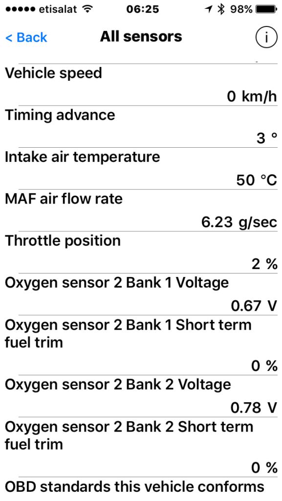

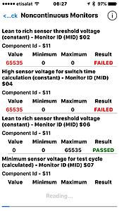

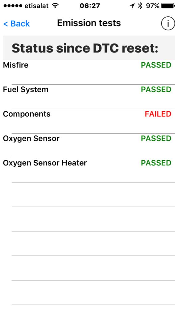

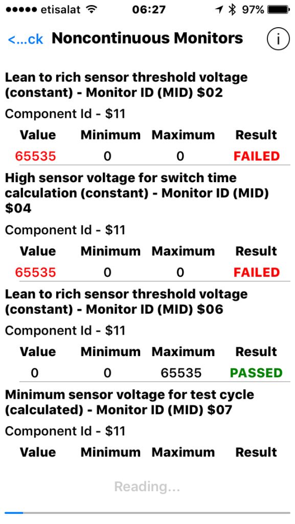

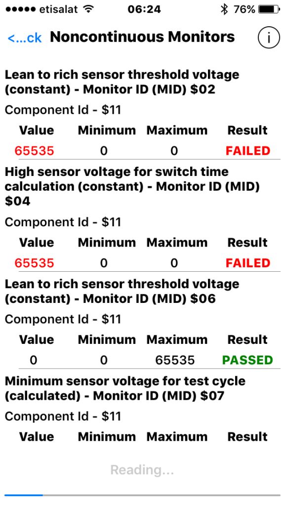

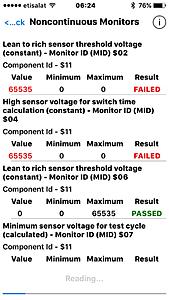

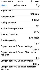

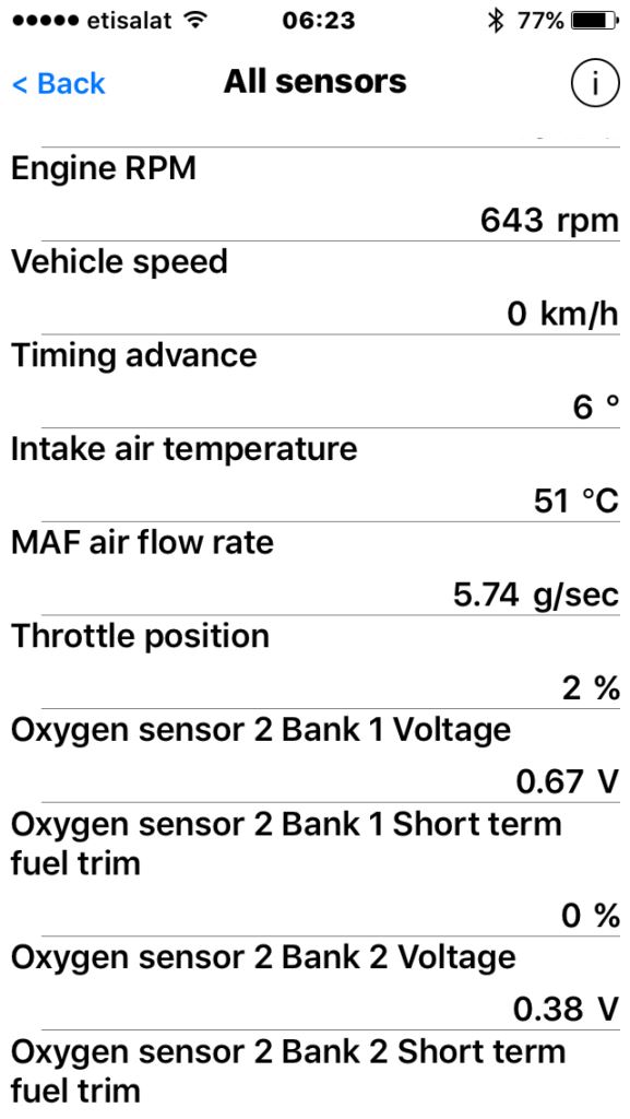

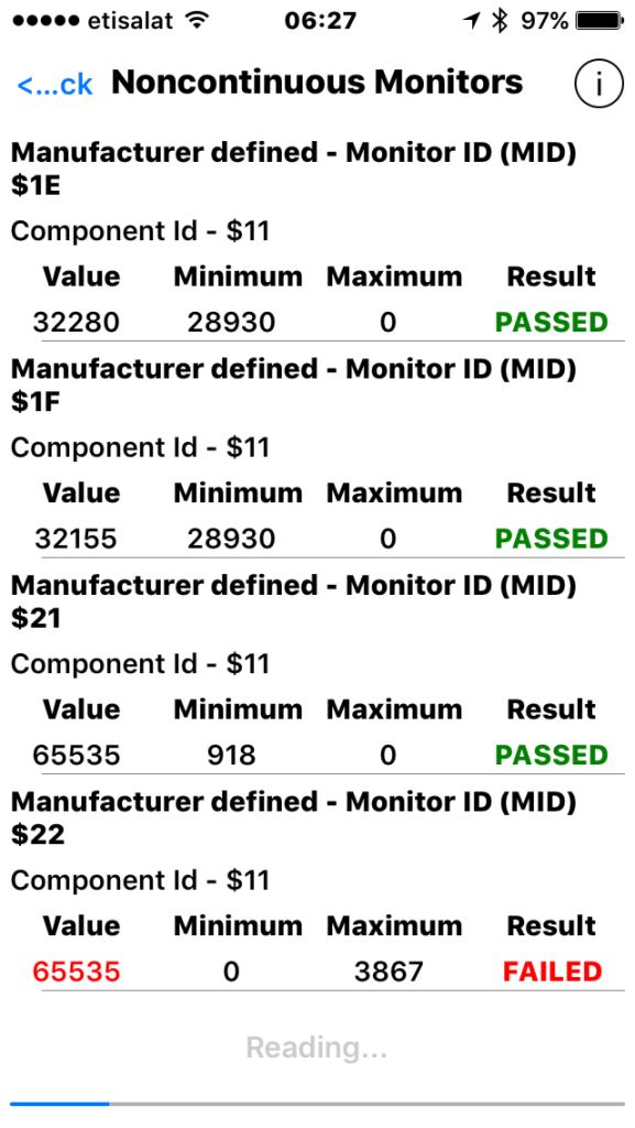

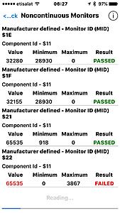

I am getting similar voltage and resistance readings on the other bank; for example: Coil 5. 11.30 volts (I'll be recharging my battery tonight) and 1150 for resistance pin 4 to earth. I really do not understand what relevance 1150 has to the more than 10,000 ohms I am supposed to be getting - But surely the key point here is that the reading for Coil 5 (with no pending DTC) is virtually the same as that for Coil 2 (with a pending misfire DTC)?
Unless:
a) I am not taking the measurements properly. Obviously my multi-meter cable will not reach the negative battery terminal so I am using a nearby earth.
Or b) My misfire is being caused by something other than plug, coil or connection? Perhaps the injector?
However, wouldn't a faulty injector show up as a DTC all of its very own?
Attached Thumbnails Fuel Trims Bank 2 - P0405?-all-sensors-1-24.12.jpg   Fuel Trims Bank 2 - P0405?-all-sensors-24.12-2-.jpg   Fuel Trims Bank 2 - P0405?-emission-tests-24.12.jpg   Fuel Trims Bank 2 - P0405?-non-continuous-monitors-1-24.12.jpg   Fuel Trims Bank 2 - P0405?-non-continuous-monitors-2-24.12.jpg

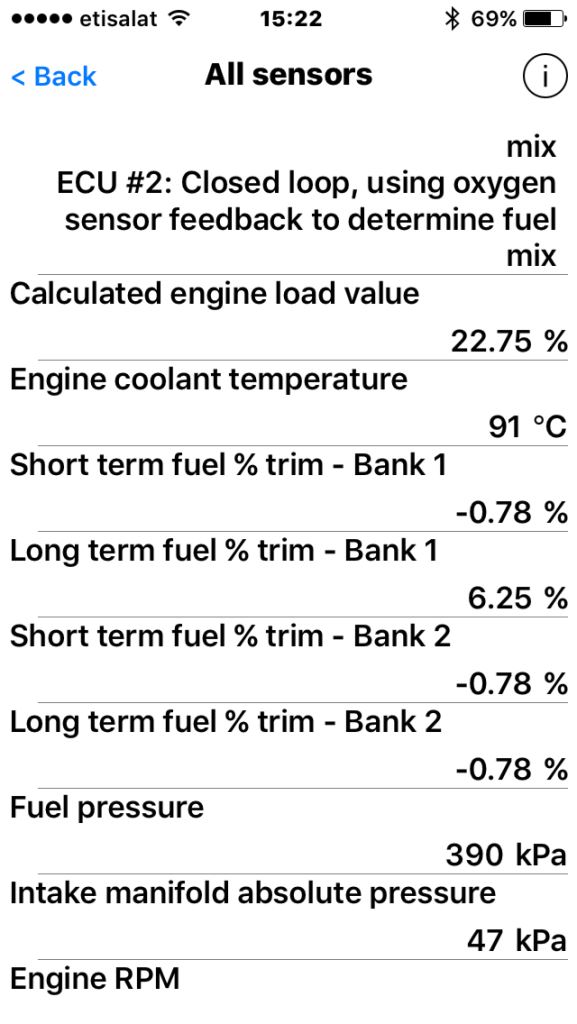

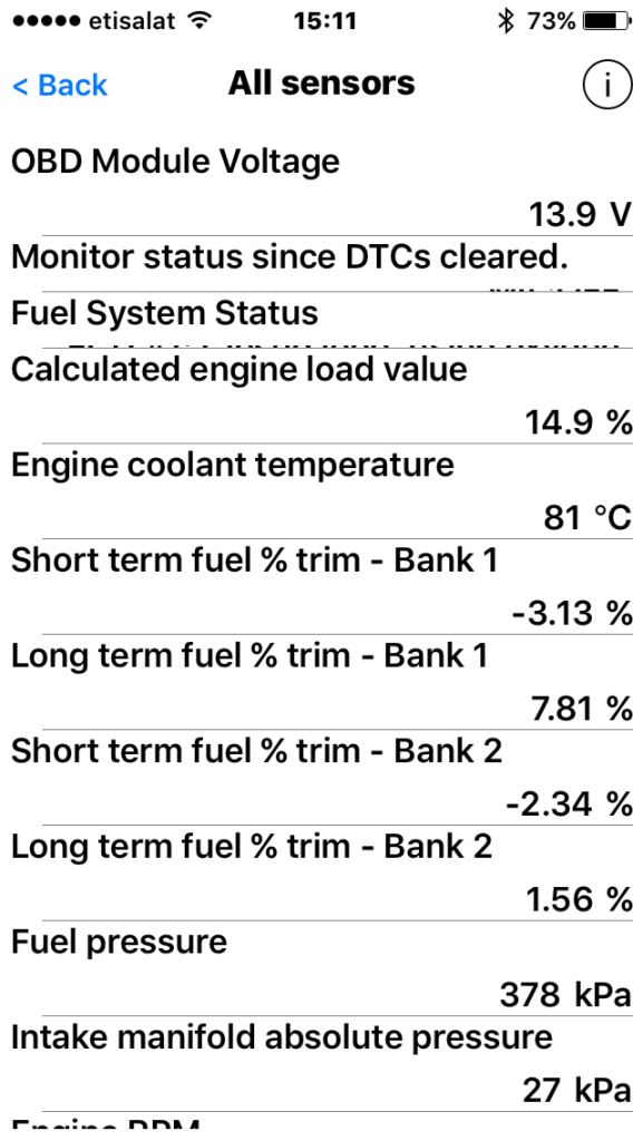

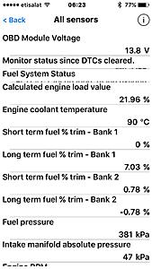

Default Fuel Trims

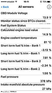

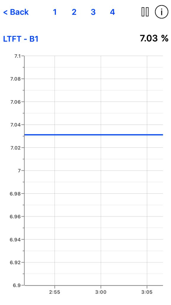

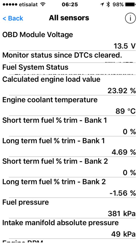

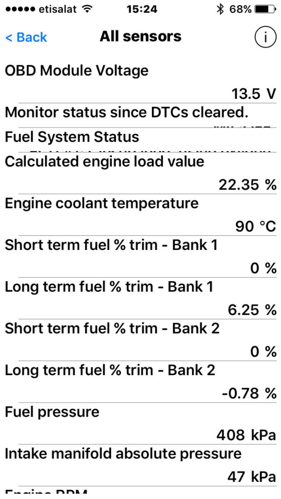

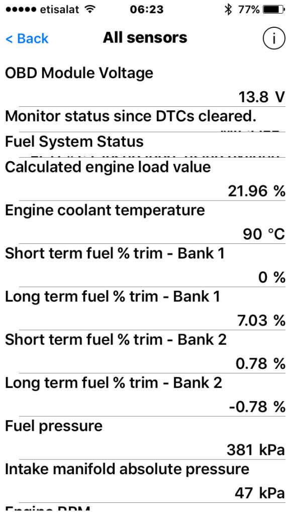

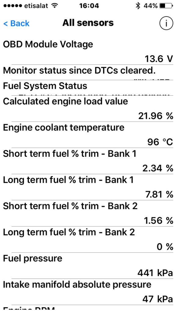

Dear Forum,
Here are my fuel trims after cleaning oil from plug wells, replacing plug boss seals and cam cover gaskets, replacing all plugs and coils and repairing loose wire in EGR Valve connector.
Currently no codes and all seems fine.........
Apart from the occasional cloud of black/grey smoke at startup (renewing fuel filter on Saturday) and the very occasional gear slam (well, once) when pulling away from lights (followed by a cloud of black/grey smoke) and on another occasion, a sudden and unexpected change-down (once). Neither event caused any lights or codes?
Question: Non-Continuous Monitors may need the longer run I will be taking on Saturday? - But having said this, I could well be wrong since I don't even really know what they are!
More important question: Am I reading these fuel trims correctly; my bank 1 LTFT is enriching by 7% to cure a bank 1 lean mix and keep my bank 1 STFT at 0%? If so, could this be a vacuum leak on bank 1?
Regards,
Ray

Check the readings again to make sure they're about the same and then rev to about 2500 and watch the trims (for 30 secs or less, it's not critical, just till they settle).
With an air leak they should head much nearer 0.

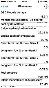

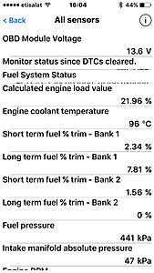

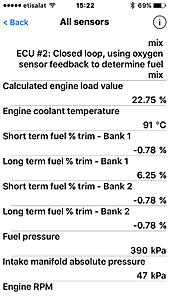

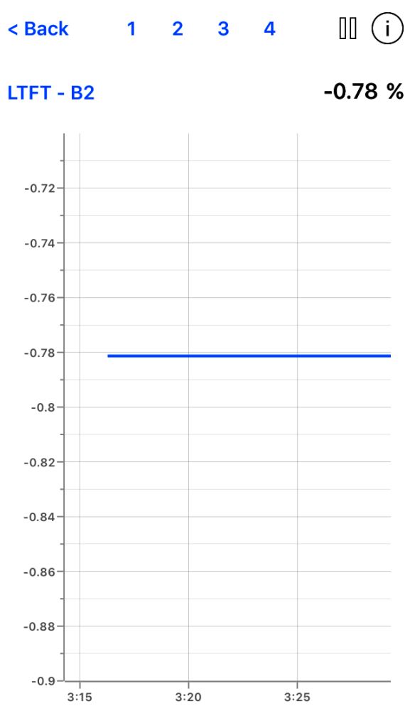

Originally Posted by JagV8
Check the readings again to make sure they're about the same and then rev to about 2500 and watch the trims (for 30 secs or less, it's not critical, just till they settle). With an air leak they should head much nearer 0.
Hello JagV8 - Thanks. Done as you suggest - Pic 1 at after warm-up, pic 2 after 2,500 revs and pic 3 after rest; not sure whether or not the results are particularly telling? I am taking a decent run out on Saturday, so I will try again after that - See if there is any change? Also on Saturday my fuel filter will be renewed (probably from birth 100,000 miles ago)!
Meantime, there does appear to me to be an imbalance here - Am I reading this correctly as a lean bank 1? Any thoughts, please?
Regards,
Ray

They don't look to move much so probably not an air leak.
What is the actual problem now? I don't really see one.

My (limited) understanding is that if all the long & short term fuel trims are around zero, all is well? However if (say) bank I has a plus 7% LTFT it is because the bank 1 STFT is too lean? Is that right? If so, is 7% something to look at?
I am under the (mis?)apprehension that bank 1 LTFT of plus 6-7% opposed to LTFT Bank 2 of close to zero is an imbalance. If this is approaching normal for a 13 year old car with 100,000 miles on the clock, please say so and I will stop being such a pest - After all, you guys have taken me on a 'rollercoaster ride' from 6 DTC's to zero!!

Ideally LTFTs are closer to zero than 7 but it's not a big tweak for an engine of that age and miles.
It MIGHT hint at a problem but it might not and you could chase it forever. If you'd rather go on hunting that's up to you but I'd leave it unless (or until) I had something clearly wrong to chase.
STFTs by their nature swing around somewhat. If consistently one way then LTFTs move and the STFTs reduce. (Thus the S and L.)
