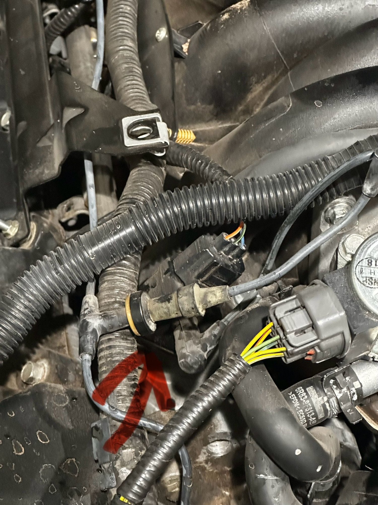

Hey Guys,

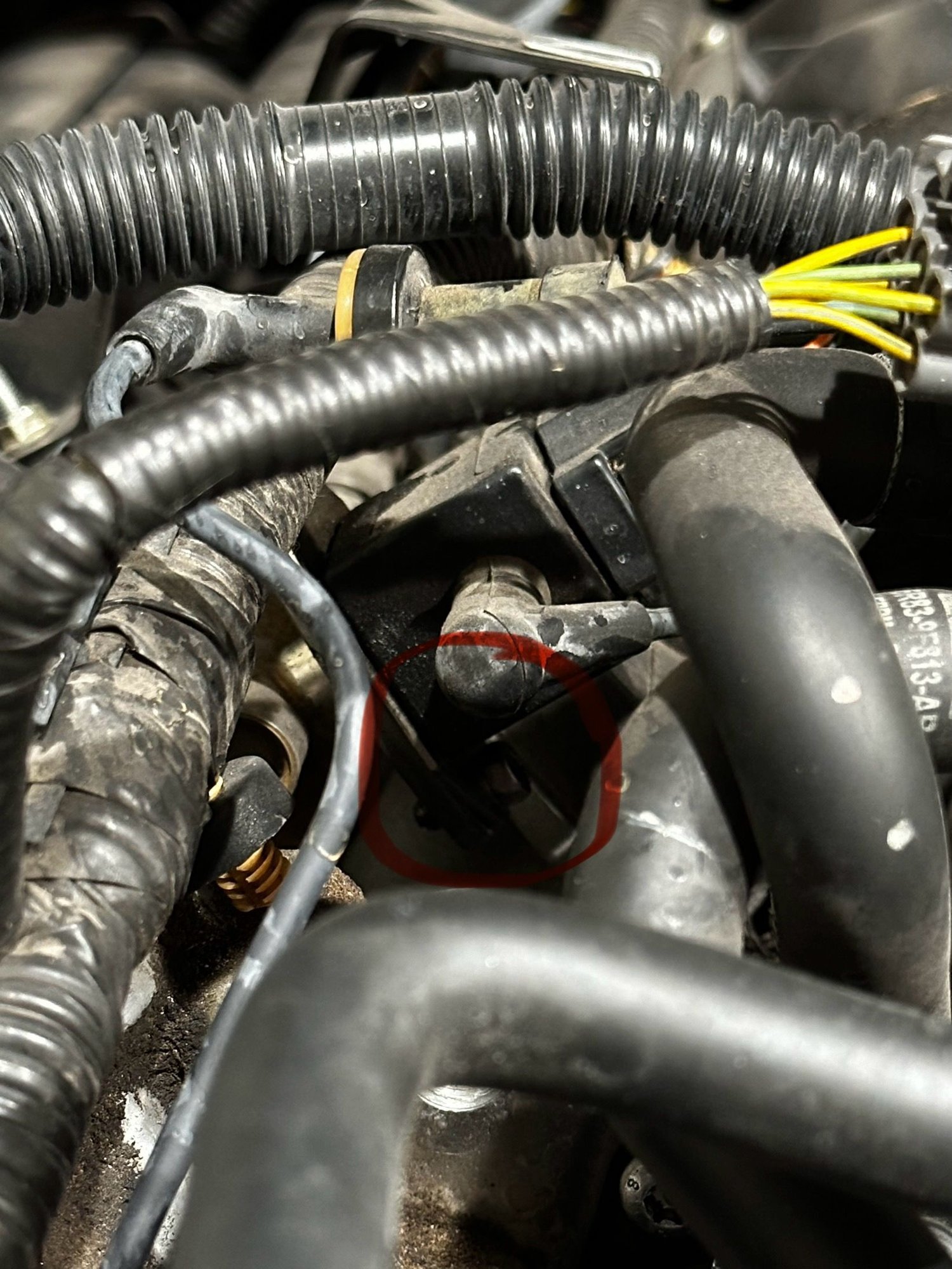

I have a small, but concerning gasoline drip coming from the pictures below. It’s dripping out of the plate at the bottom with the two nuts, directly next to the fuel rail, but not attached. Strong gasoline fumes at idle and in my garage.
Is this an easy DIY fix? Happy to jump in, but just need help identifying where to start.
Thanks!
Doug
2006 XJ8L

What's leaking is your FPR (Fuel Pressure Regulator). Not too uncommon.
Here is my thread with the Jaguar part number.
It's been a few years so I don't know the price or how hard it is to get it? Things might have changed?
Replace FPR

Just a quick word of warning; my FPR died several years ago and I bought a new replacement from a reputable UK supplier. The replacement did not work (perhaps a Chinese knock-off)? Anyhow, I bought a second-hand FoMoCo FPR from the Ebay site I posted previously, and it is still going strong!
I tell you this just in case something similar happens to you. The FPR should produce (roughly) around 400 - 430 kPa at idle, and this new replacement did not? I spent hours testing the wiring all the way back to the ECU, because I could not believe that the new regulator could be what was faulty!
Reply 1
Aug 8, 2024 | 02:03 AM
Replaced the FPR tonight and all is well.
