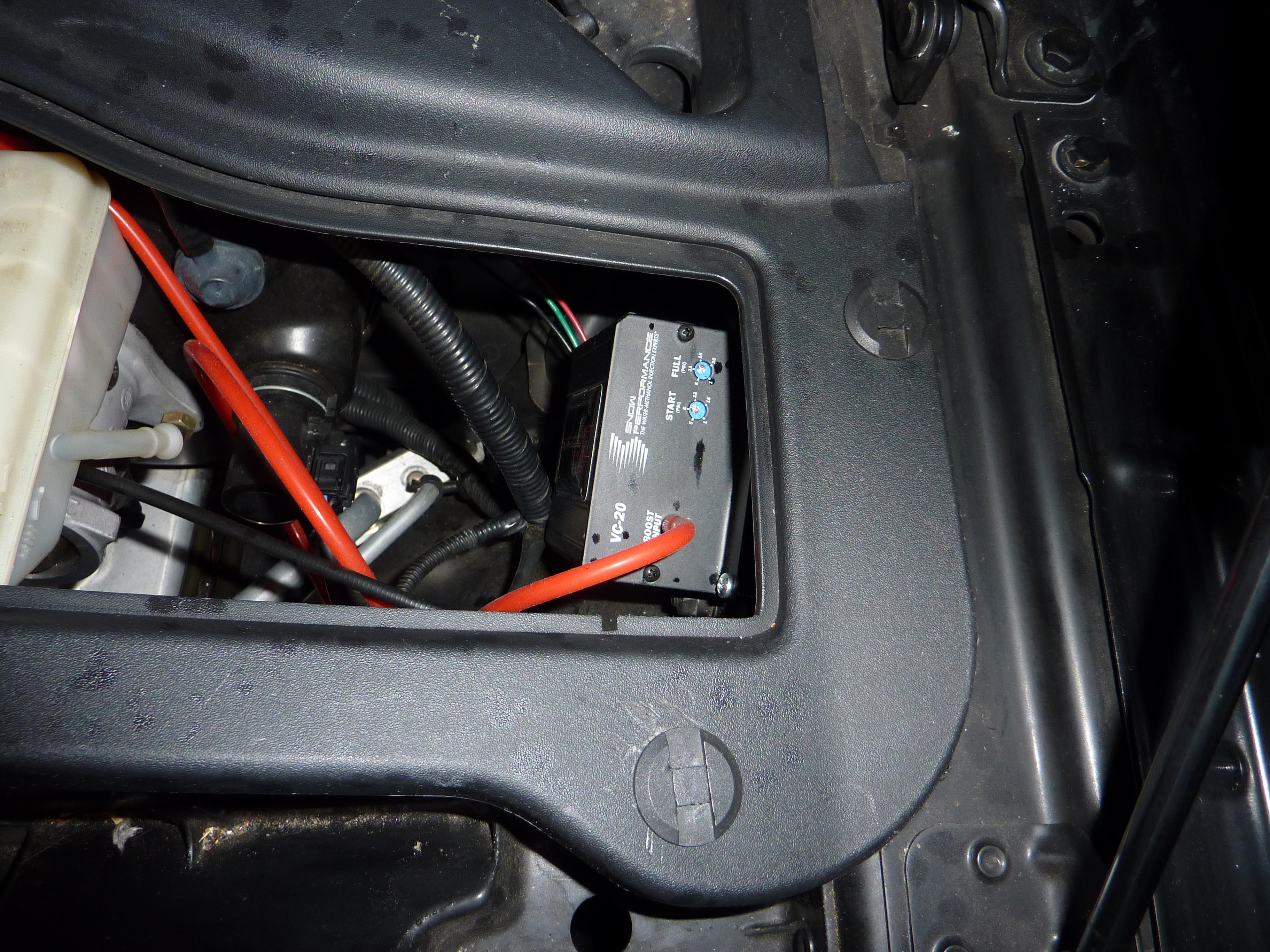

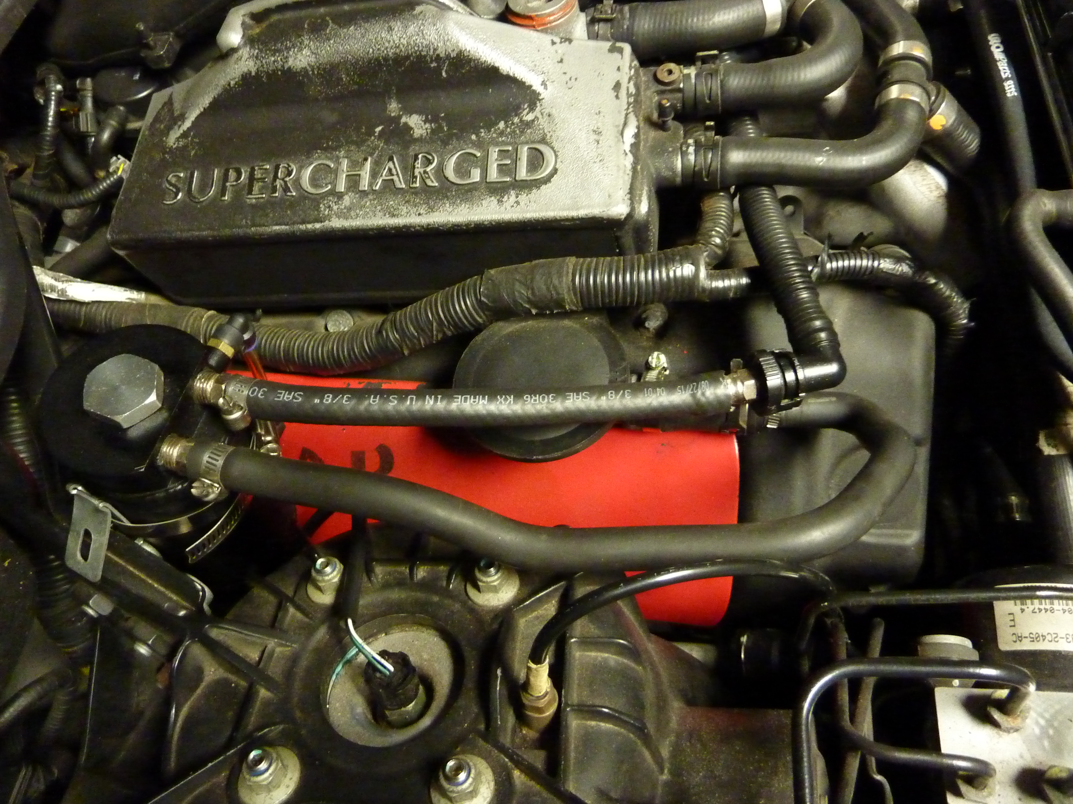

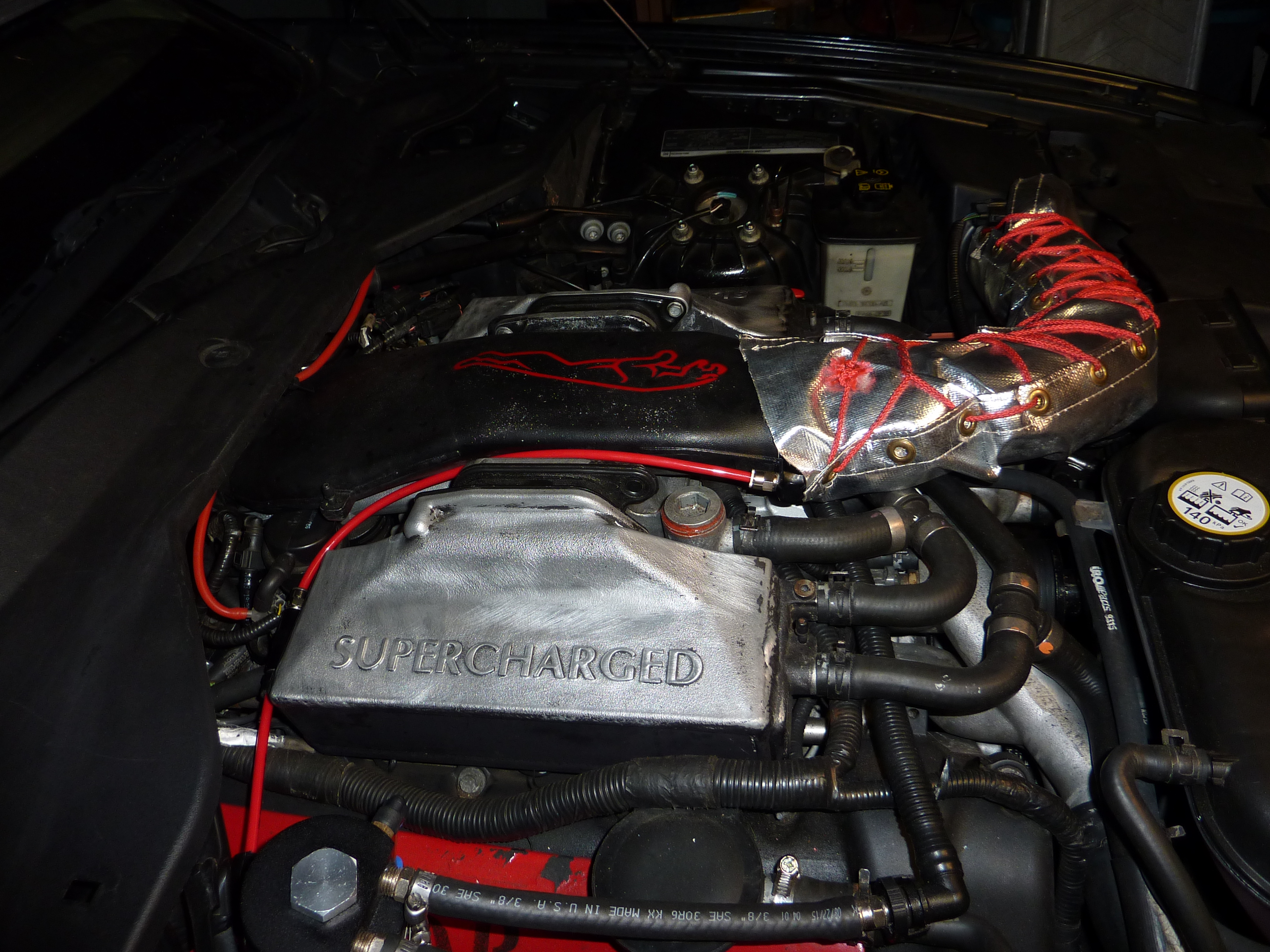

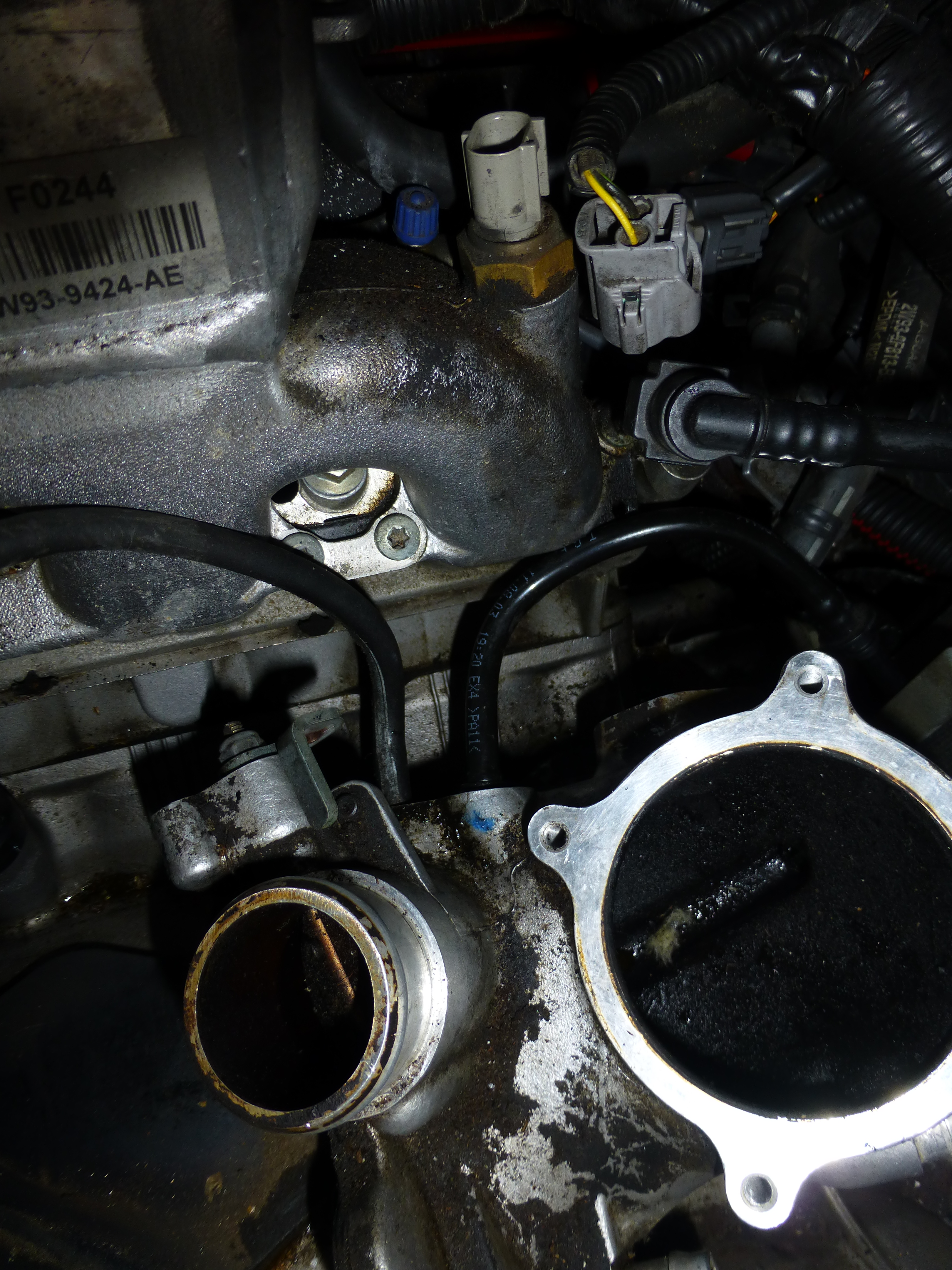

Going to put the heads back in this weekend. Was cleaning up the dirty parts, valve covers, intake manifold etc, noticed there was a lot of oil in the intake manifold. Does this mean I should change the PCV valve or is this normal?
Old Dec 8, 2017 | 06:42 AM
  #50
jackra_1's Avatar
Joined: Aug 2014
Posts: 6,264
Likes: 1,764
Originally Posted by Rickkk
Worn rings in combination with the compression now approaching the original specs. It has to be so since I previously mentioned what occurred afterwards with the 1965 Pontiac Catalina.
You may have "less than efficient" piston rings. That combined with the PCV valve function causes oil products to recycle thru the inlet manifold.
It is argued in this forum that the EGR does NOT actually cause as much of a problem.
This problem is more prevalent with SC cars and that is the reason I have an oil catch can in the high load pcv line and it DOES catch quite a bit of oil.
I have also installed a snow stage 2 meth/water injection system not for performance but to try and keep carbon deposits at bay. That is why I was so interested in seeing what state the carbon build up in your engine was.

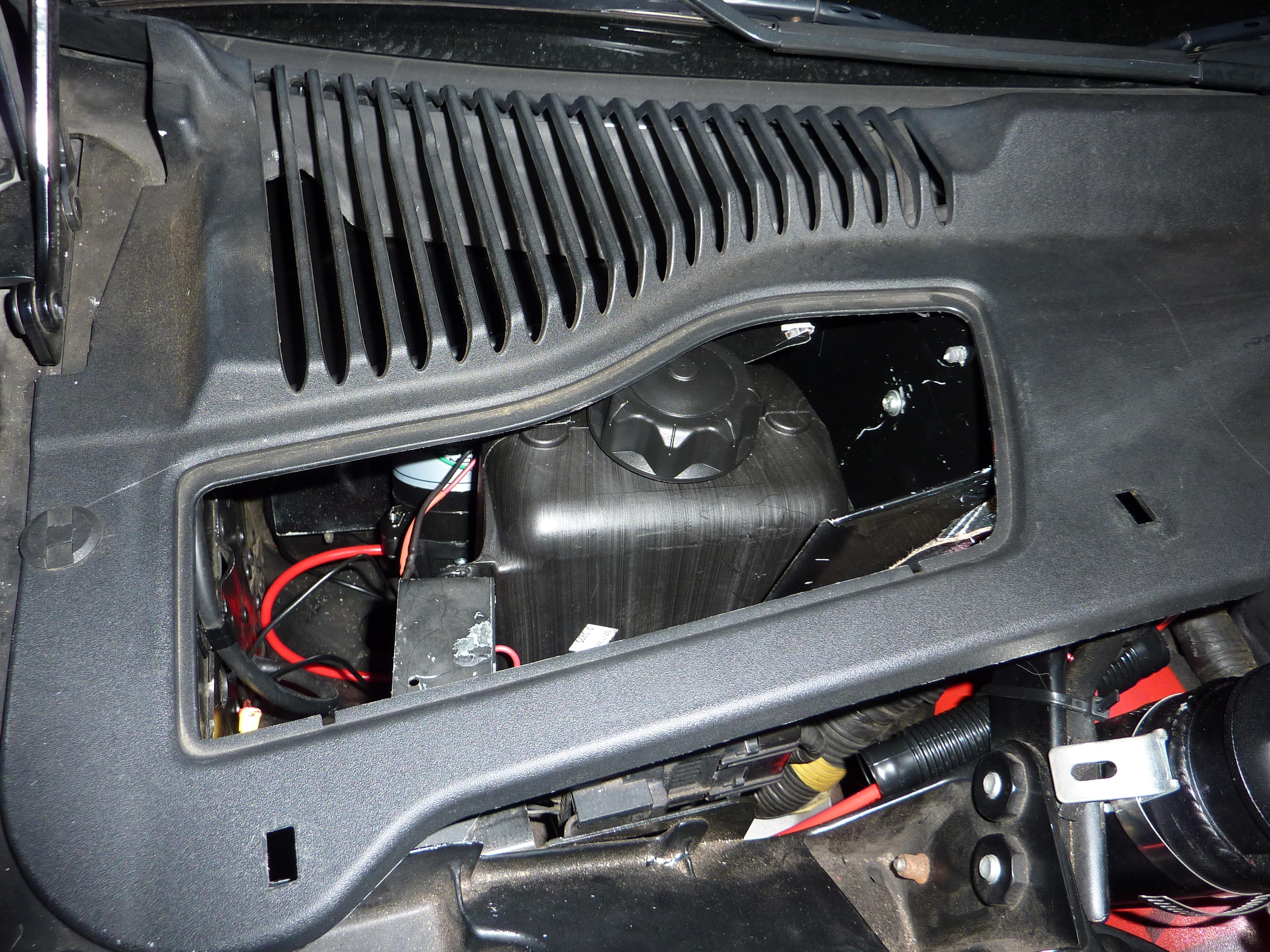

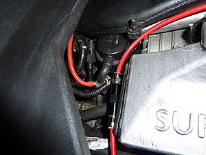

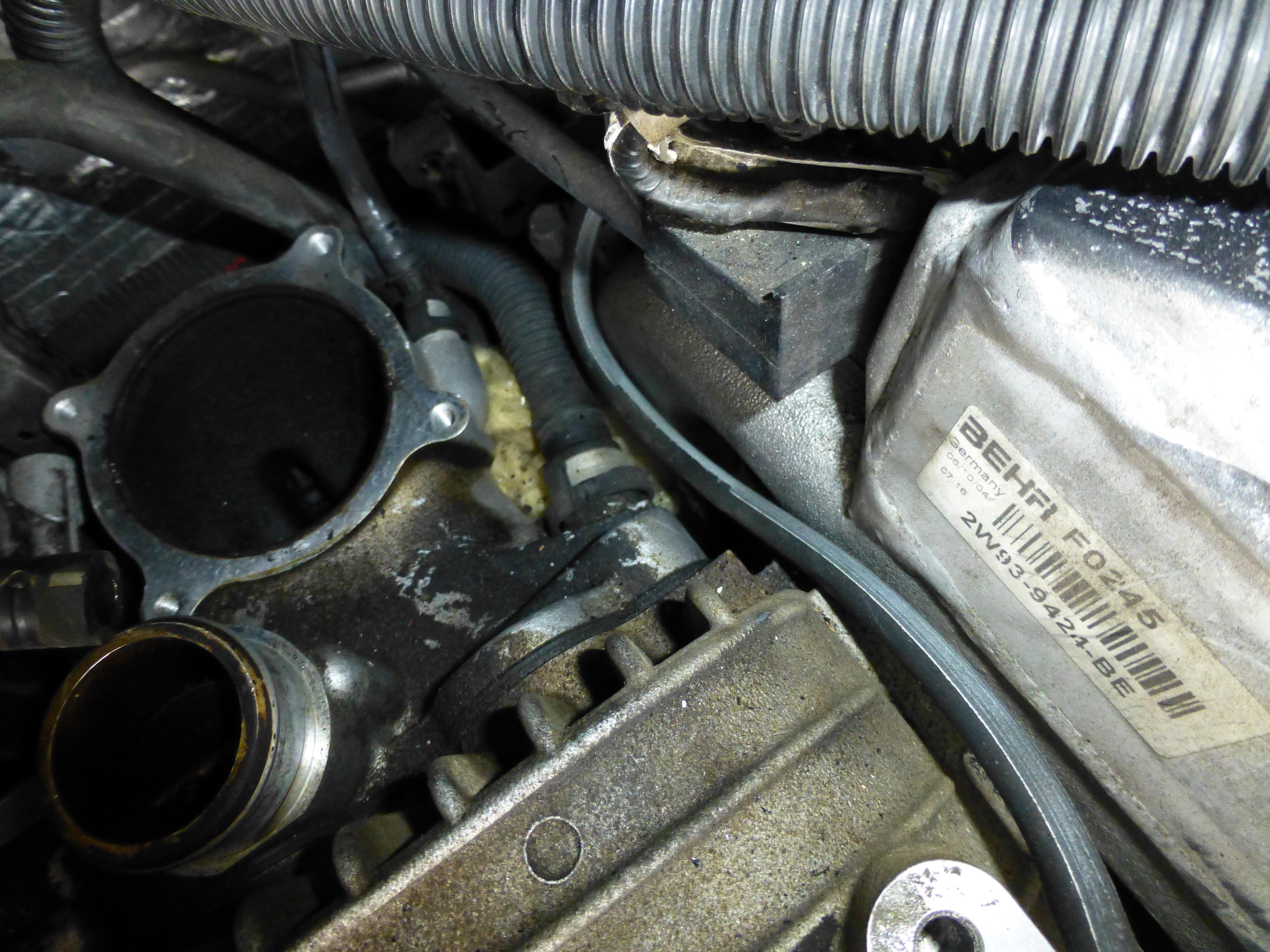

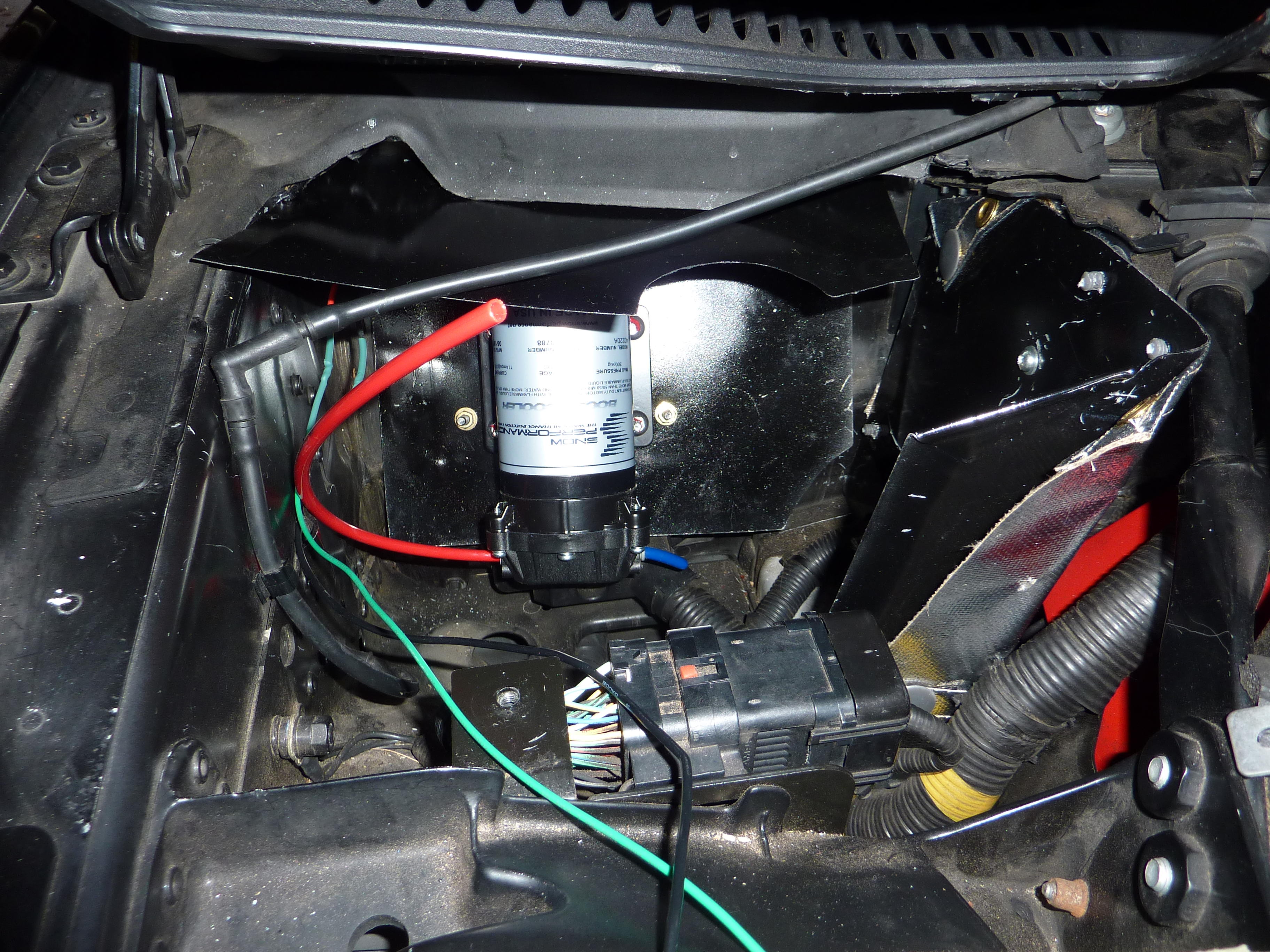

Can you please share some pics of your set ups. Feel free to PM them to me, thanks
Old Dec 10, 2017 | 11:48 AM
  #55
jackra_1's Avatar
Joined: Aug 2014
Posts: 6,264
Likes: 1,764
Here are a few pics. The carbon on the throttle body, as well as in the charge coolers, drove me to make changes. All carbon was cleaned up prior to refitting my rebuilt SC including charge coolers.
Attached Thumbnails Head Gasket job-2016-04-21-11.22.36.jpg   Head Gasket job-p1000033.jpg   Head Gasket job-p1000044.jpg   Head Gasket job-p1000047.jpg   Head Gasket job-p1000049.jpg
Head Gasket job-p1000046.jpg   Head Gasket job-p1000045.jpg   Head Gasket job-2016-04-19-10.43.59.jpg
Old Dec 10, 2017 | 12:29 PM
  #56
soceraz's Avatar
Joined: Jan 2011
Posts: 90
Likes: 23
From: Phoenix, AZ
Looks alot like the inside of my components. Might look into a catch can when I'm done here.
Old Dec 10, 2017 | 01:06 PM
  #57
jackra_1's Avatar
Joined: Aug 2014
Posts: 6,264
Likes: 1,764
The oil catch can I have fitted is baffled which costs more however more effective.
