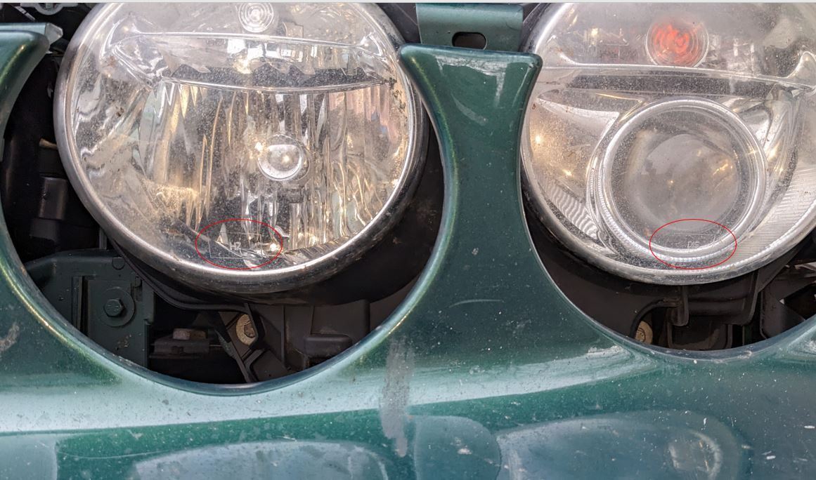

the type of the lamps are printed onto the glas of the respective headlight. D1S for the dipped ones, H7 for the main beams in case you have the xenon assembly

Thanks for your replies. Now I understand. Tom
