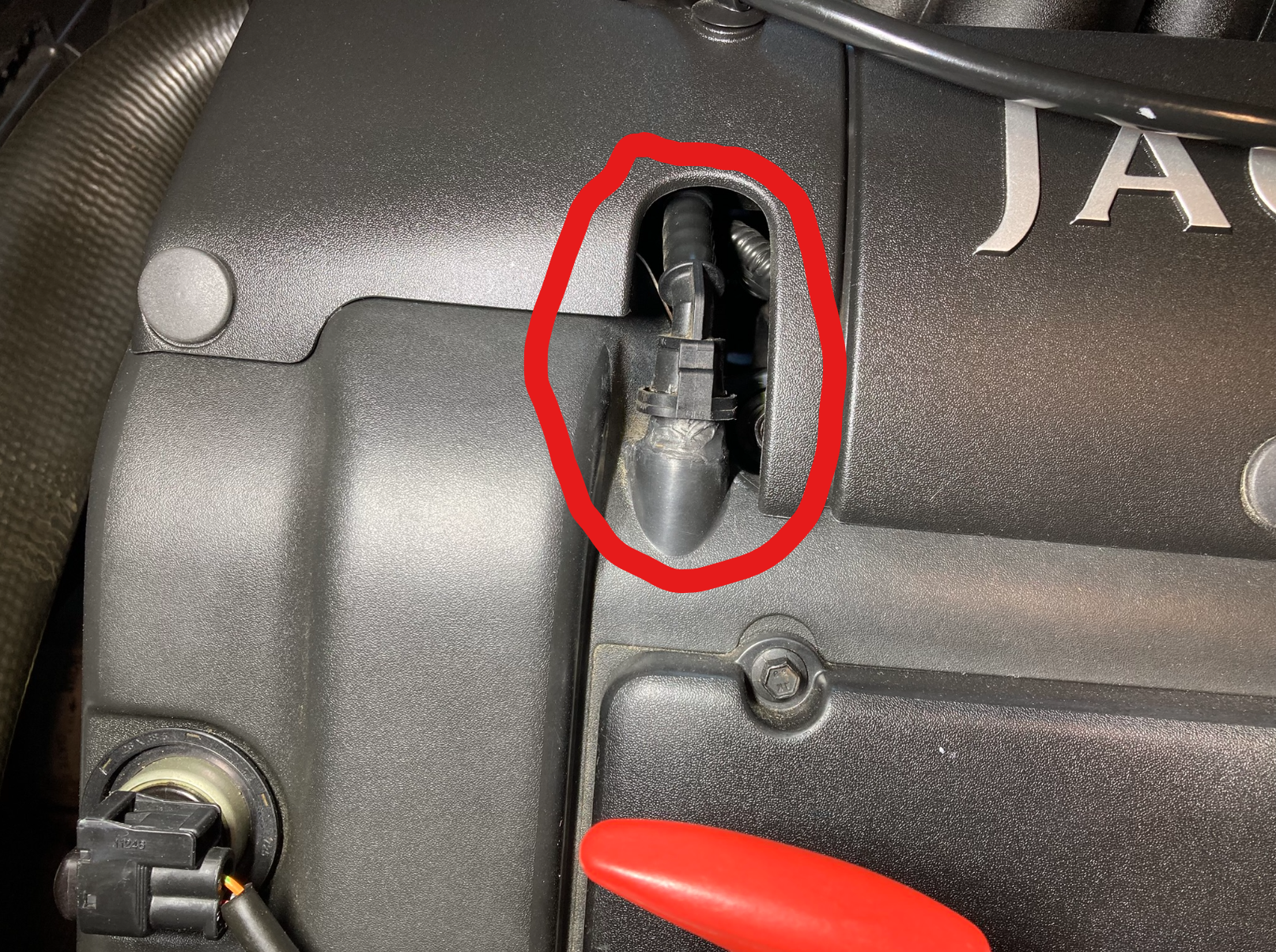

As a followup for anyone who's interested, or having similar problems, I found the "non-PCV" Valve connector to be ever so slightly loose (but still firmly seated in the valve cover). There was some old sealant that I scraped off around the edges. I resealed it with gasket sealant. I have not gotten the restricted performance message since then, or any other messages, and all other items like the O2 sensors, etc., check out to be operating normally according to the scanner. No codes. After a few weeks of occasionally driving it, and going through almost 2 tanks of fuel, I am hesitantly claiming success!
I am really surprised that such a miniscule hairline sealant "crack" could possibly be enough to let in enough extra air to make any difference. Easy fix, ultimately, but it sure was hard to identify.
