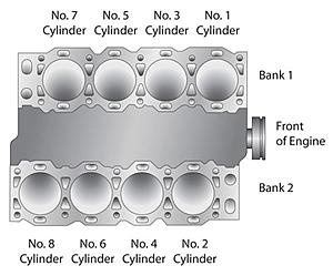

I thought bank two was the other side as per the image attached? Do you have a link to someone replacing this sensor?

AFAIK, the placement of the #1 cylinder defines the #1 bank regardless of what make, model, and etc. Your attached numbering layout is in conflict with this forums DYI Sticky for Jaguars numbering layouts. (Scroll down this attached link for proper numbering / orientation) Accordingly, bank 2 is the left side, regardless of RHD or LHD.

AFAIK, the placement of the #1 cylinder defines the #1 bank regardless of what make, model, and etc. Your attached numbering layout is in conflict with this forums DYI Sticky for Jaguars numbering layouts. (Scroll down this attached link for proper numbering / orientation) According, bank 2 is the left side, regardless of RHD or LHD.
