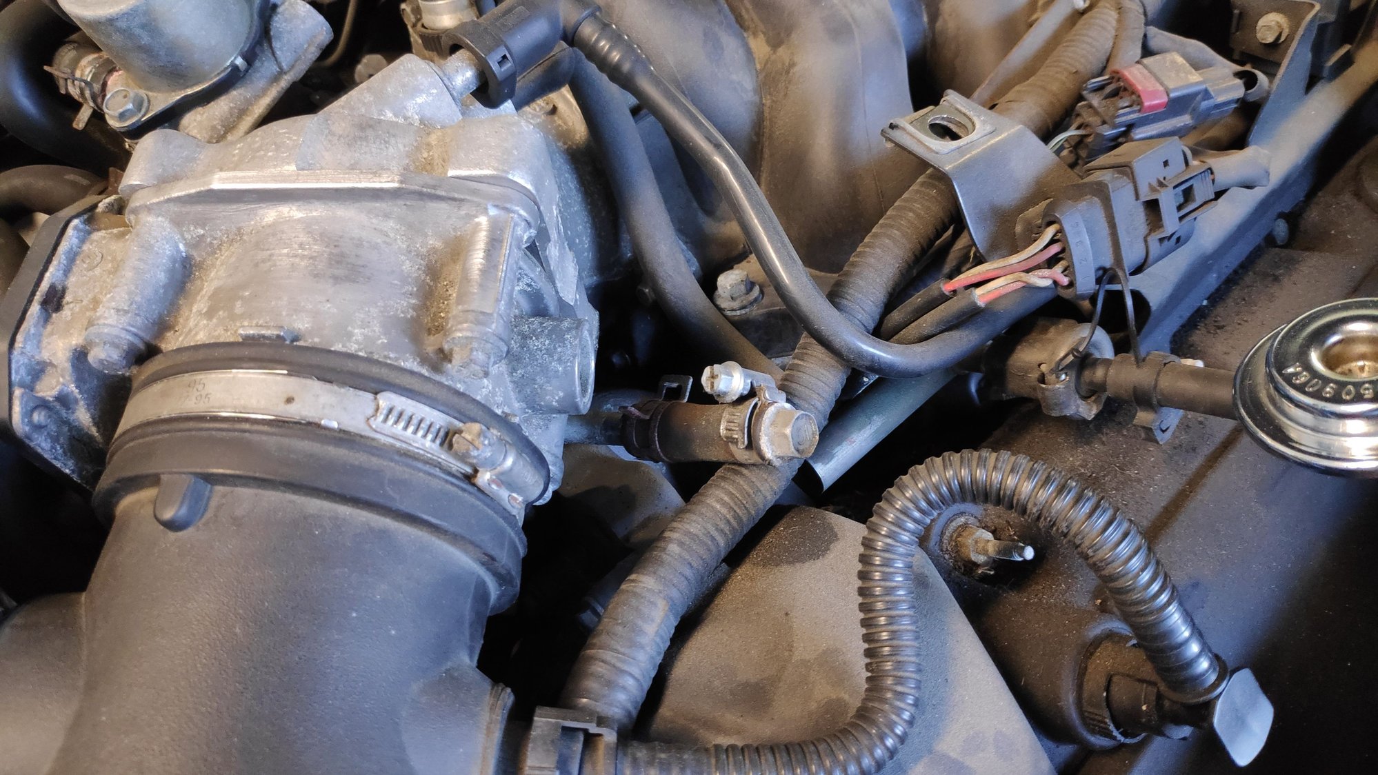

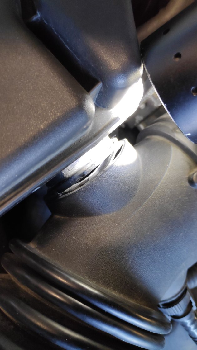

I'm a new member and Jag owner. Still yet to make a formal intro. Was waiting 'til I got some pics as per forum norms. Anyhoo, check this out. I had a CEL for low/high fuel pressure at the rail, P0087, P0088 respectively. So, I went in for a bit of a look around for vacuum leaks or any other obvious anomalies and found this little gem. It's quite-the-aperture indeed! I cleared the fault codes and gave a quick taping up and code hasn't come back. I guess I'll be ordering new bits. Don't suppose anyone knows the code for this part? Is there an EPC available at all?
I also found this coolant hose blanked off if anyone might know what it is.
Any input is most appreciated.

Looks like your air intake tube has a leak.
The ones from an S Type are on both of mine.
Part # XR849560About half of the price.
It looks better without that ugly resonator box stuck onto it.

Nice one sounds good. Is that part number for one without the resonator box?

Yes it is look it up to be sure if you like
