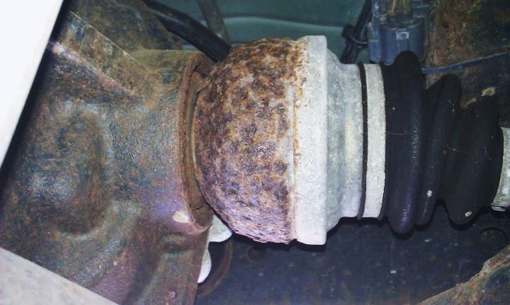

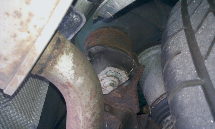

Ok, experienced XJers, what would this repair bill run to put this 05 Super in shape? Headliner, leaky front struts, new leaper installed, new parking brake calipers/shoes, all new belts incl blower.
I know about the rusty guts underneath but any car I get would look this way in a couple years here on the ocean unfortunately.

I live right by the water here in Florida and my car does not look like that. Looks like it has been sitting in water or exposed to salt in the northern states.
Is this yours?
Sounds like routine repairs. $200-500 for headliner, $50 for new leaper from Welsh, belts $100-$900 depending on whether the pulley TSB has been performed, new front air springs from Arnott $800 a set, calipers can be had used cheap & new pads $35

However, now that clarified it is a vehicle you are considering, I would say those pics scare me a lot and if the car has been sitting outside, even worse. There is a good chance water has done some significant damage that could creep up and cost thousands. Unless they are providing a bumper to bumper warranty or the price is so unbeatable you would have something left over to cover future repairs, I would say run away to a better deal.

hmmm....Jeff....the rust you CAN see is worrisome.....but the experience I have made is it is the rust you can't see that cause the real damage. I'd run from this one...but if you thiink it's containable for the discounted price, go for it.

Looking at the pics of the underneath, I see nothing unusual there at all; I've seen cars up on Louis' ramp a lot worse than than and only 3 or 4 years old. Steel parts underneath are never painted very well, and soon rust on the surface, but unless getting regularly soaked in road salt solution tend to last quite a long time even though they may not look very good.
I would go on the internet and price up the parts, then allow for labour to fit. Headliner is a real nuisance, as is need for new park brake calipers. Brake pads are a regular, so nothing unusual there. Belts eventually need replacement on all cars, you're just the guy who has to pick this job up, (assuming you buy the car)
Presumably the inspection report said the front air springs were leaking, yes ? I have found an internet site selling genuine Jaguar air springs but they are around £600 (=$960) each so Arnott probably the best alternative. I do wonder sometimes why the fronts go more than the back, as they both hit the same bumps.

45k on the car, it's the dampers that are leaking as in photos-air springs are ok for now.
Well, it would be unusual for them to be leaking at 45k miles, because the damper is protected by the rubber bellows. Sometimes mechanics can squirt WD40 around when maintaining a car, and that is what you might have here. Anyway, the bottom line is that the shocks are an intrinsic part of the air spring assembly, and not separately replaceable. I have not seen any posts so far on shock leaks, only air spring leaks, but there is always the first time, of course !

OK, now after talking with the wildly overpriced dealer's service rep, he claims the car was NOT painted(indy Jag tech said it was done very well), shox are NOT leaking oil(agreed that the air goes 1st, not the dampers) so maybe it IS WD40 and ran through the service history. they bought the car there and had the 35k and even the 60 k service done, LOTS of replaced stuff under warranty but not the pulley TSB.
DVD player, cruise sensor, all brakes/rotors(NOT the park brake though and he said the calipers were NOT frozen), and some other pieces replaced as well.
