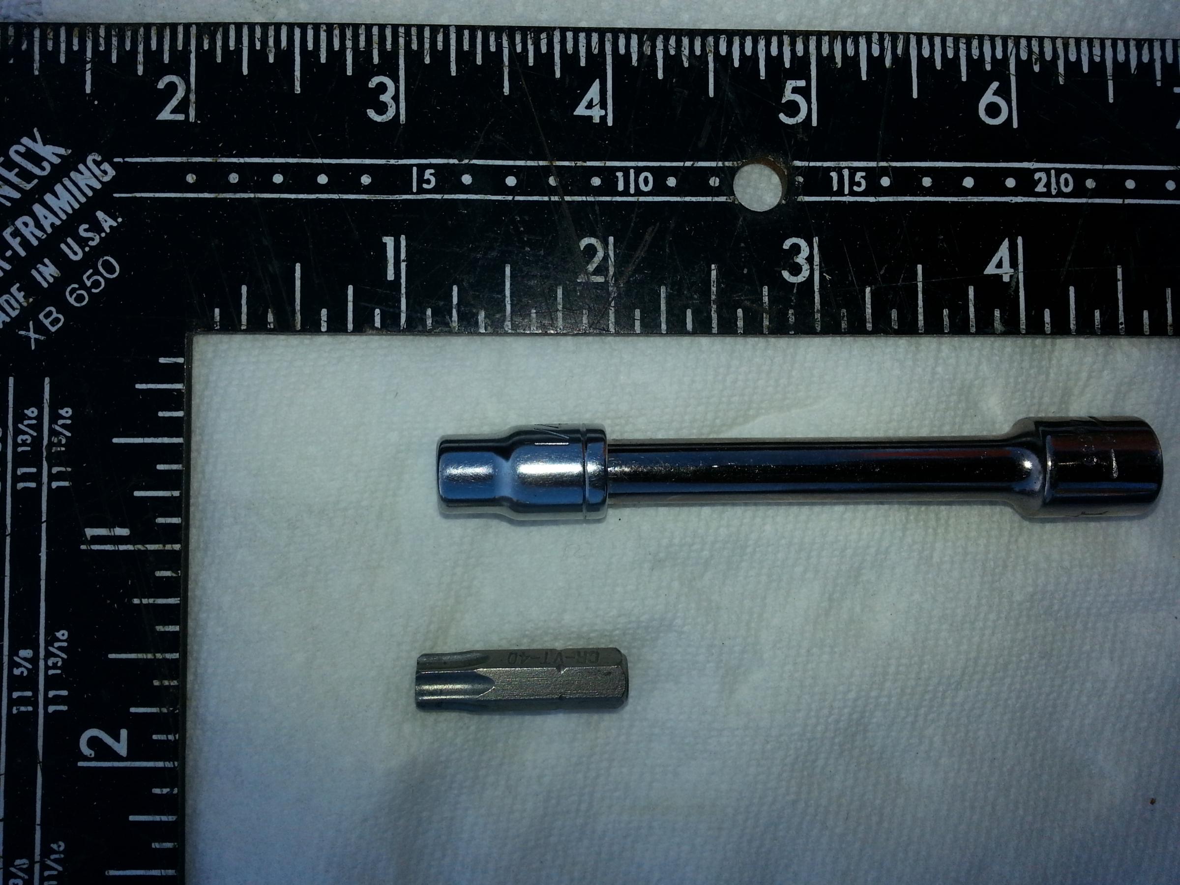

8mm hex stub I cut, as well as the shortest 8mm stub I could find (with 10mm on the other side--it will barely fit but short one works fine)

Next are the main tools for pulling the pan and refilling (I left out the 10mm hex drain plug socket). Note my two 8mm hex stubs. I was able to purchase one that is 8mm on one side and 10mm on the other (that’s the shortest I could find). It barely fit into the plug before I loosened it. I used the two 10mm 12pt wrenches on this plug along with the breaker pipe to break loose the plug. I was then able to turn it out by hand (I had to remove the 8-10mm stub before I could back the plug out). If you can’t turn the plug by hand, you will HAVE to have a shorter 8mm stub and the ratchet wrench pictured (which I didn’t need). The T40 torx bit is also there along with the ¼” socket adapter I used to connect the T40 to my torque wrench.

This is the 8-10mm hex stub with two 10mm 12pt wrenches in the breaker pipe.
This is the 8mm hex stub I cut off a socket with two 8mm 12pt wrenches in the breaker pipe.

This is the T40 Torx bit with a ¼” socket adapter for use with a torque wrench.

I found the perfect tool for removing the fill plug:
9 PC TEKTON Hex Star Key Chrome Vanadium Long Arm Wrench Set w Case T10 T50 | eBay
I believe it's either the T45 or T50 size, but it's the perfect size to fit in that small space. Just slip a cheater pipe or something over the end.

My wrench fit just fine with no modifications necessary. Just a cheater pipe for extra leverage.
I had to shorten mine a bit, and being it is a fairly long set, it extends well below the pan area. A gentle rap from a dead-blow hammer did the rest.
