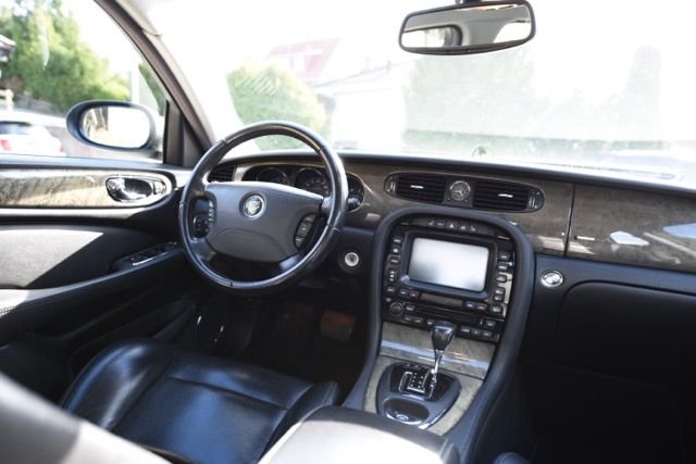

I've now had the car for two days and over all I'm pretty pleased with my purchase.
Of course I probably should have sent the car to a Jaguar specialist to have a look at, but I didn't have that time.
So. I put on brand new Pirelli P-Zeros instead of those dreadful winter tires. The droning turned out to be front right wheel bearing, the Jaguar specialist I usually turn to for parts told me just to replace the faulty one and not both. That set me back around 700 USD.
Changing tires showed that the wheel badges were broken and glued on. A set of new badges was around 30 USD so no biggie.
Next I'll investigate the squeaking from the rear.
