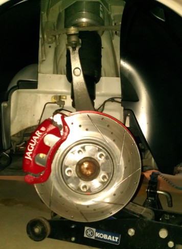

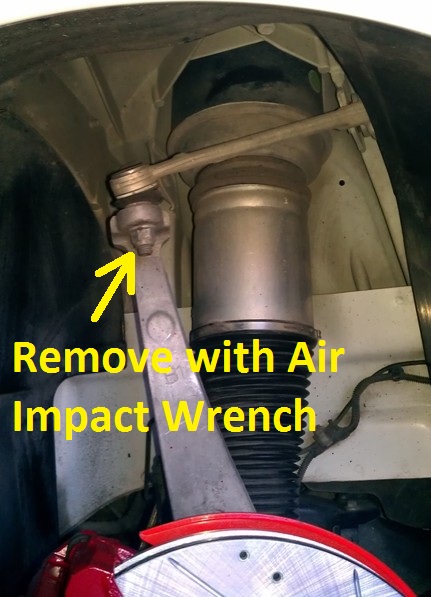

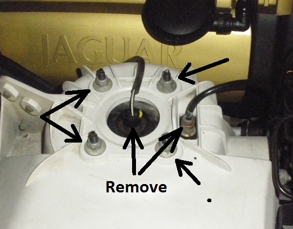

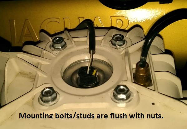

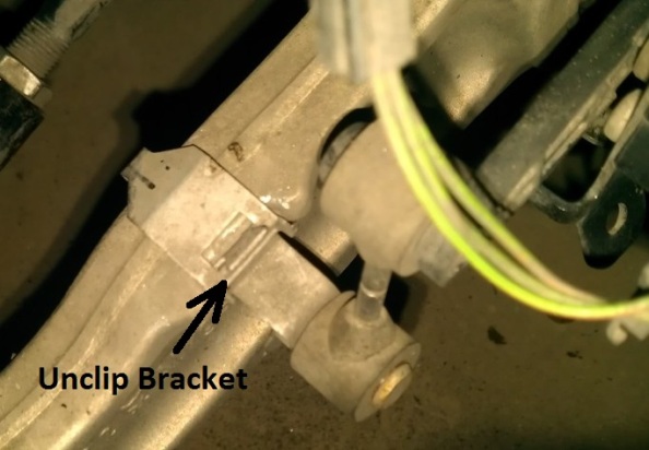

Took the VDP out for a test drive
No issues with the height sensor, compressor, shock, or air-line.
(None that I noticed)
Follow Arnott's Instructions!
I used 2 hyd floor jacks and 2 jack stands for safety. Also keep in mind that when you are lifting at the jack points, the whole side will lift-not just that corner (Safety).
