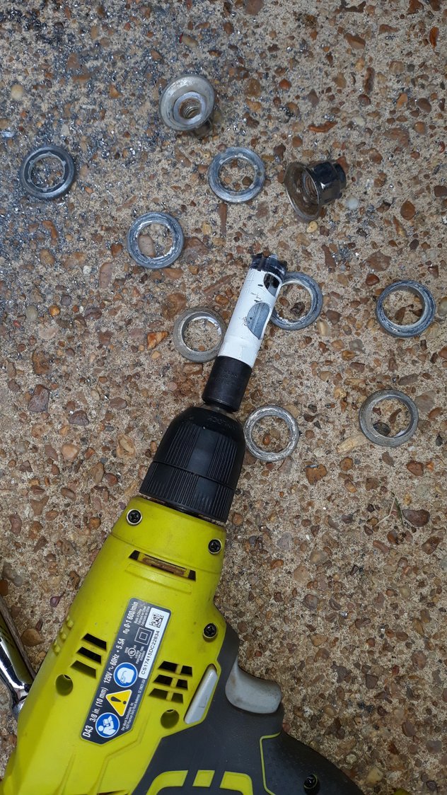

Took the Jag in for an alignment, the next day I decided to replace the front rotors, and to my surprise the Lug nuts were to tight! While trying to remove them, I snapped off 4 of the 5 nuts from the drivers side wheel..WTF!! While I was pissed, that the shop used an impact wrench to tighten the nuts, I didn't panic. I searched through my tool box and found my 3/4 hole saw,and drilled them out. Good thing I had some extra lug nuts.

Wheels don't come off for alignment. Those lug nuts have probably been rusting on there for quite some time. It's a common problem with these cars.

Rusted on was my first thought looking at the picture. One of our SUV’s had the wheels rusted to the hubs from running through water on the beach. Had to thump with a sledge to get the wheels broken loose.
The studs are soft steel. If the lugs are really hammered down with an impact they will start spinning and strip the stud. This has happened to me three times are Discount Tire. All on the XJR. Never on another one of our cars.

Discount got me for the last time a month ago. Brought XJR in for one of the free lifetime balance and rotation. About two weeks later went to flush brake system. Saw a lug sticking out about an inch further than the other four on a rear wheel. Went to tighten and it spun freely. Also slide in and out about an inch.
The lug was cross threaded and when the monkey tried to drive down with impact it spun the stud. They pushed it in and left it like that. After pulling the other lugs, was finally able get the stud in a bind enough to back off the lug. Spent a couple days. Had to borrow an impact and set weigh on the cocked wheel. Tried cutting, could never get to the stud. A friend recommended to cut off the lug, but it just spun. I have replaced a front and rear stud already. Put a pair of Detroit Axle hubs on the front. Beveled the stud to get the normal Dorman in the rear. Ford uses Dorman studs. Some does Jaguar.
