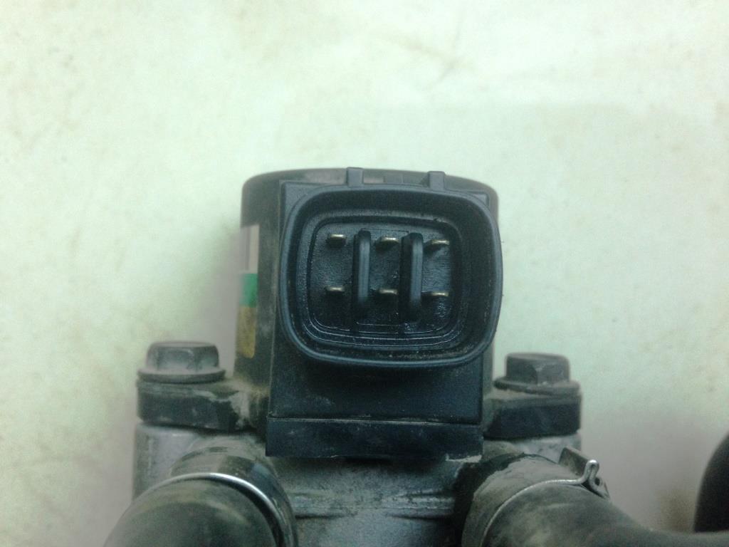

Please could you repeat the process above to show me which pin is the earth, which the 12-Volt supply and which is the 5 volt 'signal' on my EGR Valve connector. I have a Code P0405. I have inspected my EGR Valve and it is clean and unblocked, so either the solenoid has failed, or a supply, ground or signal voltage is failing. I think!

The EGR has 6 pins, the two Green/Blue supply 12v switched. The other 4 pins are coils that are PWM switched low by the PCM to control the pintle position.

So, Thank you very much Mr Hamilton, our old friend the PWM - pulse width modulation (a way of controlling electrical output)!
So ignition on and the multi-meter's black probe on one of the E's and the red on 1, or 2, or 3, or 4?
Or completely wrong?

With the ignition on you should have 12v at the two Blue/Green wires at the harness plug.
To check the valve, I would unplug the EGR and put the ohmmeter from pins 2 to 4 and 2-6, and from pins 5-1 and 5-3 on the EGR itself. All should show the same resistance (coil check). Start there and see what you get. Any that are obviously open or way different resistance than the others will indicate it's time for a new valve.
