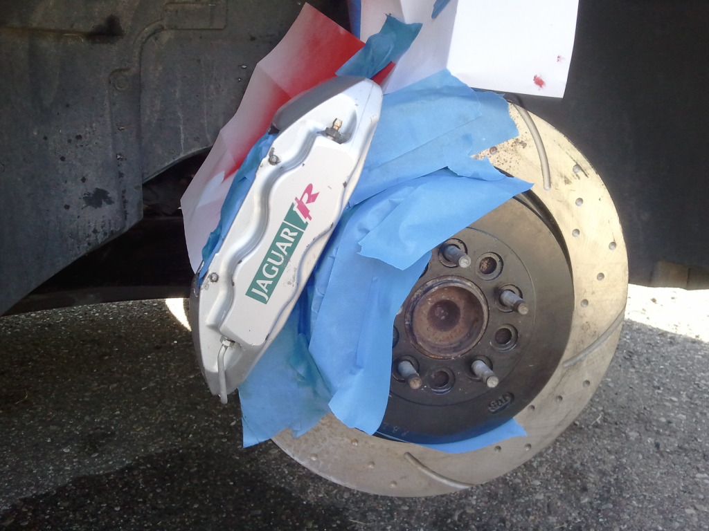

If your caliper look like this...
Then
Front EBC redstuff #DP31462C
Rear EBC redstuff #DP31140C
Attached Thumbnails Much Ado About Brake Pads!-2013-06-14181044_zpsb22b0f56.jpg
Old Aug 4, 2013 | 07:37 AM
ryejag's Avatar
Posts: 408
Likes: 50
From: New Hamphire
My 2004 XJR looks just like Casper's caliper, but I have what I believe to be the original front discs. They are not drilled or slotted, but simply ventilated. Per the prior owners service records they have been turned one time at 55K. I would also look at Rock Auto for pad and rotor replacements. The caliper pistons should retract to the point that they are flat with the caliper, if they will not, the caliper may need rebuilding. Sometimes it takes a fair amount of force to fully retract calipers. Rock Auto offers rebuilding service with your original caliper for Brembo brakes.
