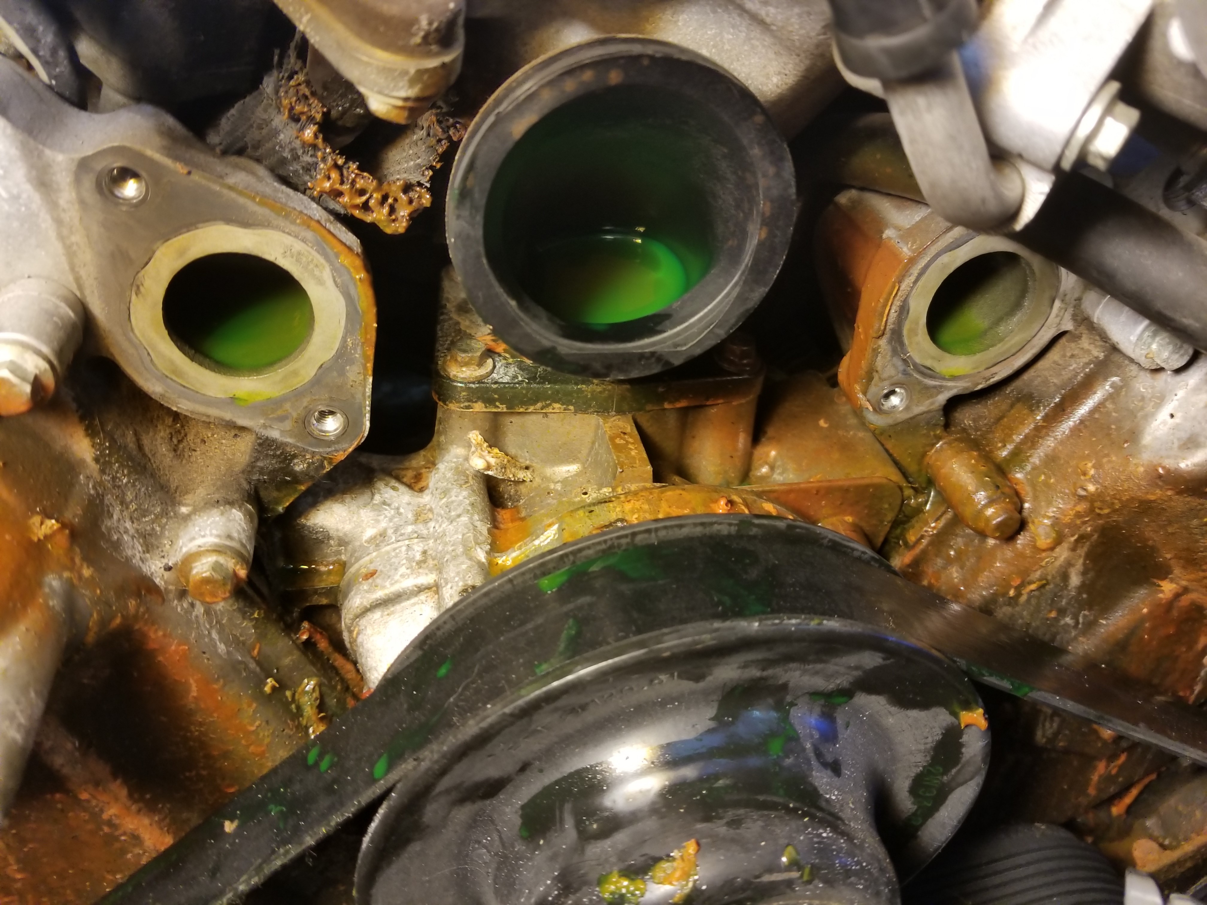

Hey
Need help please!
I've had a slow leak for a long time that began to go faster. I just pulled off the thermostat housing, and all gunk aside, the plastic and hoses seemed pretty fresh. O-rings seemed intact. I put in dye to trace the leak, and now have a big mess and lots of dried up coolant to wade through. See pic for the big yellow stain I now have.
So far nothing I've pulled off looks capable of leaking, O-rings still soft, etc. I hope I have another option, but I think my only option is to clean it up, re-assemble, drive it for an hour, then pull it all apart again and try and see what is leaking?? Any other ideas on finding a leak without all that labor?
Thanks.

Originally Posted by TucsonDave
Hey
Need help please!
Thanks.
Problem #1: your using the wrong coolant. Plan on flushing out the entire cooling system and fill with Dexcool.

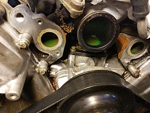

Old May 13, 2018 | 04:22 PM
TucsonDave's Avatar
Joined: Mar 2017
Posts: 101
Likes: 35
From: Tucson, AZ
Guess I'll have to re-assemble and try again....

Old May 13, 2018 | 04:38 PM
Wingrider's Avatar
Joined: Sep 2016
Posts: 3,483
Likes: 879
From: Stow Ohio
The plastic housing, should have been made of metal. As it is, the whole thing needs to be replaced, making it a lot more work than necessary. Unless yours has been done, keep at it, you have four more bolts to pull out, b4 reassembling.

Old May 13, 2018 | 04:48 PM
exiledbrit's Avatar
Joined: May 2018
Posts: 107
Likes: 18
From: Weeki Wachee Florida
Honestly, I would replace any hoses that are easy to get to and also the expansion tank before refilling. Replacing hoses are always a good investment. If it still leaks, at least you will know where it isn't coming from. I swear the expansion tanks were made of recycled paper back in the day. Almost every Jag, Merc, BMW and water cooled Porsche I know of eventually has to have it replaced. Good luck

Old May 13, 2018 | 05:25 PM
TucsonDave's Avatar
Joined: Mar 2017
Posts: 101
Likes: 35
From: Tucson, AZ
Thanks for the help!!!
Put it back together, and saw some seepage out of the thermo housing - guess that O-ring wasn't as soft as I thought.
However, EVERY time I pull off my air filter box, I manage to break off a tab. Do you guys have the same problem? Seems like a lot of work to get that cover off and on .....
Thanks for the suggestions - I'll replace the therm and hoses and see what happens - probably time anyway.
