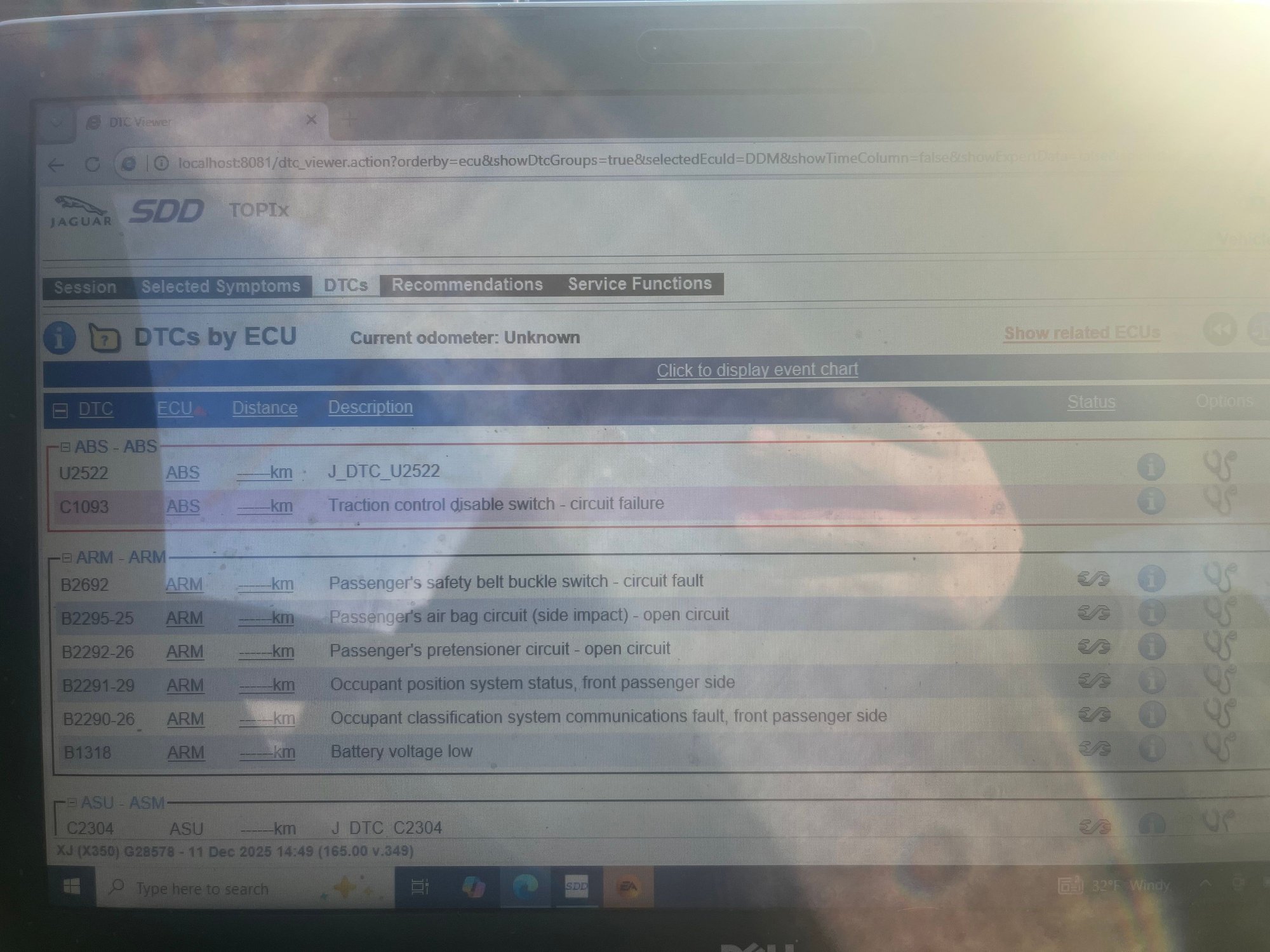

I have lost complete communication too everything on the SCP network my driver door module is the main concern as this is needed too code keys too the vehicle and I only discovered this issue after attempting too code two new keys and it cleared the old ones now my car is bricked and won’t start.
before this the car started fine everything worked as it should all windows operated all door locks even the button too pop the trunk on the dash that operates via the SCP network even that still works. But when I plug in my laptop and use JLR SSD/SDD I get no communication too the entire SCP network
I also have this code for no communication from the ecm too the Tcm prior too attempt key programming vehicle drove and shifted fine with no issues including manual shifting.

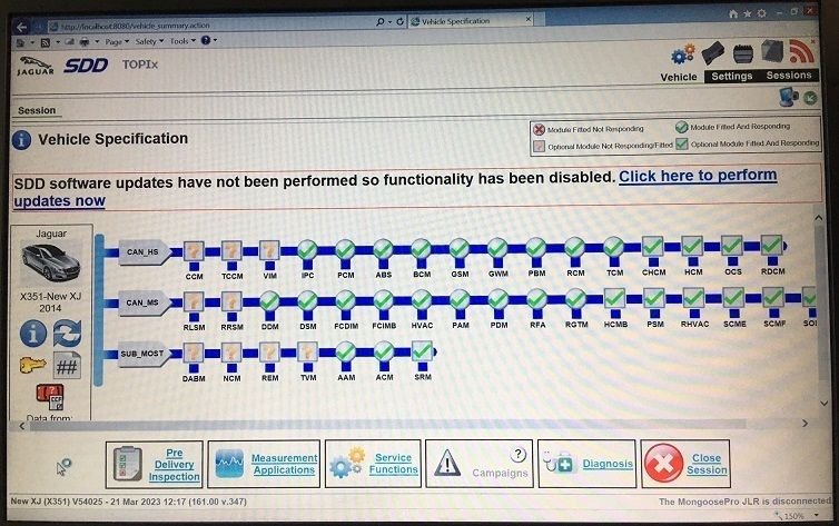

Can you post what SDD see's for modules?
Something like this screen?
Do you have any red X's?

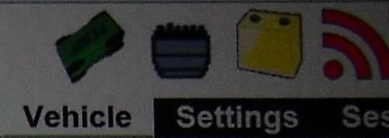

The power supply to the battery is critical! Especially when doing keys!
Do you have a proper DC power supply and NOT a battery charger on the car?
What is the ripple and amperage rating along with the voltage output? SDD wants 13.4 VDC from the power supply.
Also post what this shows in SDD.
Notice the yellow battery symbol. This needs to be green. If the cars voltage drops to 12.5 VDC SDD will stop all programming.

There is no way that I had low voltage the battery is brand new as verified by the locksmith that came out and I also had a charger plugged directly into the battery set at 25amps my JLR SSD was showing the battery status as green I have no issues with this vehicle battery wise the car can be left unhooked weeks even months at a time and it will always crank up too life
Old Dec 15, 2025 | 01:15 PM
BrokenXJ8's Avatar
Joined: Nov 2025
Posts: 50
Likes: 5
Yes it was yellow at that point due too continued tests I assure you my scp network is down and has nothing too do with battery voltages infact when I took that picture my laptop wasn’t even hooked up into the car
