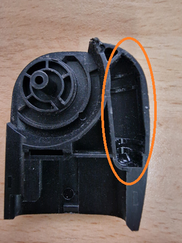

Hi again to all, but especially JoeDredd! By the words of the immortal Sherlock Holmes... remove what cannot be, and what remains must be the truth!!!
My son told me that he needed his car off the drive, and was a tad worried he might catch the Jaguar. Knowing that such a mistake would be his last, he decided to push the Jag a few yards out of the way. He PUT THE KEY IN THE IGNITION to remove the steering lock, and pushed the car. However, he decided to reverse it back, and (in his words) when starting the car the key "just fell to bits in my hand". He put the key back together and said nothing as he thought 'no harm done'...
So, following some rather loud Anglo Saxon expletives, I took the plunge and popped open the key, and sure enough, the Transducer was not present inside the key, the bit that looks like a torpedo is the bit missing.. JoeDredd.. you were spot on with your analysis..
This is where it goes...
I have ordered a new Key shell plus the Transducer and circuit board, got it from that place that has the same name as the famous River and Tropical Rainforest!.. £15.99
When it arrives, I am confident I can fix it all together, but I have a nagging feeling it will need to be programmed to the car. I only have the one key, and my trusty diagnostic device to do it. Unless, someone knows a more manual way of programming a key?
Gone into quite a bit of detail with what I've found, I'm hoping that it may help someone else one day!

Hi luv2fly, thanks for your input. I have scoured the site around the car but nothing, however, one of the UK's many thunderstorms may have taken its toll on the idea?
Today, the new key shell and transponder arrived, I have a diagnostic tool that can program keys, though I am unsure if that means the buttons, the actual Transponder, or both? I think the facility on the diagnostic device says the 'immo' function or similar. I have swapped the actual key part for the blank one that came, I will attempt to program it, and see what happens. I will let you all know how it goes
