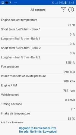

His car is stuck in Open Loop. Please see pic 1
He also has DTC's P1108 (MAP Sensor Circuit High Voltage) & P1646 (ECM Ho2 Sensor Control Malfunction - Bank 1 Upstream).
Below (pic 2) He seems (to me) to have excessively high Intake Manifold Absolute Pressure? (I may be wrong)??
Please, could someone point us in the right direction?

With those codes you may not be able to rely on some OBD readings.
Look to see whether there's anything in common to the circuits or start by fixing the O2 sensor causing P1646 and see if the other code continues or not.

Not sure I believe some of those readings.
The vehicle is not supercharged is it?
Seems MAP sensor only on SC cars?
Result is about 28 psia which is high.
Suggest that you run the scanner on your own vehicle to compare readings.

No, normally aspirated V6. Reader is not showing MAP Sensor, is showing the Intake Manifold Absolute Pressure? Mine is around 50 kPa; his 200 kPa?
