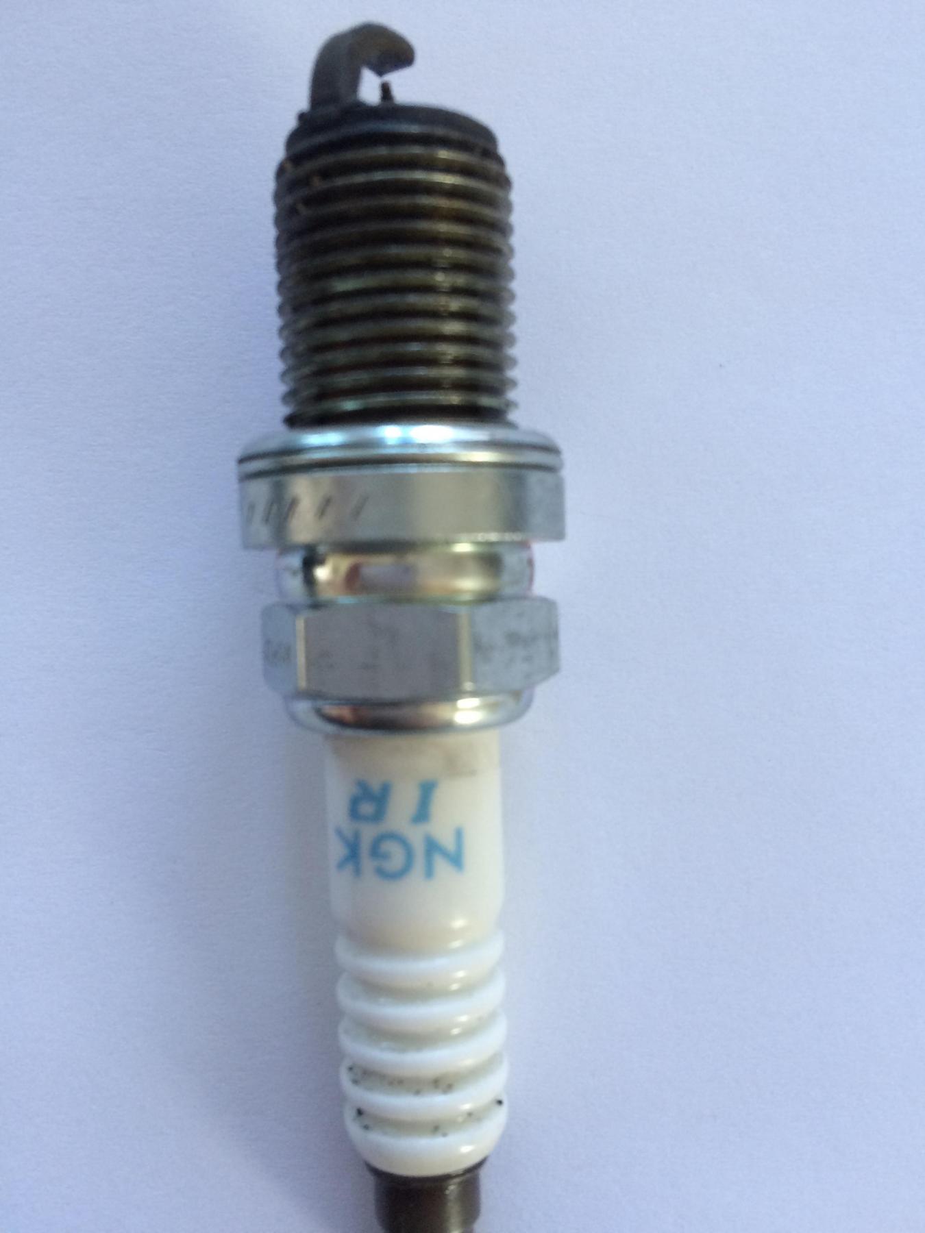

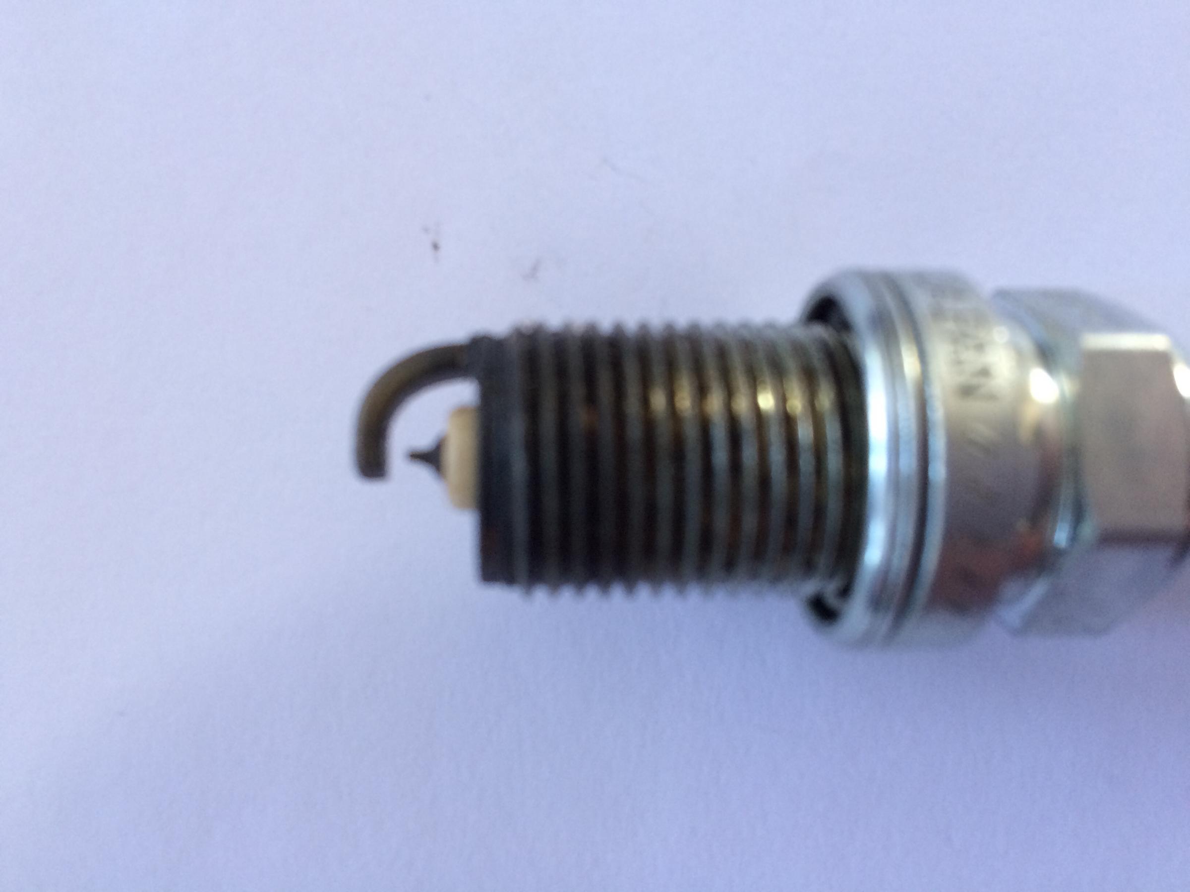

So I went ahead and replaced the ignition coil on cylinder 7, and decided to change the plug as well. Afterward, the car is running smooth again, no rough idle, no hesitation, and no restricted performance light anymore. Because of the tight squeeze and where that cylinder is located, I couldn't really see into the well to see if any oil had accumulated in there. I did put a clean rag down in there and it came out clean. I guess I'm just perplexed as to why a plug or coil would fail after only 5000 miles? Attached are pictures of the plug I removed. Does anyone see anything of interest on it?
Thanks once again for the help JagV8
