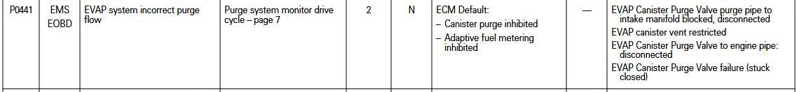

Here are the definition and possible causes from the DTC Summaries guide:
You can download the full DTC Summaries at this link:
Jaguar X350 DTC Summaries 2003.5
Curiously, P0441 does not appear in the 2004 DTC Summaries:
Jaguar X350 DTC Summaries 2004
Jaguar X350 DTC Summaries Full 2004
Cheers,
Don
