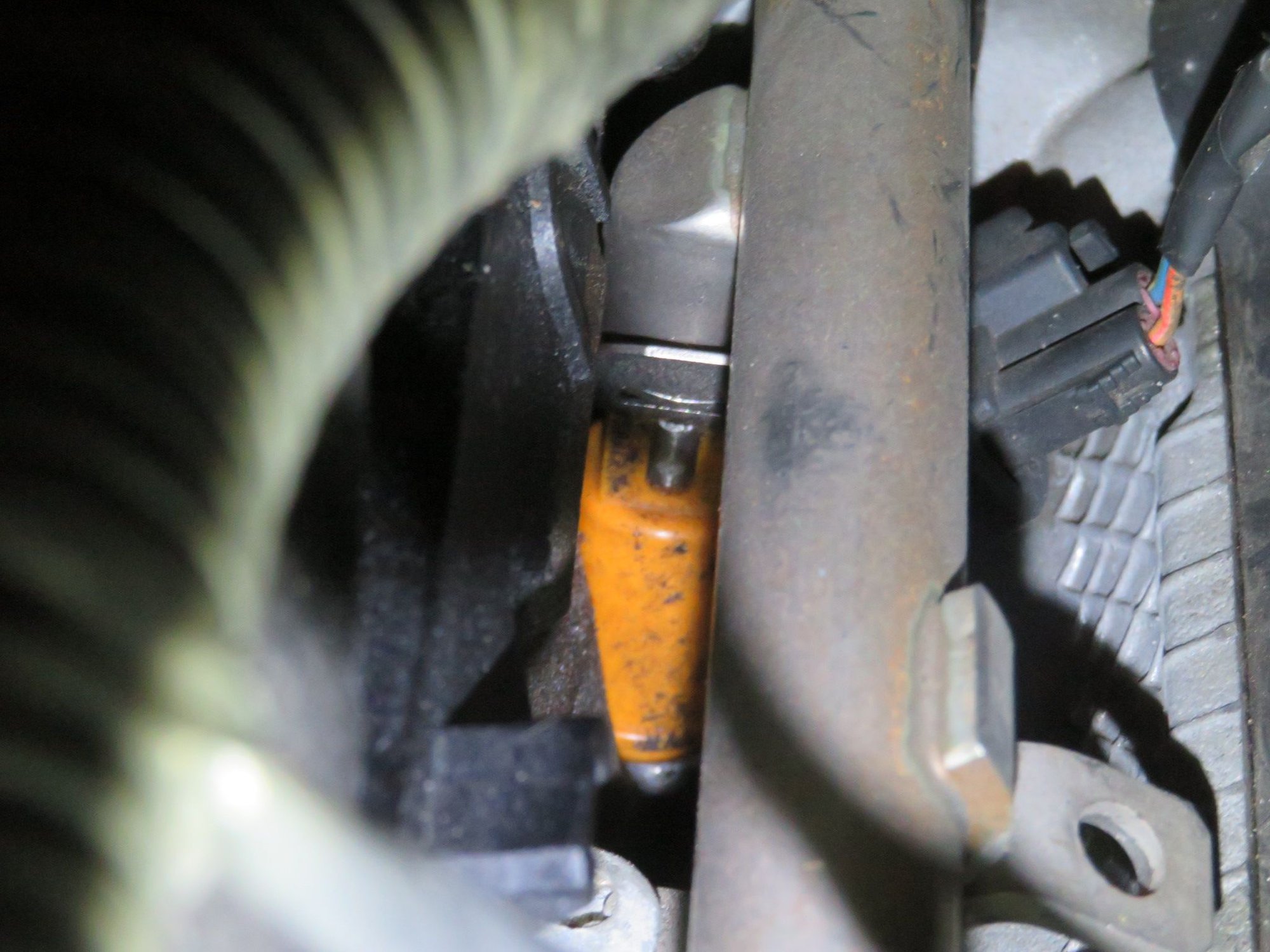

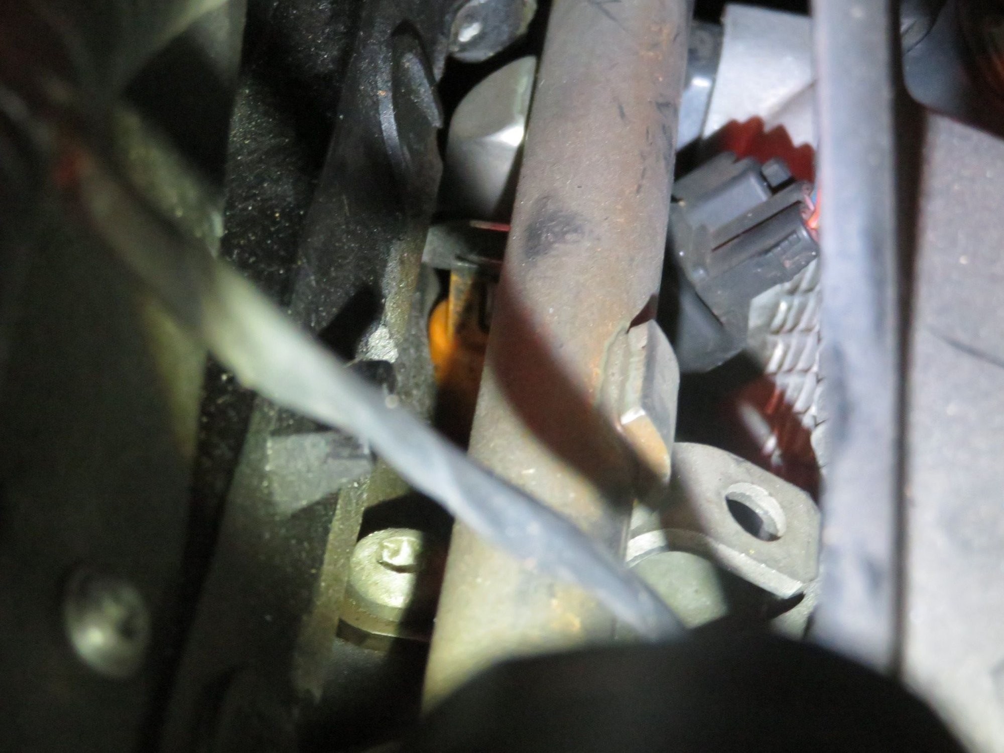

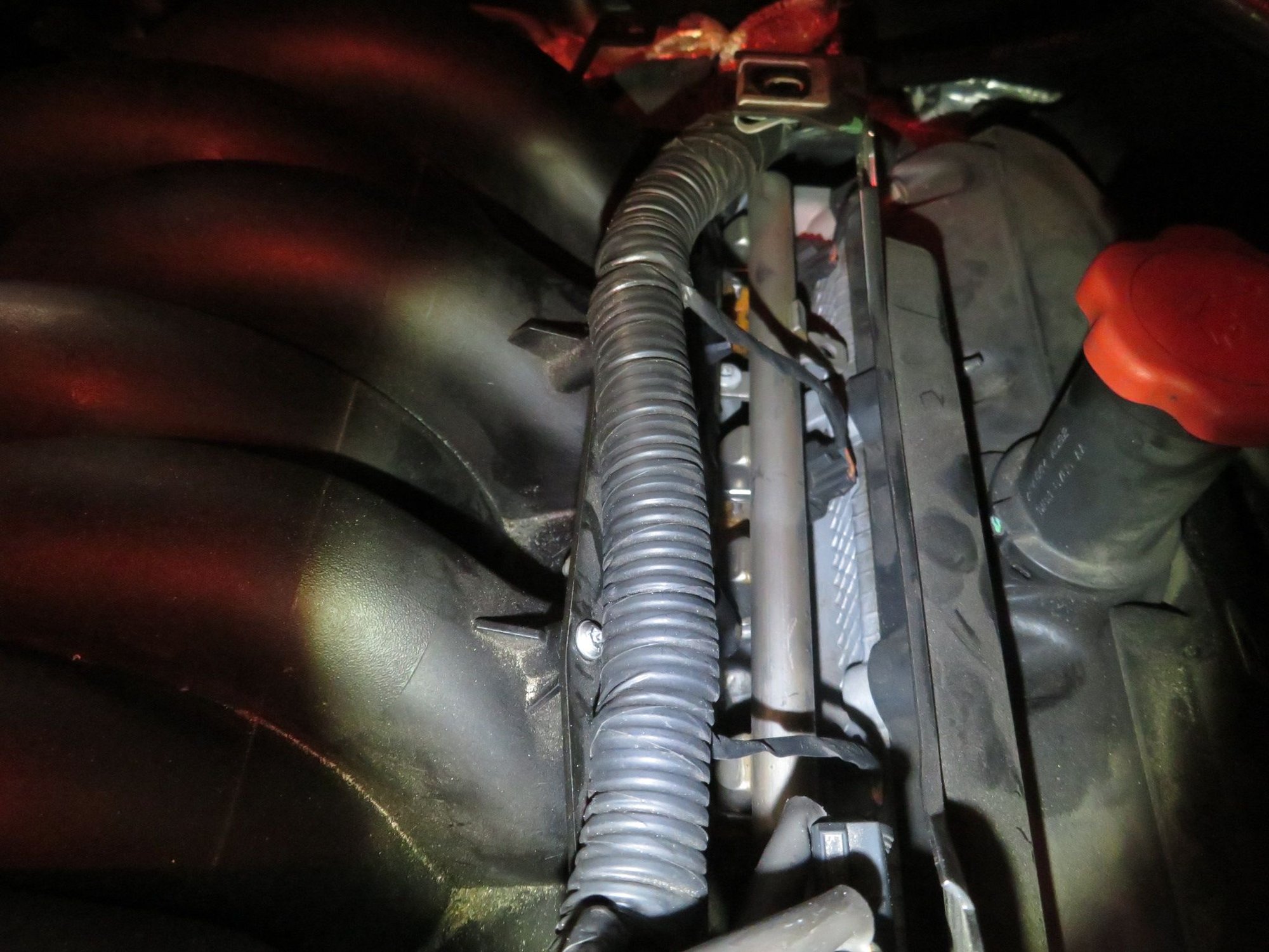

Some pictures of the #8 spark plug and coil

You're showing pictures of the fuel rail - not the coils.
Are you wanting to replace ignition coil or the injector?
For the coils - need to remove the plastic cover that says " Jaguar " on it, below you will find the ignition coils. You wont need to remove anything fuel related. You can get the coils out and spark plugs out, just little less room.

Have a look here for a how-to on plug 8. Your photos are of the fuel injectors rather than the ignition coils, you access the coils/plugs by popping off the plastic cover that has "Jaguar" written on it, the one to the right of the red oil fill cap in your last photo is the cover you're after.

I am sorry, I did not remove the "Jaguar" covers and assume the plugs are underneath!!
And yes the pictures were the fuel rail as you stated.
