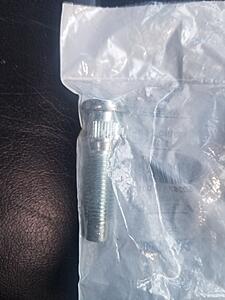

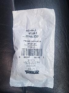

abonano's Avatar
Joined: Mar 2012
Posts: 4,759
Likes: 1,435
From: Hazlet Township, NJ
Dorman 610-484.1 is what I used.
Perfect, tight fitment - for my 04 XJR
I purchased 2 (this is the extra, spare)
Hope this helps.
