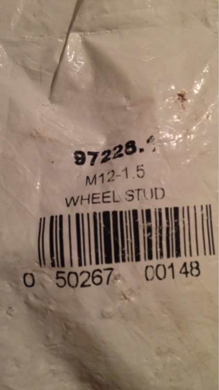

Had a wheel stud break off on each of my 2005 x350s.
The Lincoln ls wheel studs are suitable and available nearly anywhere. They are cheap and nearly any mechanic or tire spot can remove the broken part and replace with a new.
Should be a sub $100 job.
Thanks -mag
