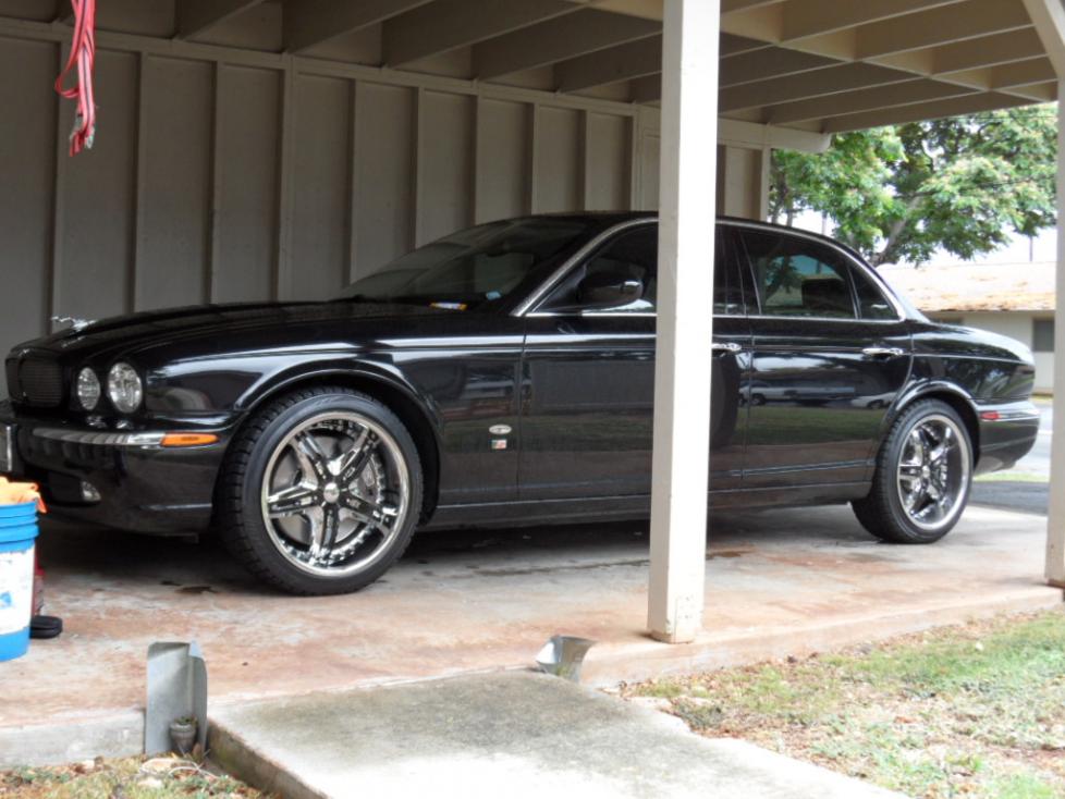

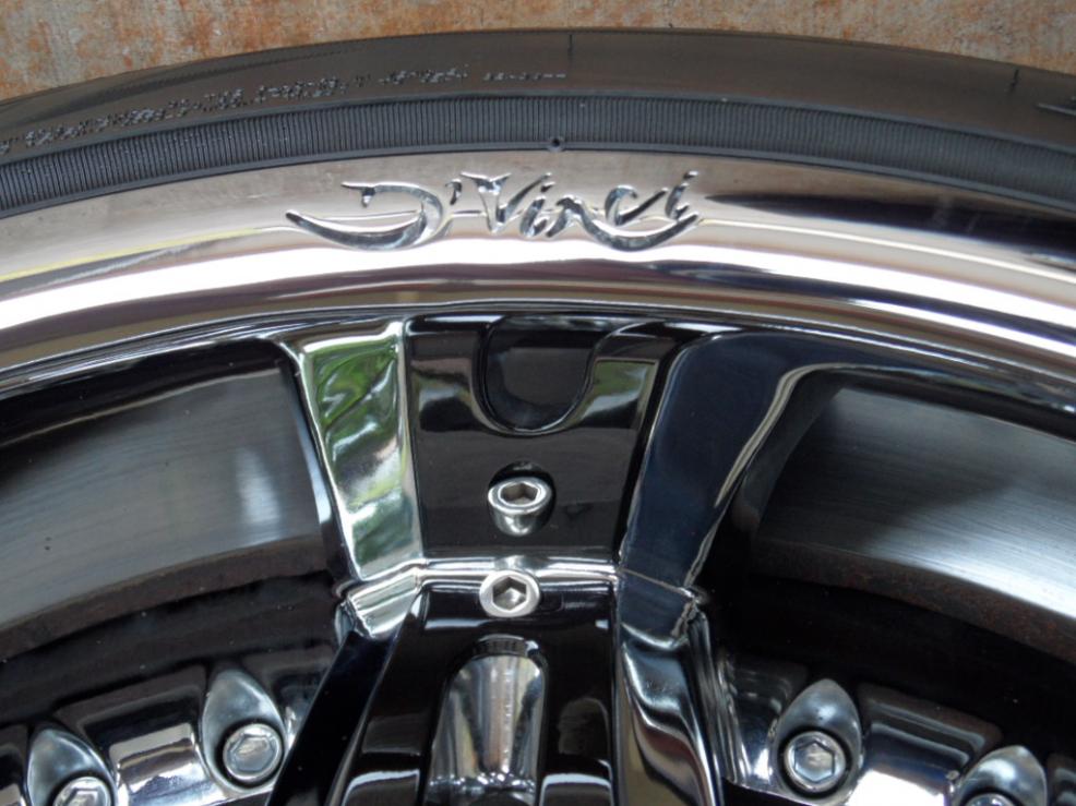

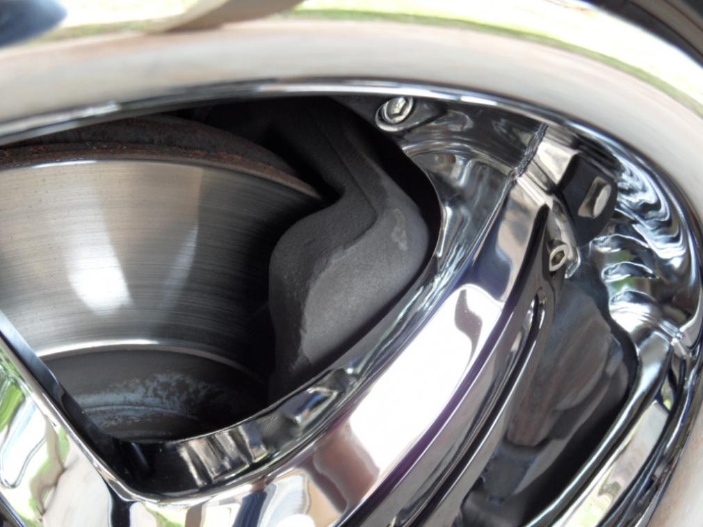

Finally! After just over a month, my rims are in and installed. Apparently, D'vinci Had these rims in stock, but the offset was too high, so they sent them to be milled by 5 millimeters. I'm glad they didn't go 6 mil, but wish they had only taken 4. I have yet to see a rim CLOSER to the brake caliper. Seriously considering getting a spacer to move the wheels out just a little.
Sorry about the pics. Raining all morning, but wanted to get a few pics on here. I'll post more when I get the car detailed again.

Are my eyes deceiving me? Are those snow/ice tires on your car?? In Hawaii??

I was wondering the same thing. Weird tire tread depth no?

The tyres look perfectly OK to me, and if I am not mistaken, have anti-kerbing shoulders to protect the rims.

Those are Bridgestone Blizzaks. Yes, they are a winter-performance tire. The last owner was up in Boston and put the last set on it. I stayed with them for 2 reasons...1), great all around tire....and 2), Leaving Hawaii in January, road trip from Los Angeles to south Georgia, with stops in Denver, then across I-70 to Harrisburg, IL to see my son. Plus, got friends up in the New England area. If I head up there in winter-time, I'm ready.

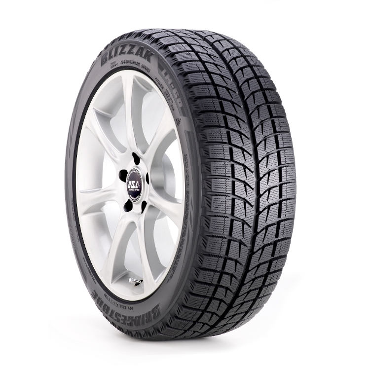

Heres a stock photo of the tire I got. Great all-around, all weather tread. Not too luggy. Great grip, even out here.

Blizzak compounds are designed to run on low temp roads. If you are going to run those in HI then they should at least have nitrogen in them to help keep them cooler, grip better, and mitigate the increased wear. Do they?
Also, they look like they are at their limit of fitting the new rim width. What size are the tires and the rims?

255/40/19....factory size. The rims are 19x9.5.....one inch wider than the stock rims. I checked with Bridgestone on the recommended rim size for this size tire....8.5 to 9.5.....at the high limit. I will go with a 265 (most likely) next set, but this isn't bad, still handles great.
Don't know if the old set had nitrogen, no problems since I had the car here. Had the shop used nitrogen on this set.
