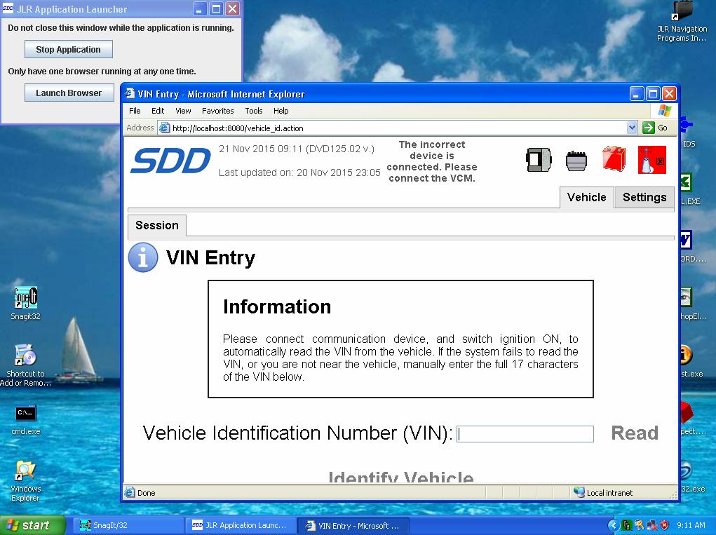

Update: After uninstalling and re-installing V125 files and running the JLR-IDS from the desktop icon, I got the same blank IE window; Darn. But then I discovered that it was set to "work offline" and unchecking that let JLR-IDS go ahead and and tell me it couldn't connect and let me re-enter the user and password, but when it came time to connect the Mongoose it said the wrong device was connected. I uninstalled and re-installed the Mongoose drivers, and then connected the Mongoose and let it find the "new hardware" and automatically install the drivers again, and starting JLR-IDS again with the mongoose already connected it seemed to run again. I was able to enter my VIN and it knew what the car was and gave a number of choices. So far, so good, but momma is taking the SV8 to some church function today so I will have to wait to see how it works when connected to the OBDII. I did connect an OBDII splitter I had in the LR so I can connect the Mongoose easier and keep the Ultragage connected too.
