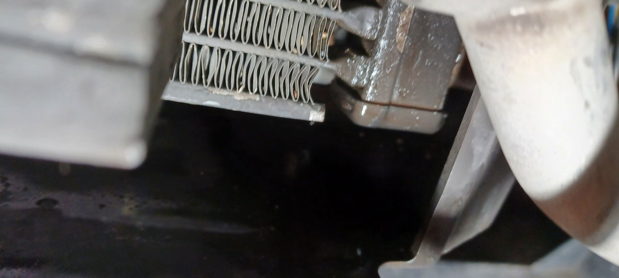

Thanks, Dale. The driver's side lower edge of the supercharger radiator seems to be the culprit. The supercharger coolant pump is on the right side & shows no sign of leaking. I will look for the HVAC pump, but a quick search produced no results.

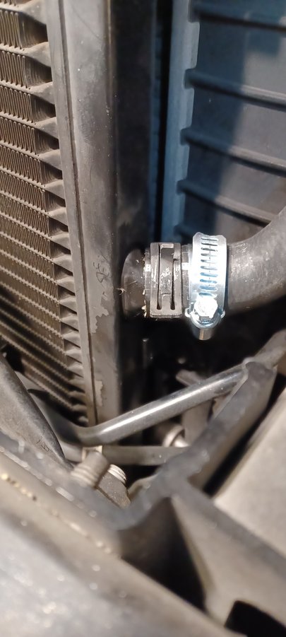

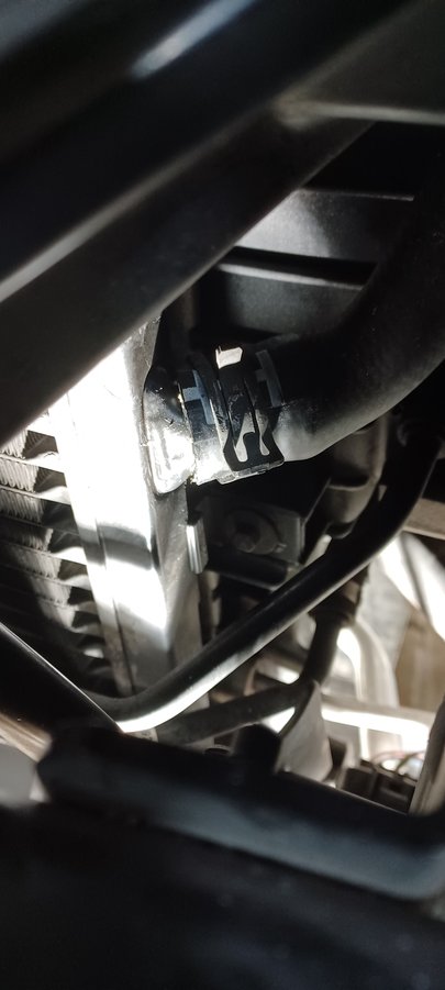

A funny thing happened on my way to deciphering the mystical ways of the five cooling gizmos on the front of my R. before I could ascertain the minutiae of the engine radiator, The SC radiator, one unknown intercooler, transmission oil cooler, and another one:
I pooped the bumper cover off, removed the air intake contraption, wiped all surfaces like I was prepping for surgery and placed paper towels into every conceivable nook & cranny that could possibly leak. After putting the intake stuff back in place (amazing how easy this has become!) I fired her up for a 20-minute symphony of vroom when suddenly - oh, the horror! I remembered I was late for drinks with our notoriously gregarious, cardigan-wearing communist neighbor. My long suffering wife made it abundantly clear that my presence was non-negotiable, lest my underwear be starched to here-to-for unknown stiffness. So, I shut her down and headed straight to the shower.
After coffee this morning, I found no coolant anywhere. I started to extract each piece of paper towel and then, lo and behold! (See picture of the offending fitting!)
You can’t imagine my disappointment in not having to enlighten myself of all of the nuances of the delightfully twisted minds who designed this highly effective and convoluted…

Since the leak was at the nipple where I attached a new hose during my Valley Expedition, the fault is not with any part or anything by Jaguar, but with yours truly.
If we weren't headed out of town and the holidays not so close, I would have removed the clamp, which, I believe, was the original one and I reused it. Instead, I just sistered one next to it as per the photo.
I wonder if I could have done something to preclude this from happening? New clamps all around? About half of the hoses came with new clamps, others did not. Perhaps, had I run the car before reinstalling lamps & bumper cover, etc., that may have found it. But I doubt that because the leak just started a few weeks ago..C'est la vie, mon fifi.

Hoping this works for you.
Genuine Jaguar hoses have came with the clamps included.
But if not badly rusted, reused spring clamps have worked out fine for me.
The radiator's plastic connector may be at fault.
Hoping not, radiator replacement, is rather time consuming.
