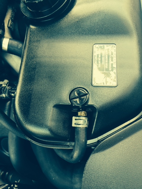

I realize nothing is all that easy on these cars...But this is and has held up the past 300 or so miles. Perhaps it can be considered at the very least a temporary fix for some. So here is the story.
Over the past week I had been smelling antifreeze. Didnt see anything in the engine compartment and the level looked full so I figured Id wait this one out. While at the shop getting my estimate for a new exhaust (yes!) the owner said "hey, there is some antifreeze around the coolant tank." It was just a little bit that had collected around the tanks lip. So I was like hmm perhaps one of the smaller hoses that go into it are loose. WELL...I barely even touch the one and it just breaks off in my hand sending antifreeze everywhere from out of the tank. Upon closer examination it appears that the nipple was partially disintergarted within the hose. The one hose was actually DRY and totally glogged by this disintergrated nipple.
ANYWAY...This is what I did. I cut the nipple portion flush and even. With my tap set I gradually tapped the opening increasing the size gradually untill using the 1/8"mnpt(believe it would be considered a 1/8" 27) I then went to my local autoshop and picked up a brass 1/8"mnpt-5/16" brass hose fitting. I wrapped the hose with teflon tape and inserted it carefully so it would not crossthread. The photo is the before and after. Not sure if this has happenned to anyone else....But it may save someone in a bind:O)

Make sure to get the 1/8 fitting. It has a fine thread pitch and is about the smallest I could find for 5/16" hose. Also I didnt drill as I didnt want to heat the plastic or remoove to much material. Gradually increasing tap size did the trick. Be patient. Hope it works out well for you. Ill be buying a tank eventually just in case....

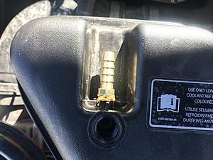

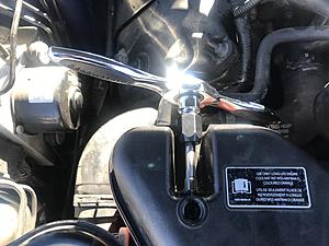

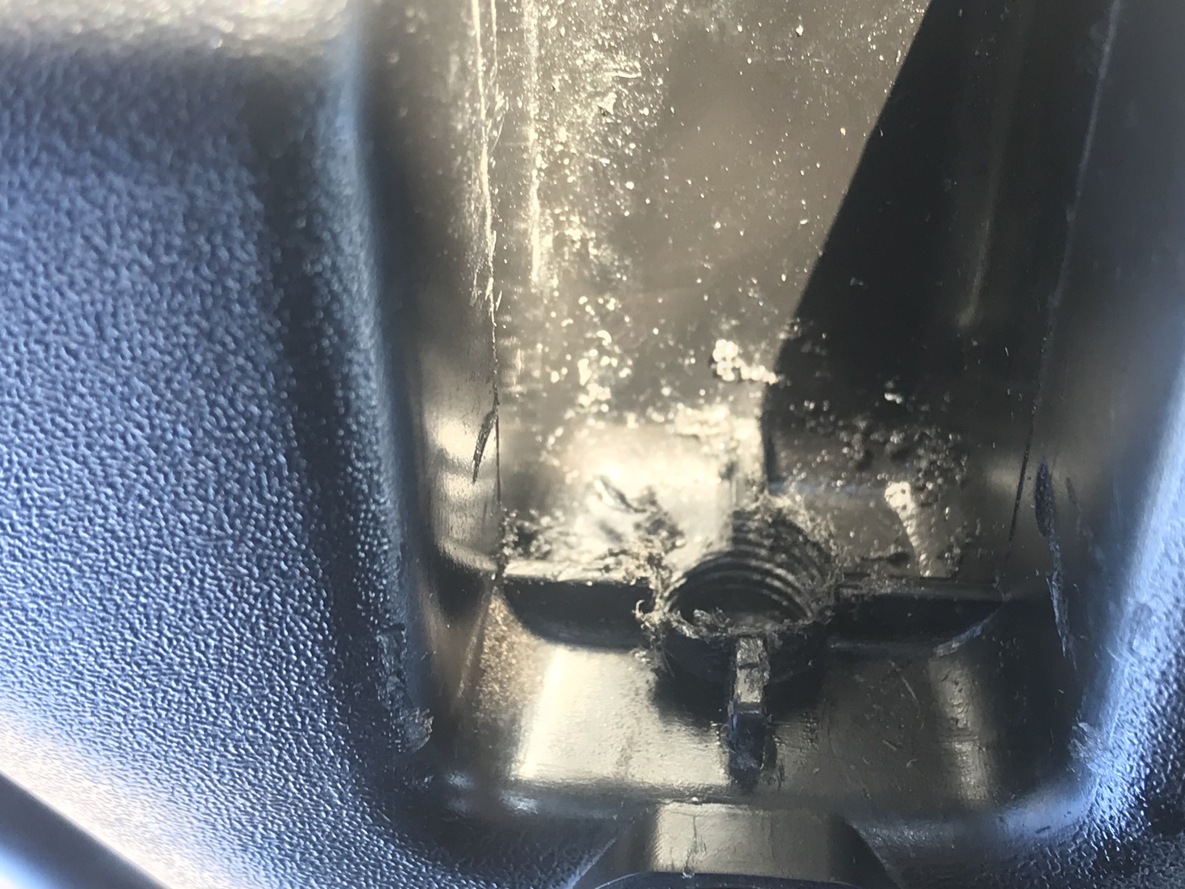

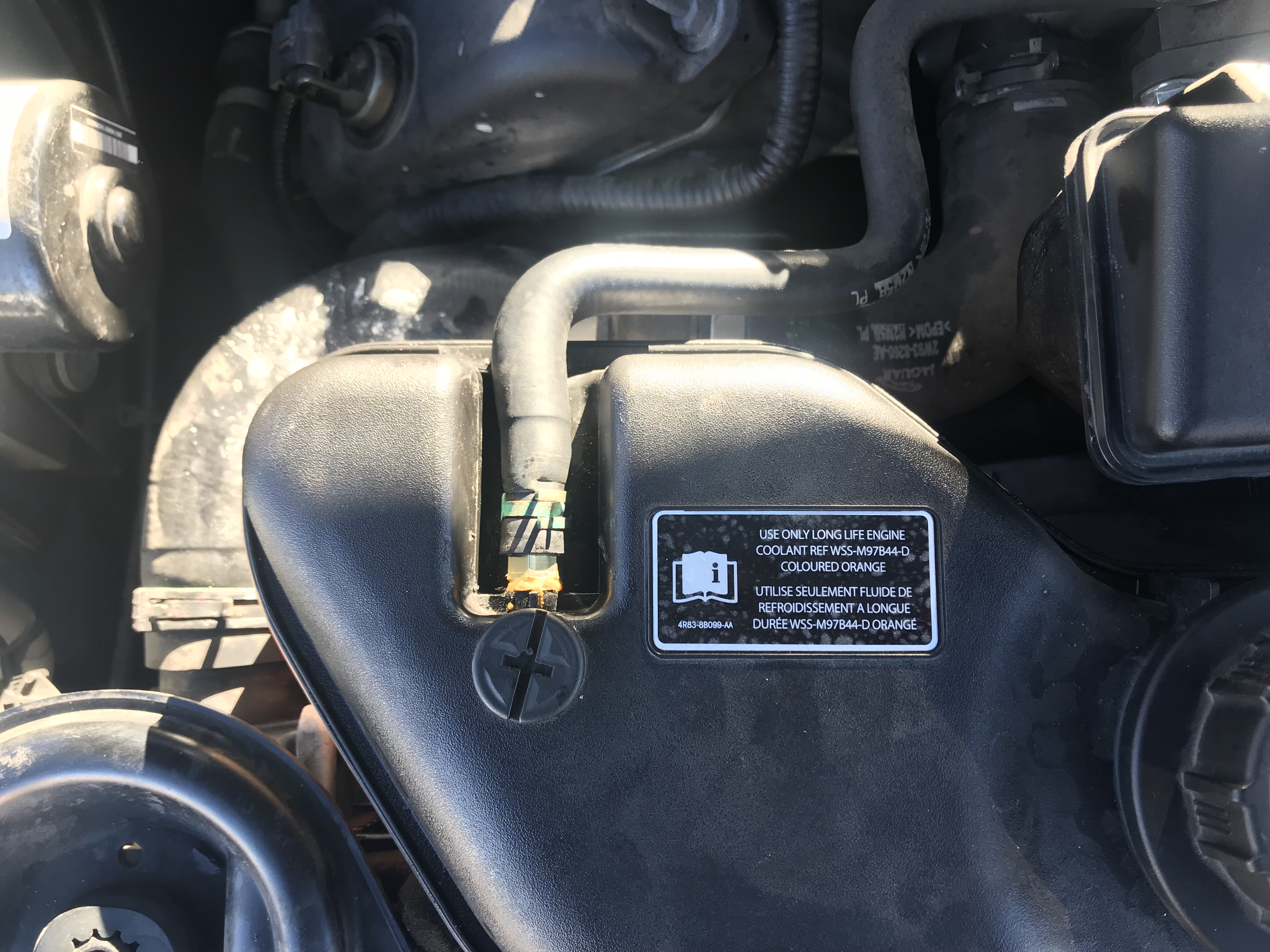

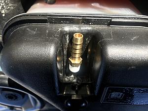

Old Jan 29, 2018 | 11:09 PM
chillyphilly's Avatar
Joined: Dec 2014
Posts: 592
Likes: 247
From: South Idaho

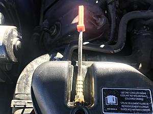

Thanks for the write up. I broke mine after checking for coolant leaks the other day. How ironic, huh?
I ordered a pack of 5 stainless fittings off of Amazon, but didn’t realize they’d take a month to get here from China.
Amazon Amazon
So I hopped down to the auto parts store and picked up a brass fitting. I also purchased a Gearwrench tap and die set.
Amazon Amazon

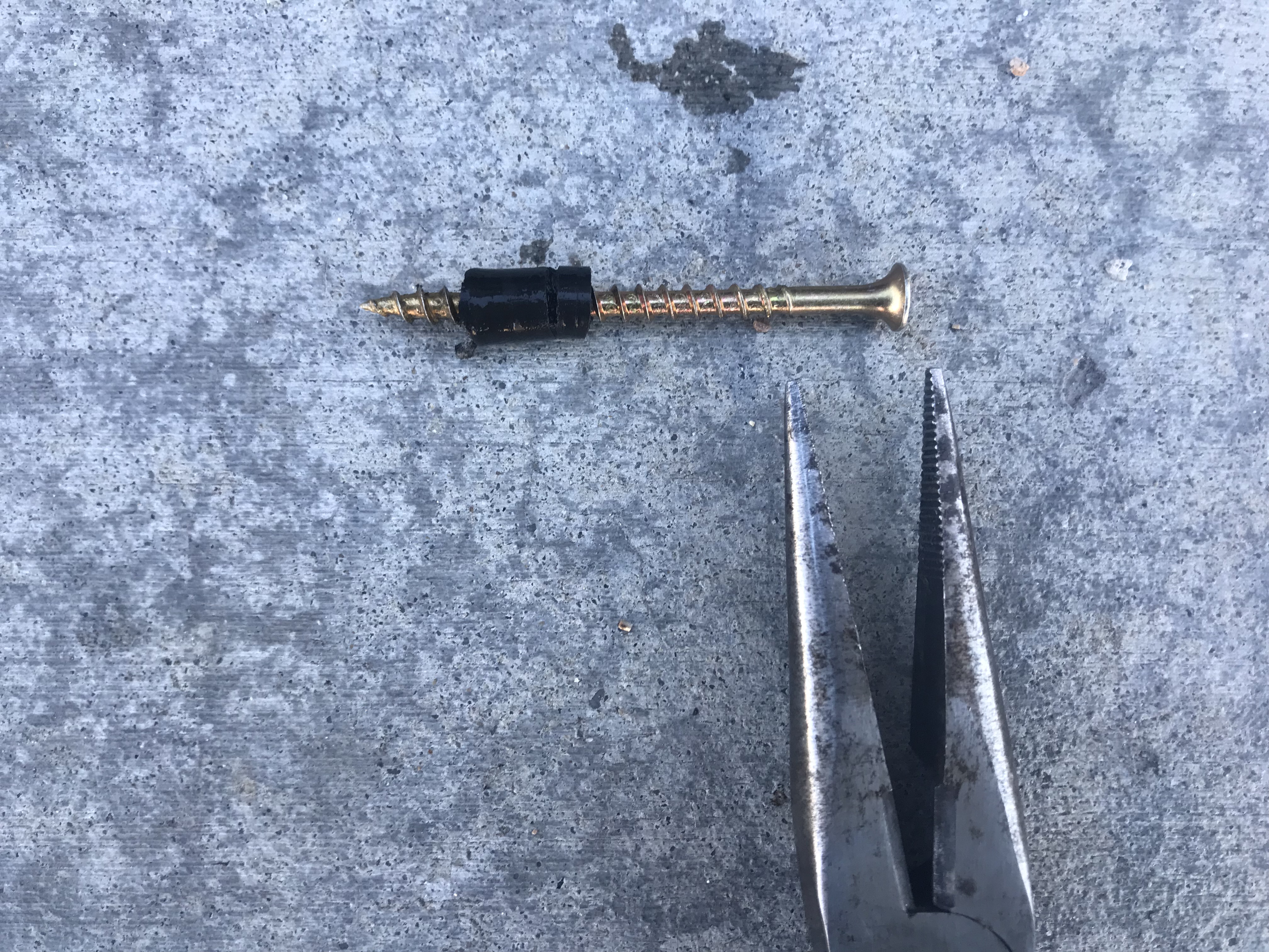

I slowly drilled it out with increasingly bigger spiral bits (using a battery powered drill) until I got up to a 9/32” bit. I was then able to use a couple of taps and finished with the 1/8” 27 tap. I teflon taped the fitting and also applied a small amount of gasket sealer as an added extra. I started to thread the fitting in by hand and then took a small three sided file, snugged it up inside the fitting and screwed it in the rest of the way, because getting a small wrench in the fitting was to tedious. To get the rest of the broken plastic nipple out of the small hose, I screwed in a screw and pulled it out. When I threaded it in I was actually impressed with how well it grabbed on and held, considering how little plastic is left after drilling it out. It is relatively stout now. I did a similar fix years ago on a different vehicle but it didn’t hold as well as this, but even that one lasted a long time. I expect this one to last a while.
