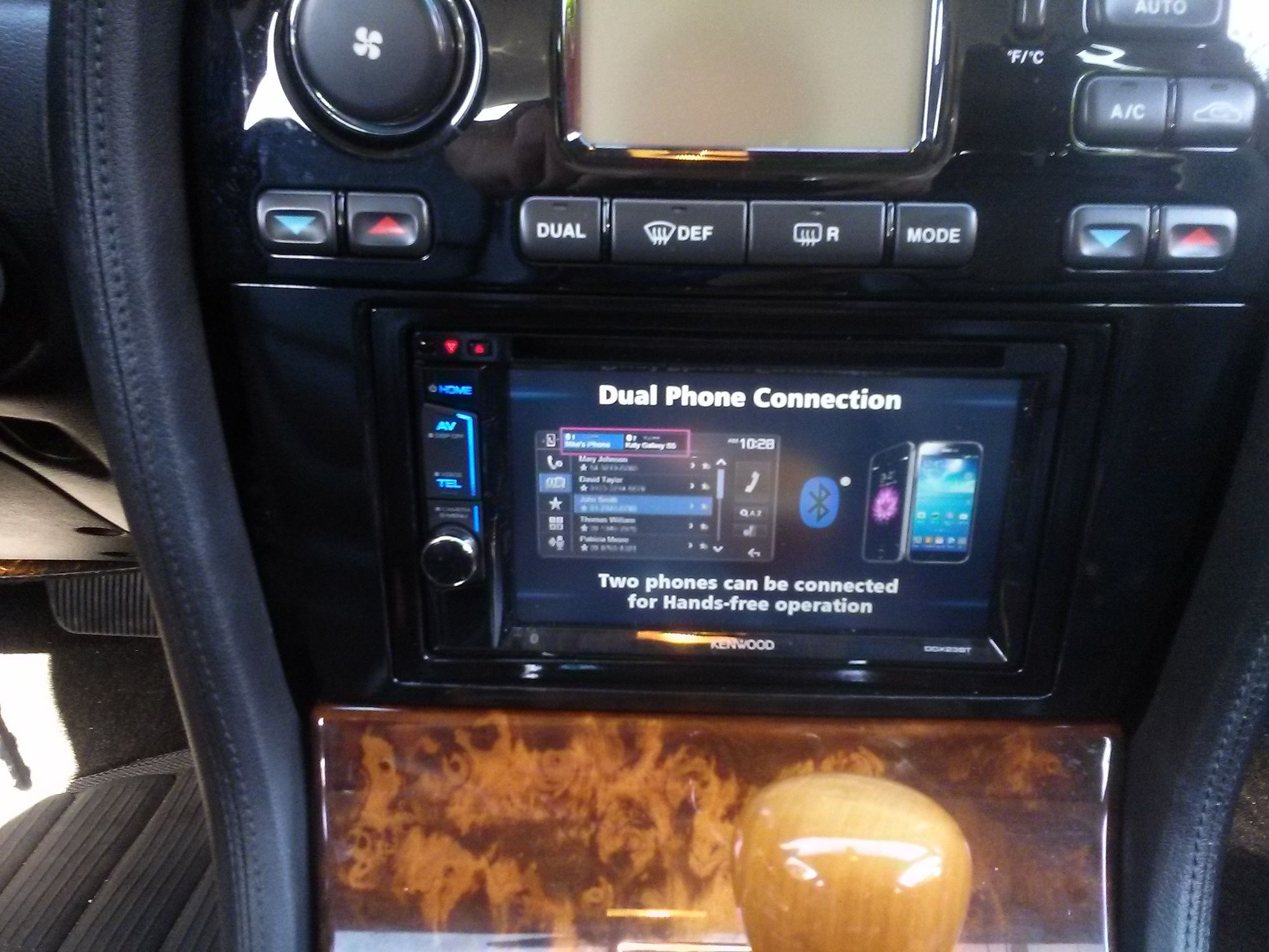

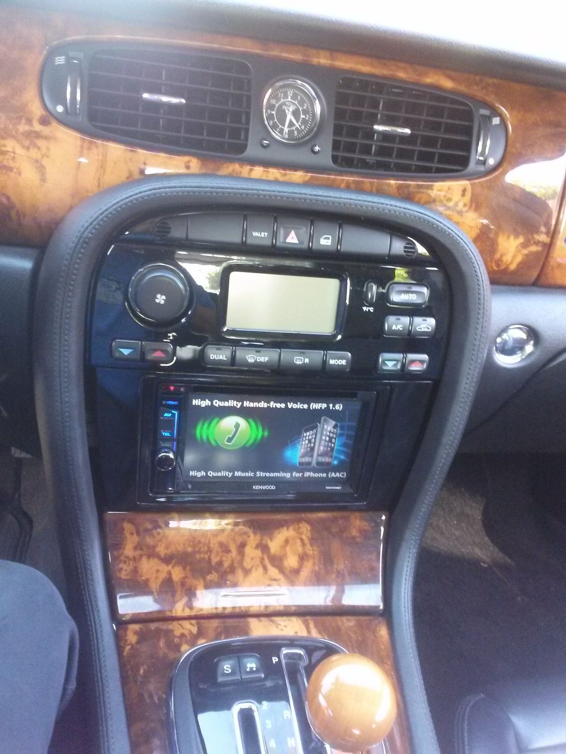

The only dash kit made that bolts in is designed for the S-Type/X-Type but it leaves about a 1/4 inch space on each side as the S-type has a narrower center console. It also comes in matte black and not glossy black. I used it anyway, painted it with 2 coats gloss black and two coats clear. Crutchfield gave to to me for free with the radio purchase.
https://www.crutchfield.com/p_120999501G/Metra-99-9501B-Dash-Kit-Gray.html?awkw=75646650265&awat=pla&awnw=g&awcr=47 717696305&awdv=c&awug=9061321&gclid=EAIaIQobChMIjL DOnPzp3wIVja_ICh3zPgNSEAQYAiABEgIFZ_D_BwE
You also need a wiring harness,
https://www.crutchfield.com/p_120709500/Metra-70-9500-Receiver-Wiring-Harness.html?awkw=75645805225&awat=pla&awnw=g&awcr =47718650545&awdv=c&awug=9061321&gclid=EAIaIQobChM I5f3G3_zp3wIVl47ICh2cpgfAEAQYAyABEgLgXfD_BwE
And an antenna adaptor
Amazon Amazon
You may also need a steering wheel control adaptor if you want to use the steering wheel controls with your new radio. Can't help with the other stuff as I didn't use/need them. The radio install was very straight-forward if you have done this type of thing before in other cars. The speakers are a bit more trouble. They are 6 3/4", not 6 1/2 like some of the websites suggest. But there is plenty of room for adaptor plates should you want to install smaller (or slightly larger) speakers.
