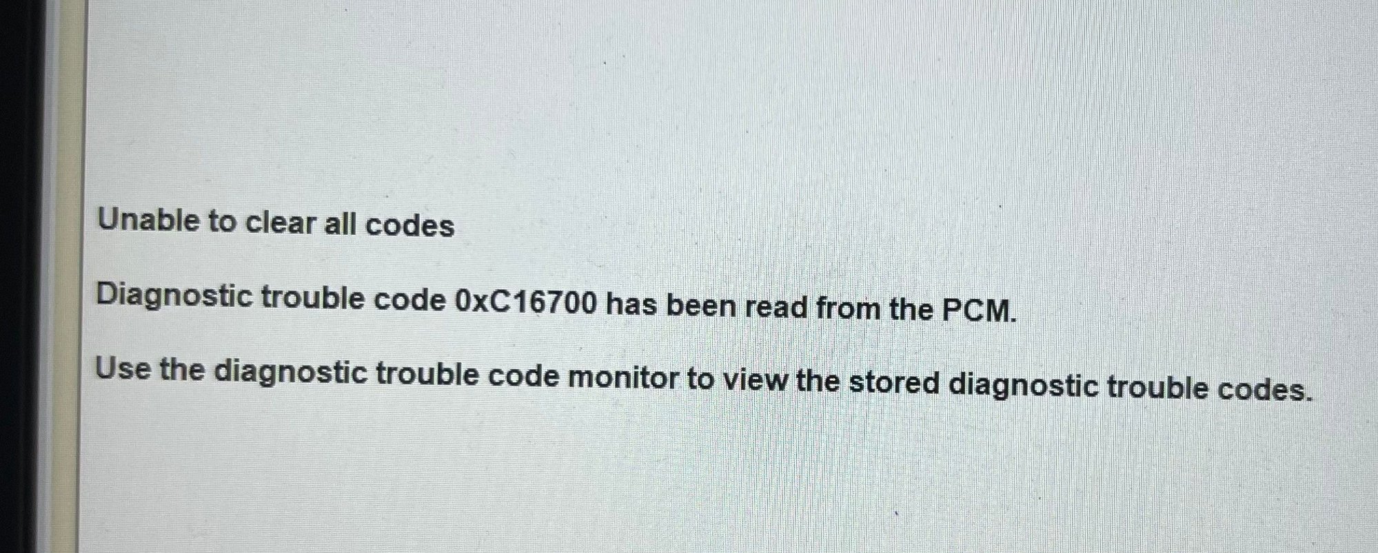

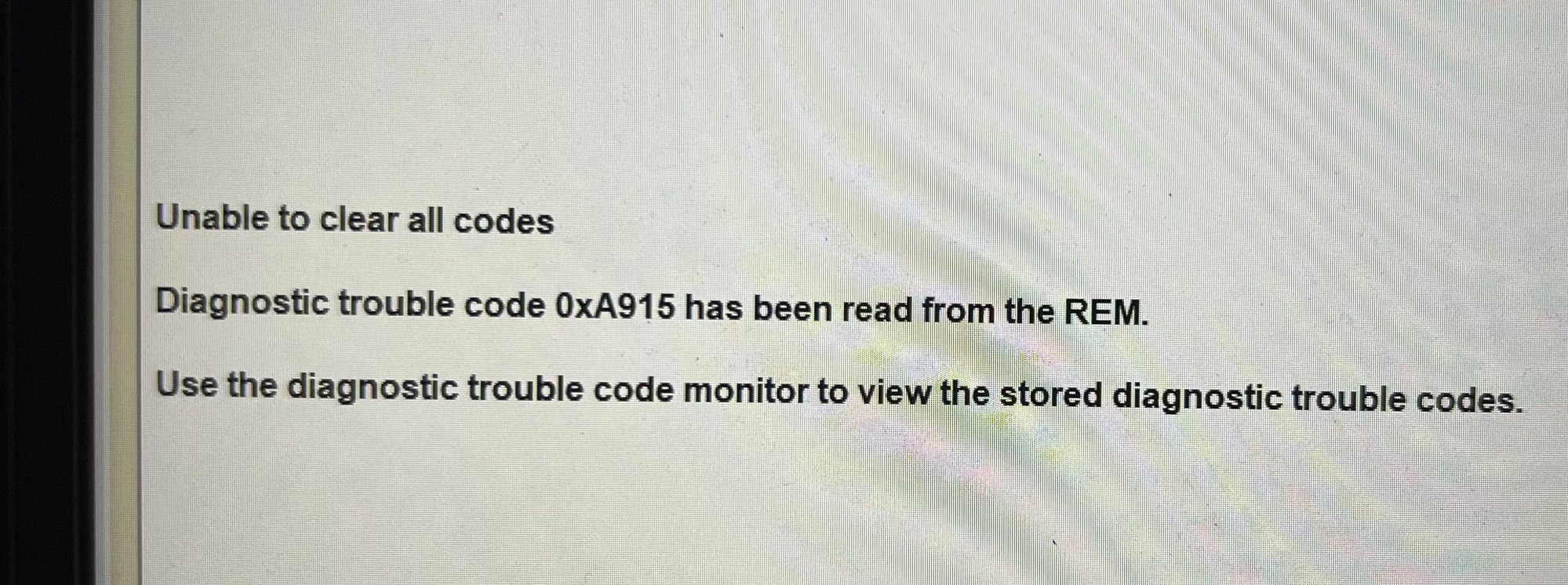

Hi,
In my Xj X350 imported from the USA, the rear fog lights do not work. In my country they are required due to regulations.
I checked the fuses, bulbs, the wire connecting REM with the bulbs and whether there is + on the bulb.
Everything is ok, but the lights don't turn on.
Yes, I know... that the rear lights come on when the dipped headlights and front fog lights are on.
So I decided to reprogram the REM module, but unfortunately I get such errors during programming.
I have a second REM but it differs from mine with the last letters.
My is 5W93-13B524-AB second used is 5W93-13B524-AC
Will I be able to program it? I haven't checked yet.
Maybe you know what these errors are? I can't find it anywhere
THANKS Arek
