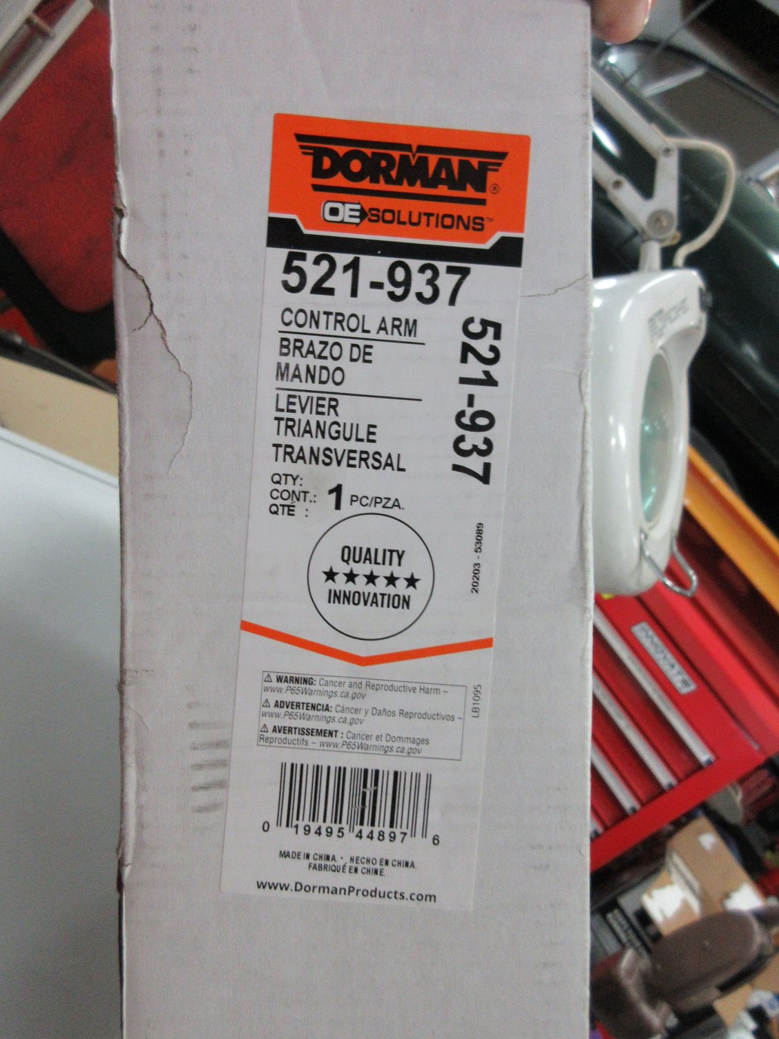

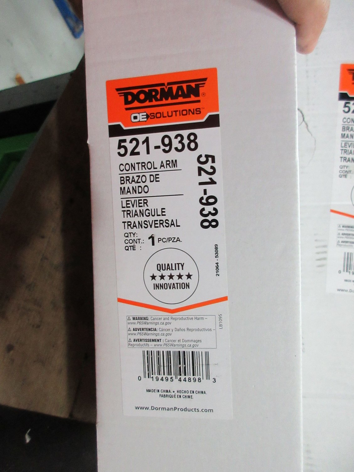

Thanks for the reply Fraser, I was originally thinking a rubber bushing wouldn't be that bad to press in, but after seeing all the special alignment tools I am more suspicious of my general mechanic doing this. I would try it if the bushing was reasonable price but I am seeing them from $50-$80.
Thinking of going entire arm, but need something I can get delivered in a few days.
Does anyone know the Ford part# for the later 2006 VINs for those lower rear control arms ?
Try for a Moog listing. Popular supplier to many distributors.
Per prior posts to this site, Moog buy the OEM Lemforder, grind the maker's info off, re-mark with Moog SKU.

bushing is available from lemforder but not worth the time and effort.
the lower arms and knuckle changed in 05 they have a narrower bushings. anything xf xk f-type x351 etc work for those
