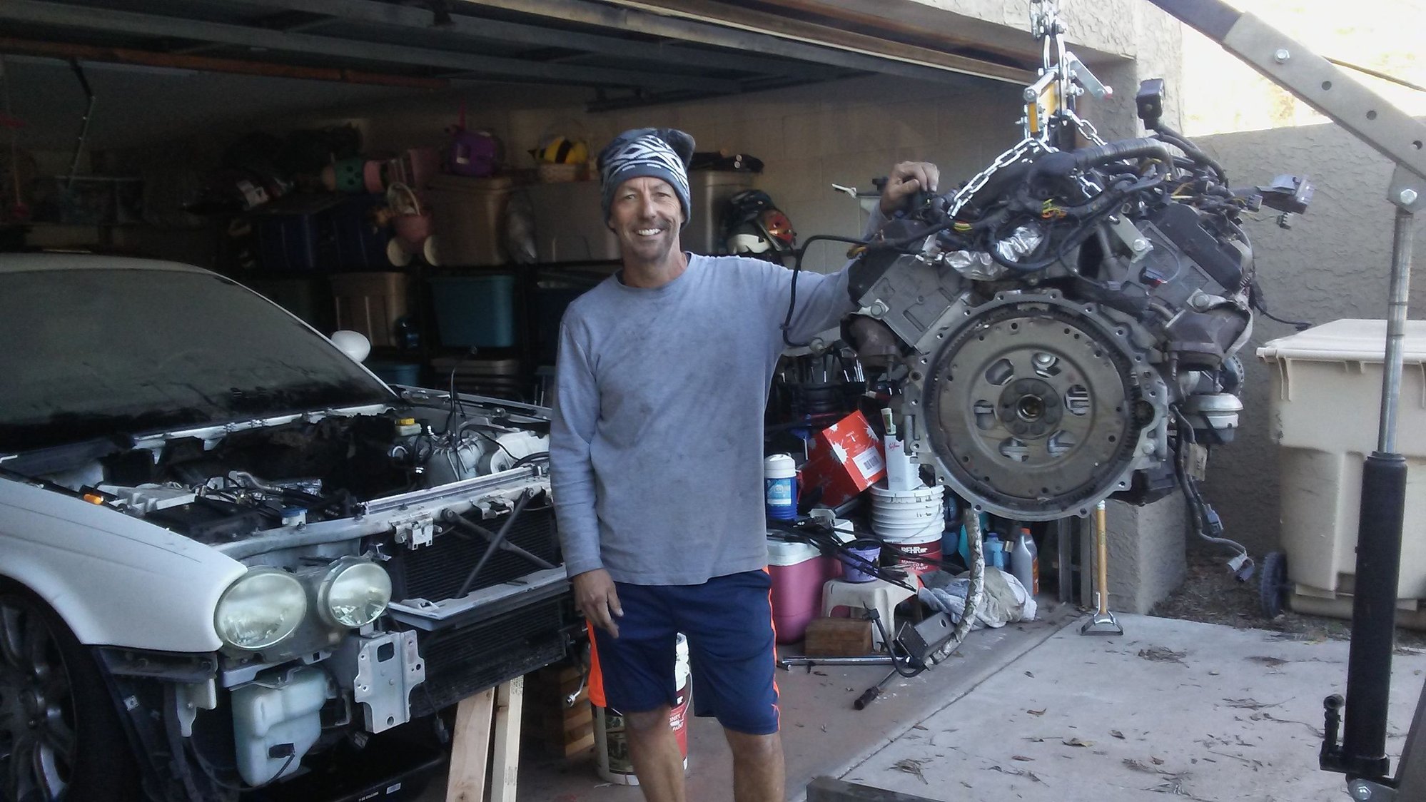

Its possible. I had to do it 2.5 years ago. With no lift. It was tough, but basically I did what Brian mentioned.

Well I did it and it wasn't that hard, apart from a couple of upper bolts on the bell housing and freeing the transmission connector wire, just a matter of disconnecting all the hoses etc. and yanking that bad boy out.
