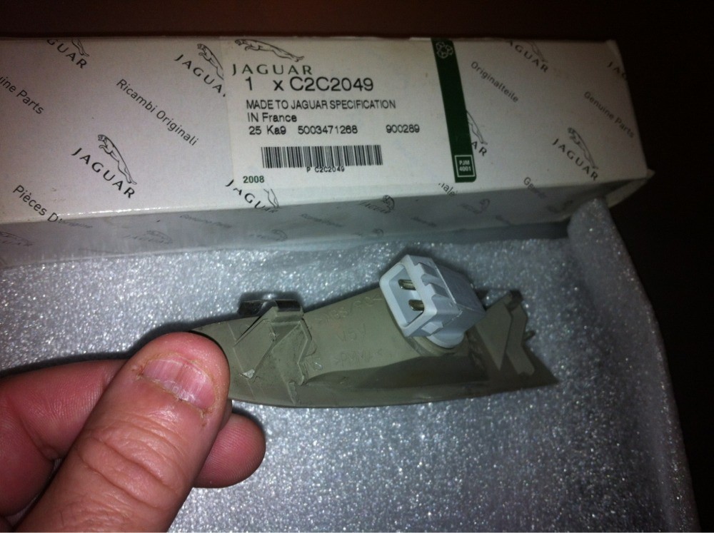

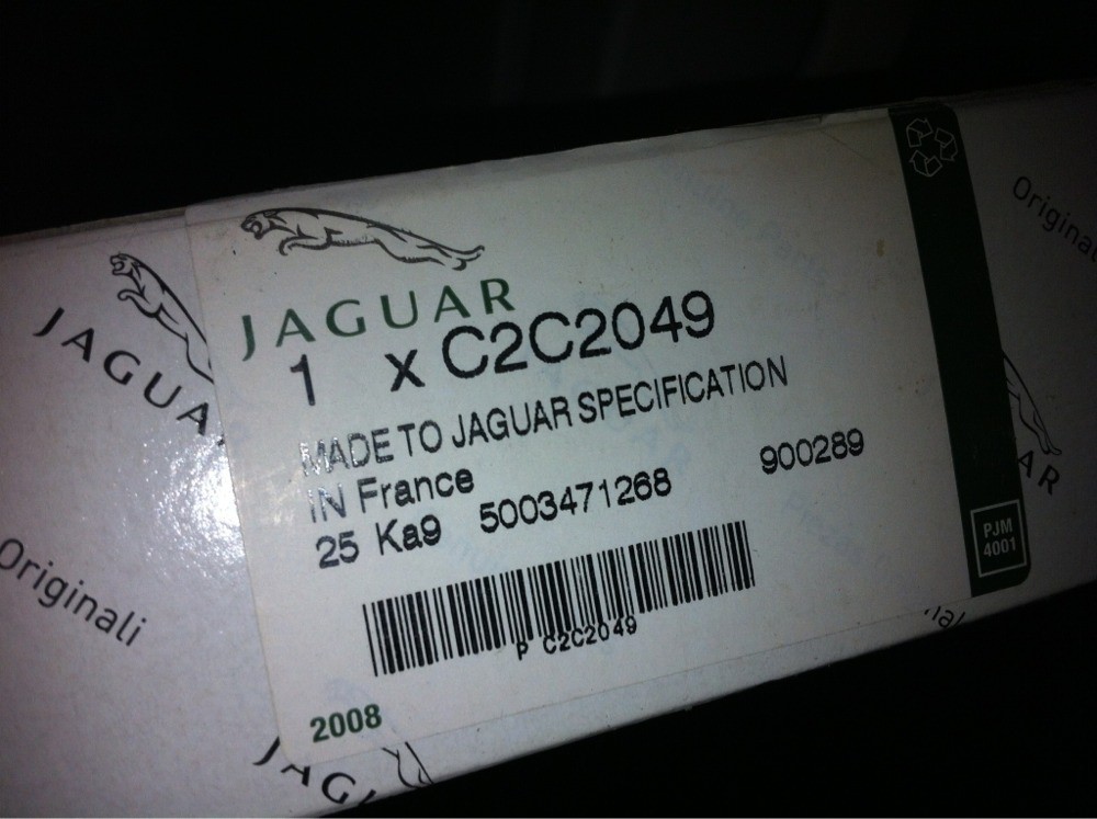

Old Mar 22, 2013 | 05:39 AM
magmedia's Avatar
Joined: Mar 2009
Posts: 901
Likes: 258
From: Eastern, MD
Here are a few pics from my replaced side marker. Hope this helps...
jaguar side marker photo, picture, image on Use.com
Thanks-
Mag
Attached Thumbnails Sidemarker Fault-jaguar_side_marker_98a54ae8b0b8b2da3bf5.jpg   Sidemarker Fault-jaguar_side_marker_98a54ae8b0b8b2da3bf5_2.jpg   Sidemarker Fault-jaguar_side_marker_98a54ae8b0b8b2da3bf5_3.jpg
