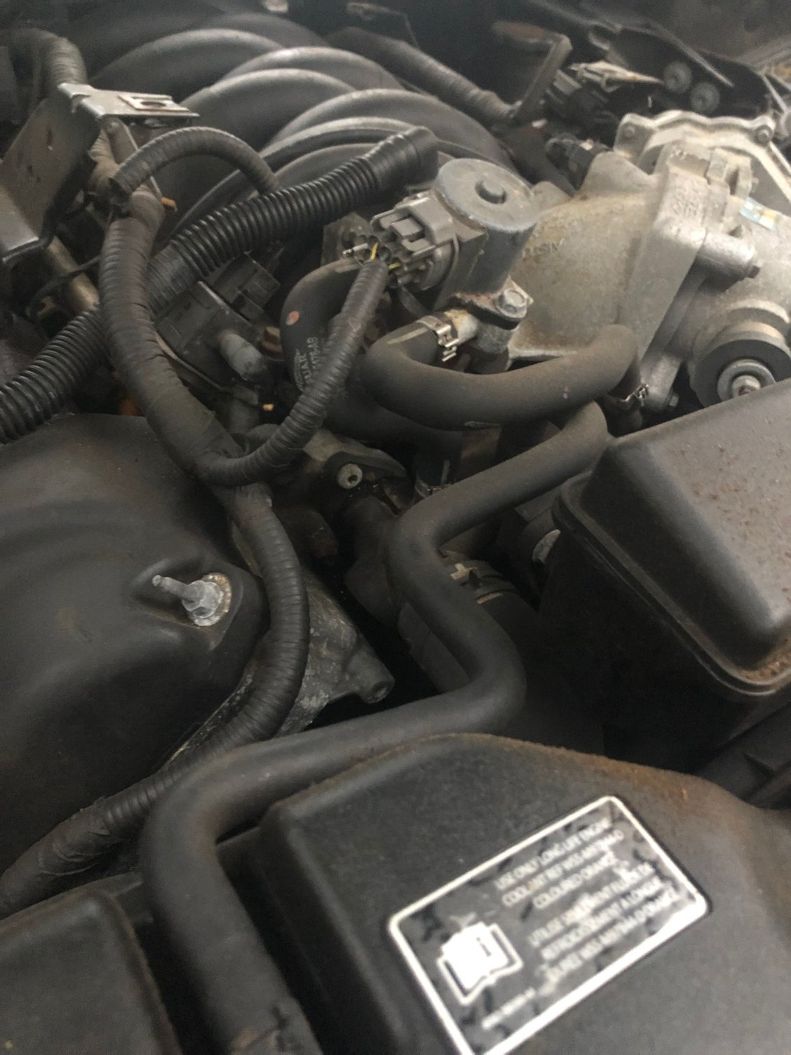

Hi All,
Slowly sipping coolant (1L ~1000miles) from the pictured part (below) - it seems it is made out of plastic (!) and has one of the big coolant pipes connected to it. Pic taken from top (front), closer to passenger side.
common culprit?
2005 VDP
Thank You!

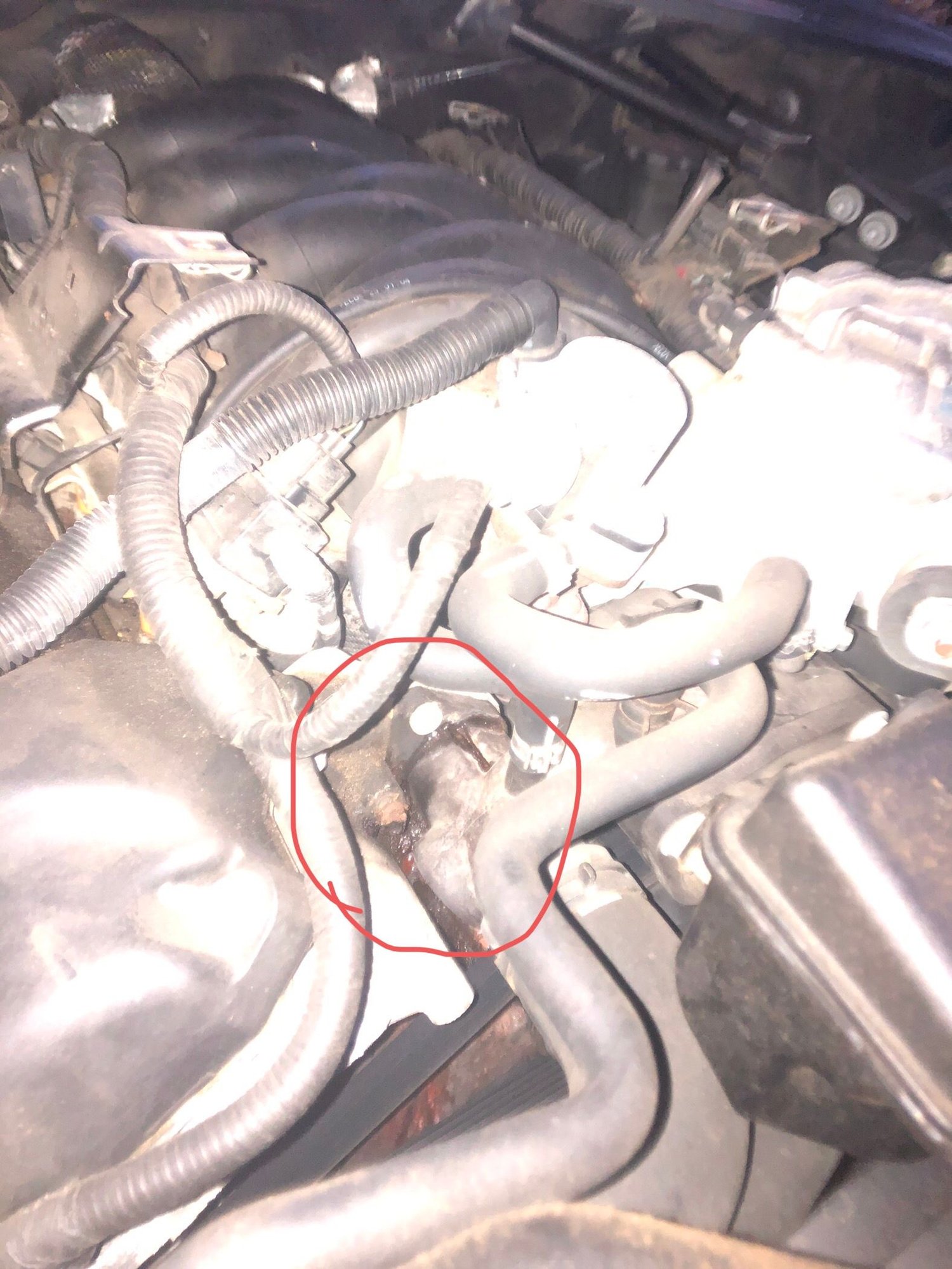

no flash photo:

Yes common. The plastic degrades. Replace EVERYTHING around the area. If you don't you will be back or when you take off the part you will notice the related parts have also about to fail. There are write ups. Read up and order everything at once.

My thermostat housing failed at exactly the same spot.
Here are some pictures in this thread:
https://www.jaguarforums.com/forum/x...-114486/page2/
