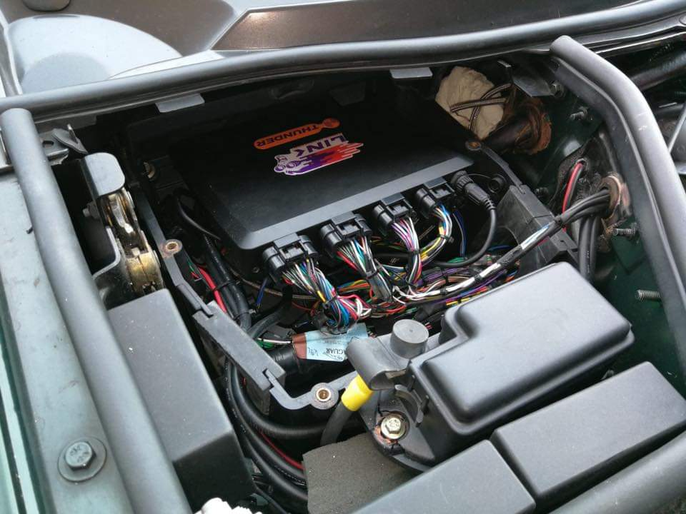

Apologies for the delay, from memory, and this was back a couple of years, Tom offered a kit with a Link Thunder ECU, as below, and photo, and from memory again Tom had said he was then using the Ford GT500 90mm TB with this, so as to remove that restriction. Perhaps even if Tom is now on longer offering this (unfortunately) then another Link dealer could assist? Not sure if he is still active but "Davey" from the UK forum was the TS in his X350 so if you can track him down he might be able to help.
https://dealers.linkecu.com/G4PlusThunder?quantity=1
Not sure if any of this is helpful. But I hope so, and congratulations on keeping the car...
