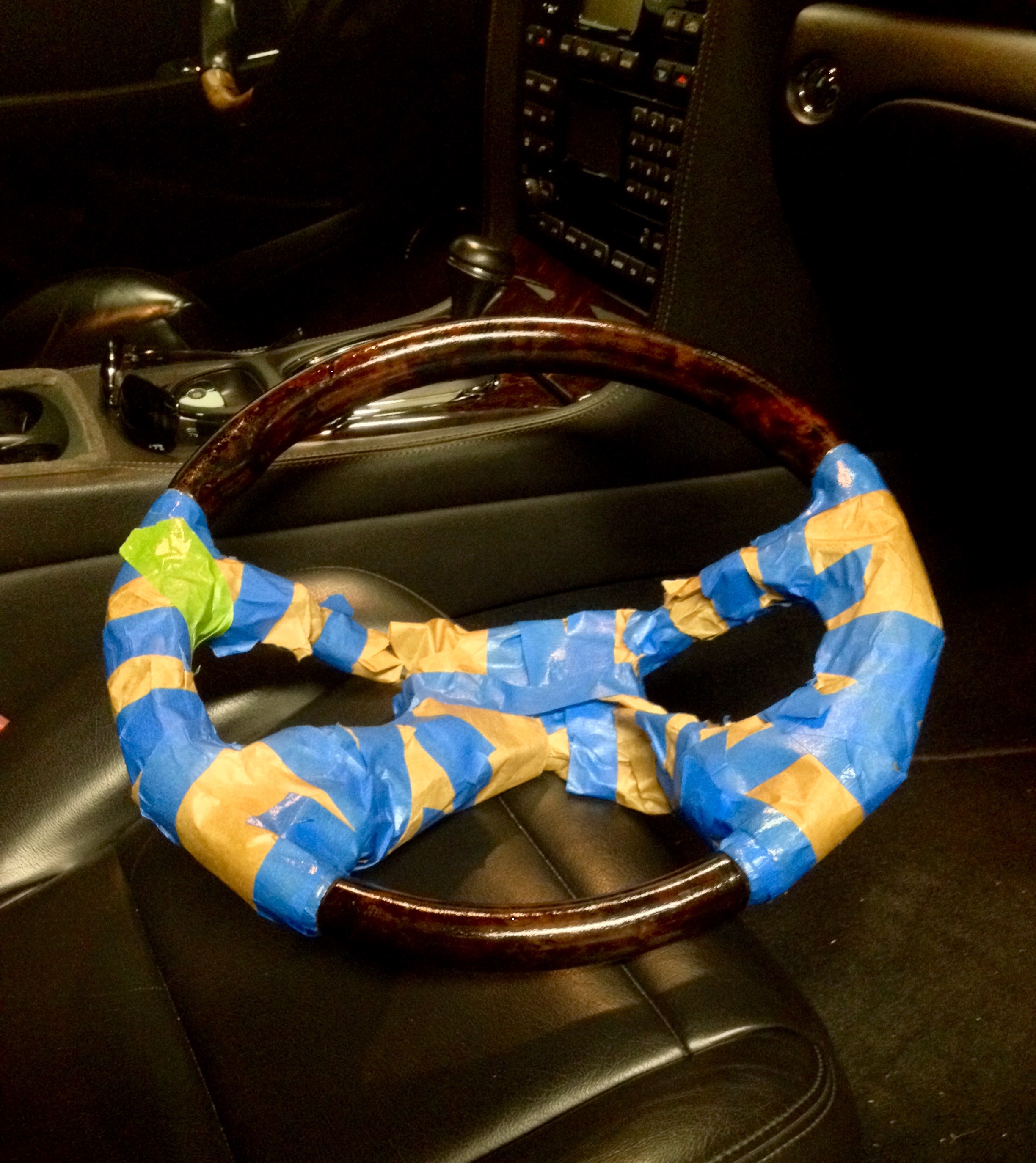

Today I stripped, sanded, and stained the upper half. The stain is still a bit wet so its a pretty good preview of what it will look like with a finish coat. After the wood I'm going to re-stain the leather.
First coat of varnish, I'm using McCloskey Man O' War Spar Varnish. It's an indoor/outdoor product with UV protection (
). I plan on 5-6 applications and will smooth out with 0000 steel wool before re-application.

I hope you have better luck with spar varnish than I did when I first refinished the wood in our '93. I thought spar varnish's ability to expand and contract would be perfect for the interior wood, but I found it difficult to get a blemish-free finish, and it cured so soft that it would not polish well (it isn't designed to be wet sanded and rubbed out). And after just a couple of years it began to crack. The deterioration was faster and worse on the pieces with a metal substrate.
I've gradually refinished most of the deteriorated spar varnish with the automotive clearcoat I mentioned earlier.
I hope things go better for you.
