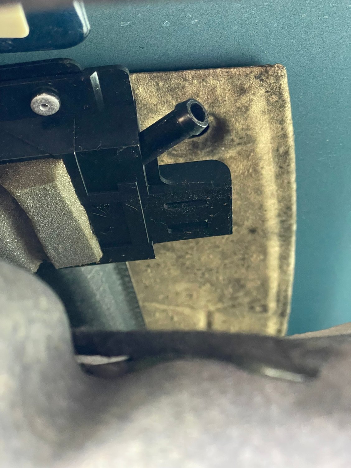

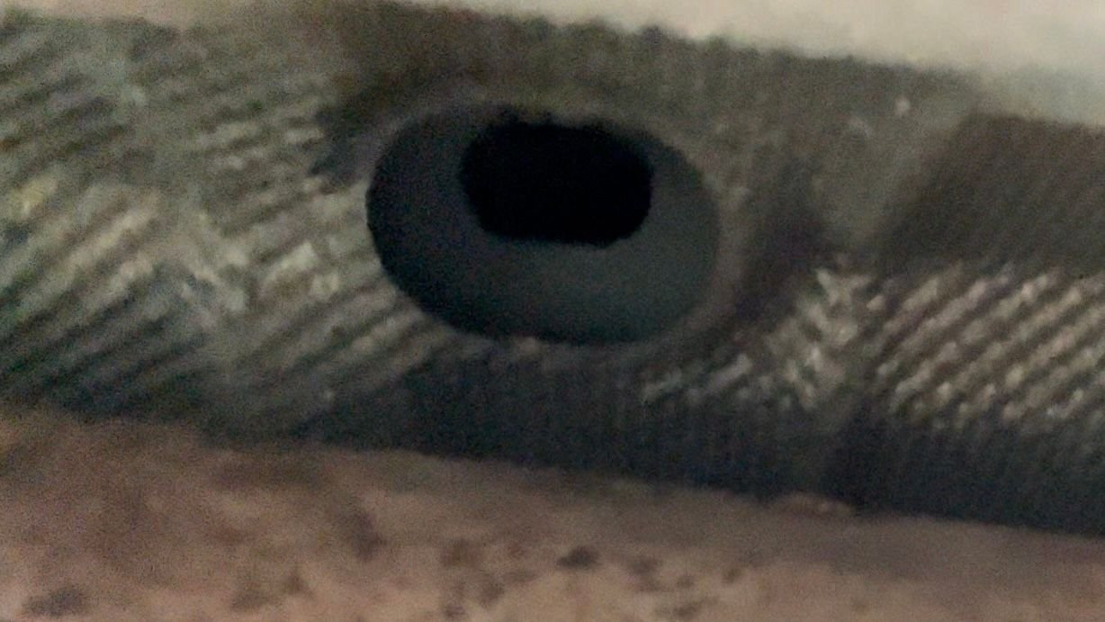

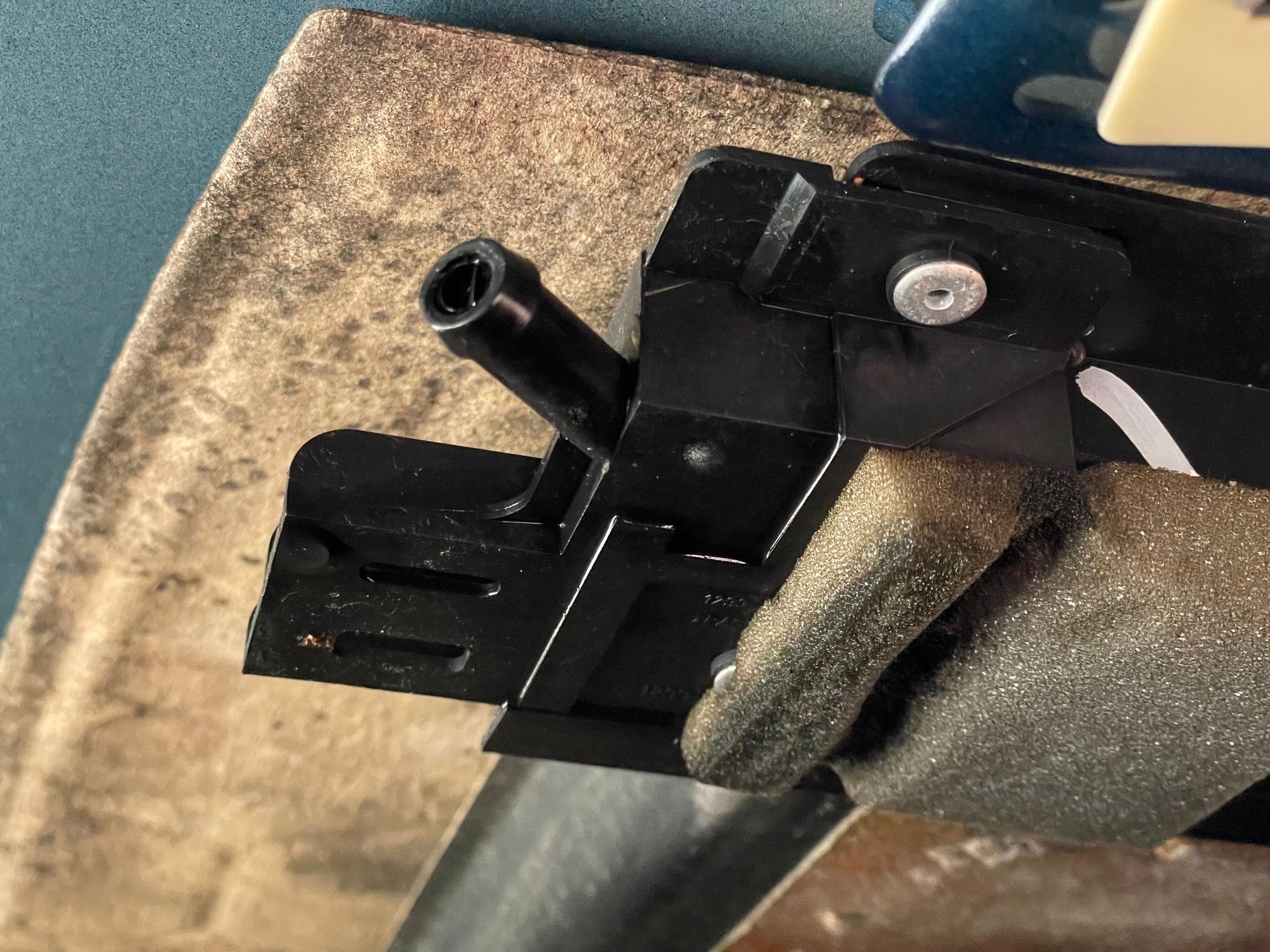

Investigating the ingress of water on my “new to me” XJR and I find both rear drains have been removed entirely! Looking at options now…
Offside aft
Offside aft
Nearside aft
Nearside aft
is there any logical reason they’d be like this?

Also checked TSB XJ501-13a and found exit fittings also removed. Gah.

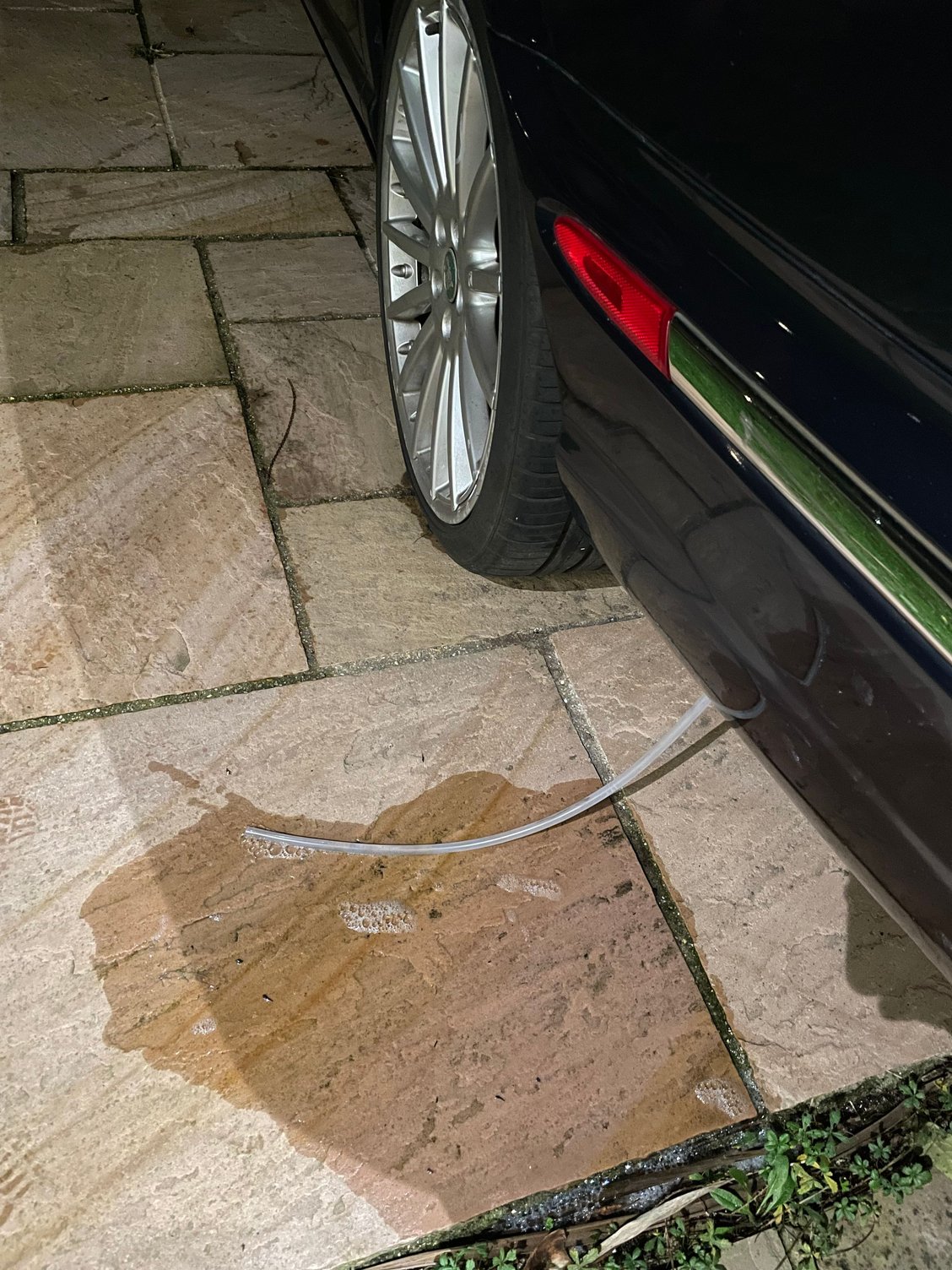

For future visitors to this thread, it is indeed possible to reroute 2x 2.5m 8mm ID (10mm OD) silicone tube from the sunroof, down to near the original fittings in about 2 hours all in.
Now need to investigate whether the bumper needs pulling to facilitate refitting the tube to the OEM outlet fittings or something else.

I need to go out on check on the current state of the nation with my silicone enhancements and see how they're holding up in this recent rain...

Much success! Mostly…
one tube was kinked so didn’t quite work as planned the the other side worked flawlessly <chefs kiss>
I might rerun them with slightly thicker walled tubing if they start to cause trouble… Can also confirm NO outlet fittings exist as I’m passing my tubes out onto the deck at present. Car not needed at the moment so can sit on the driveway until this is squared away.
