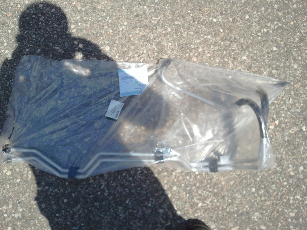

So just came back from line replacing at an independant shop. Paid 200 bucks for the job and tip 30 buck for those guys.
The line is C2C40418 from dealership.
Fluid loss is about maybe 1/3 of the quart bottle.
Car shifting is behave normal now.
They fiddling about 1 hour on trying to fish the line out with no luck, then I told them why don't you guys unclip those three black plastic pieces and see, they unclip those three black plastic bracket and both line were out from the car in five minutes LOL.
Putting in the new line also took out those 3 black plastic bracket and both line were fish in and connected in about 10 minutes just to be carefull.
Phone is acting up and people keep coming up for question about the car so not much picture was taken.
So another question is, Samsung Galaxy Note 2 or Galaxy S4 other than the size difference? LOL
Old line on the ground...
New line on the car...
New line in the package...
