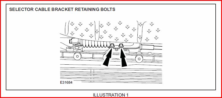

Have no special insite or expertise on transmissions but the one thing you must do first is check the bolts on the drivers side of the xmission that mount the shift cable bracket. That is a common problem with these cars as reported on this forum many times.

I've got the car up on axle stands right now. Where exactly should the cable attachment bolts be situated?
good news is: found it!
Bad news - they are in tight!
So now I've disconnected the battery to see if "rebooting" the electronics helps anything.
