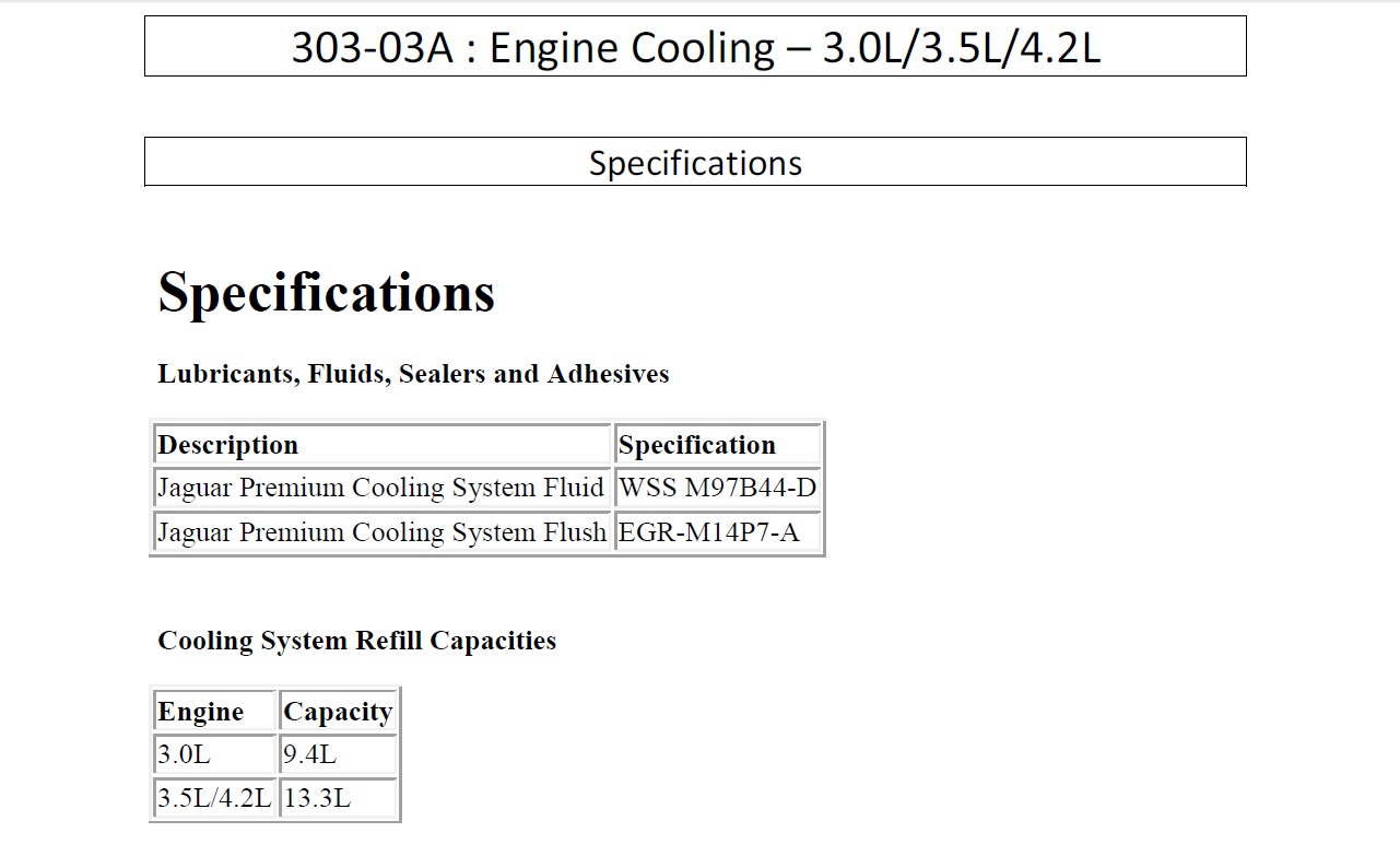

Here is and extract from the X350 Workshop Manual specification section showing the refill capacity:
Use a 50/50 mixture of recommended coolant/distilled water for refilling.
