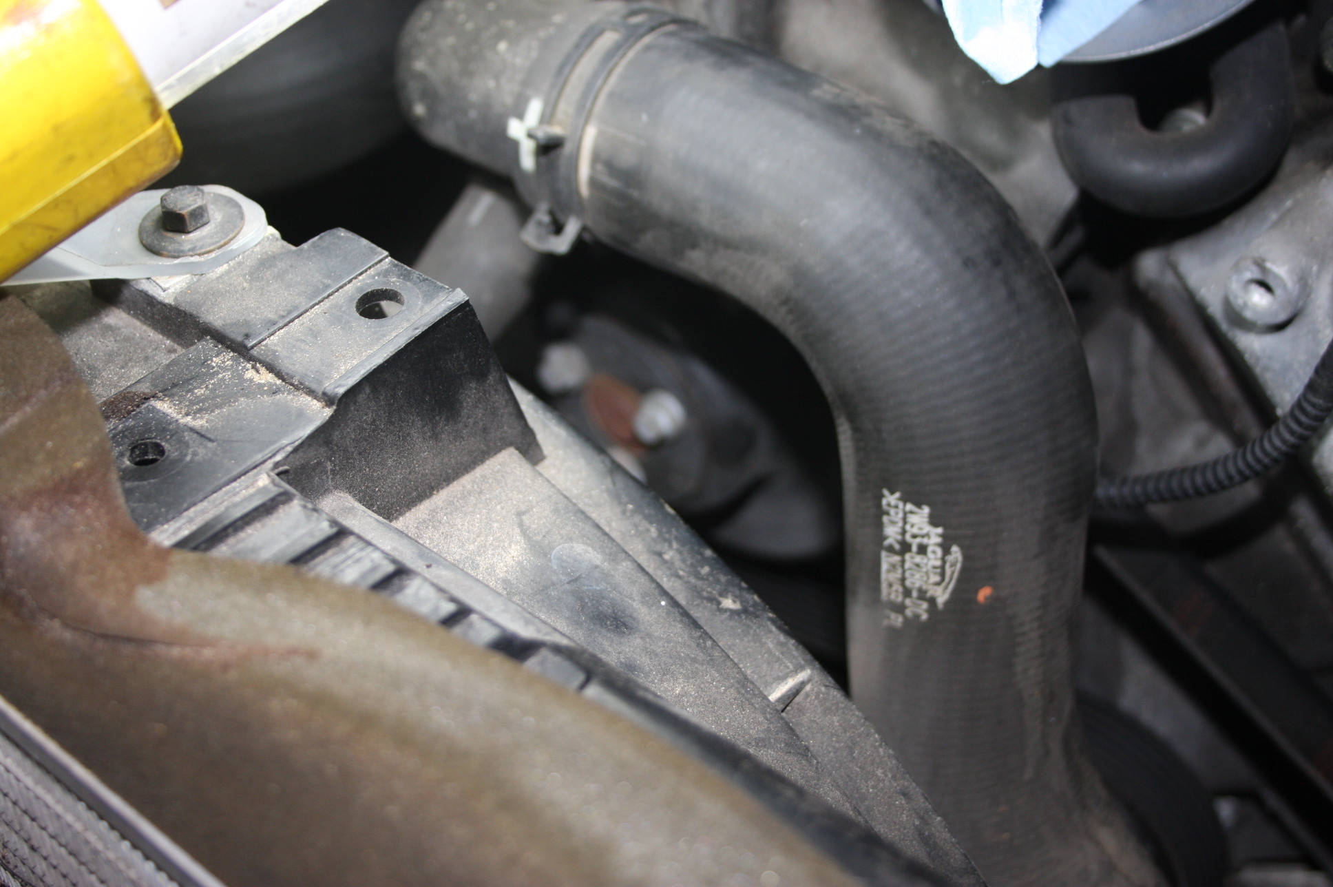

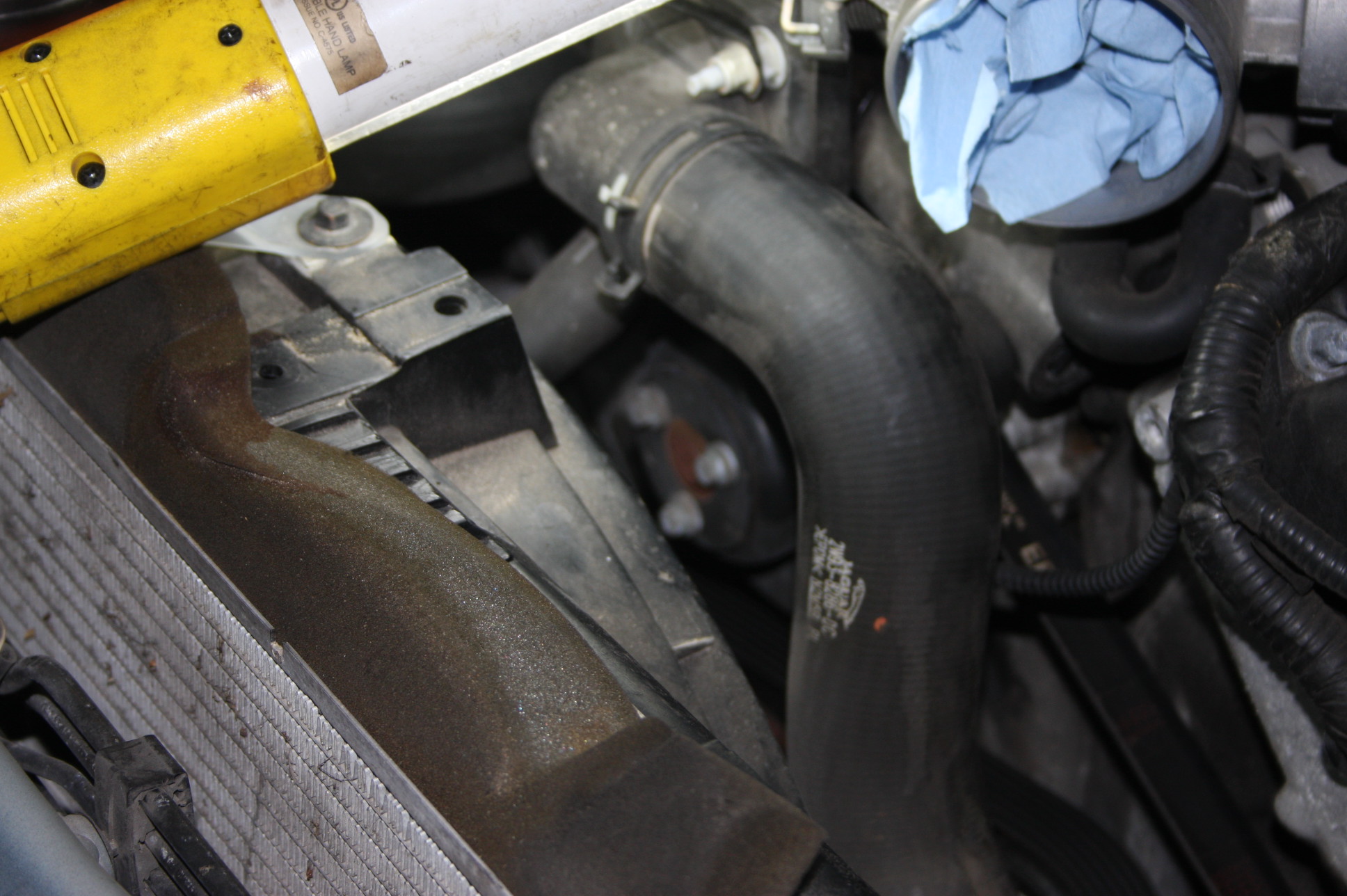

Default Follow up on water pump
After I started the procedure and trying to take pictures, I realized that it was rather boring for anyone to do that, seeing that it was quite simple.
So attached are the few pictures I took and they might give someone the courage to tackle the job themselves.
The first picture shows how I found the leak.--pressure pump and yellow adapter for screw on caps.
The second just show the nose of the water pump under the large water hose that has to be removed--simple, just open the clamp and slid the hose off and push out of the way. You'll loose about two q's of coolant, then a little more when pump is removed.
Third is just another view.
Fourth is of the bugger it's self. Remove the wiring plug out of the way and you have access to the bolts. There are only five (5) bolts that hold the pump on--two on each side and one below the pump. and they are the larger of the bolts you will see. The other smaller bolts hold the front of the engine cover on.
A side note: After ordering a new pump and finding out it wouldn't be delivered until the 5th, I started looking at different auto parts houses, but they all had the "Made in China" pumps with the plastic impellers, but I was wanting the metal impellers and at last found one at PEPBOYS that was made in Germany (BOSH) and it had the metal impellers. I felt a little silly running all over town in a blinding rain storm once I removed the pump from the car----it had a plastic impeller. Oh well, maybe that explains where it came from and why it failed.

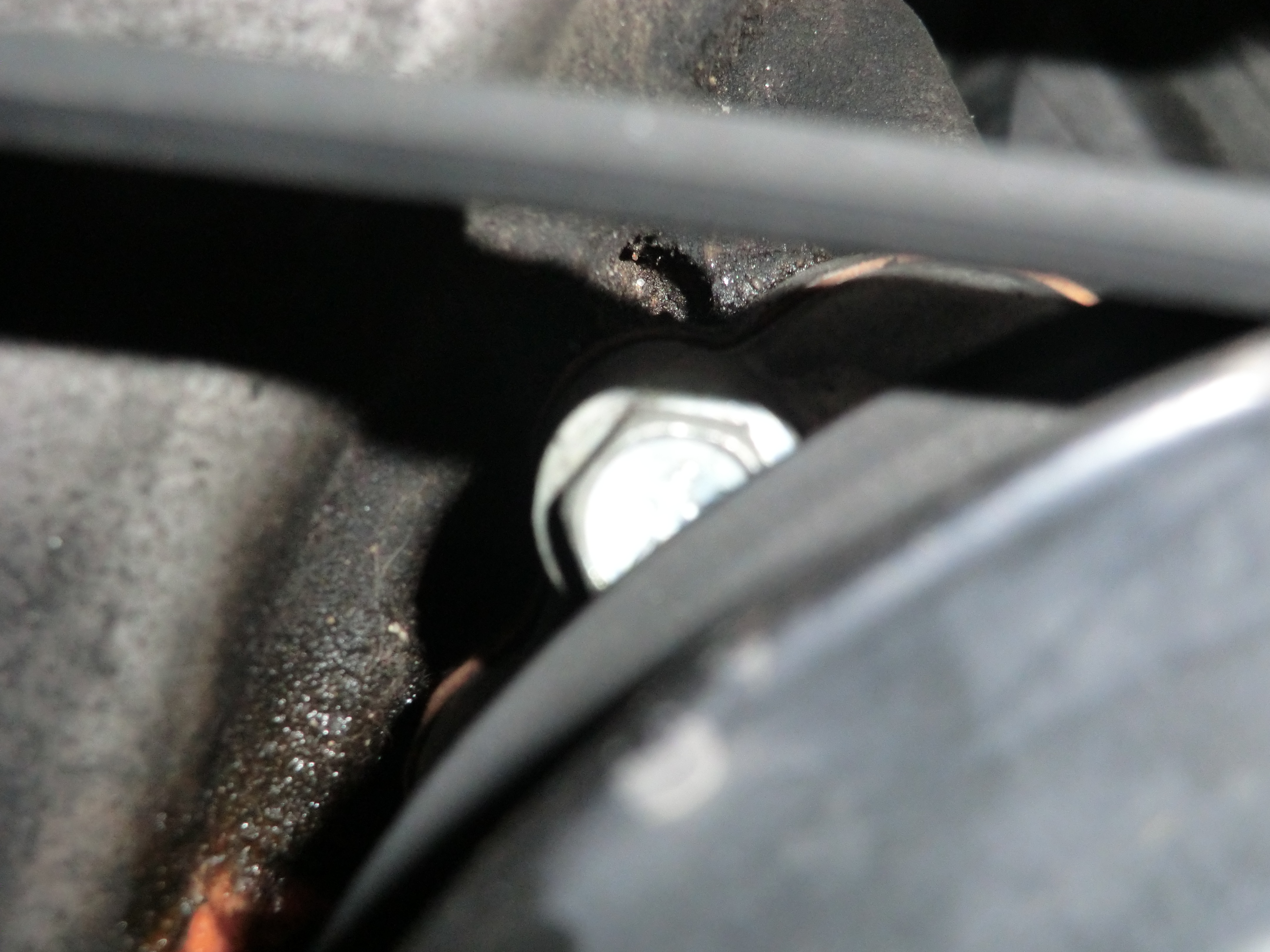

Default Small drip leak around water pump?
Is this the drip, drip you found on your veh, a rusty, gunky orange liquid?
Just noticed this on mine (this is a zoom in ) :-(
Water Pump Replacement 05/XJ8L-cimg6005.jpg
The wet look on the above pulley is WD40 (disregard that).
Water Pump Replacement 05/XJ8L-cimg6006.jpg
Water Pump Replacement 05/XJ8L-cimg6007.jpg
Water Pump Replacement 05/XJ8L-cimg6008.jpg

That would be right in the area Trosty, sorry! Looks like you'll have to break it down to figure out exactly where, but if it's the rear seal or the front seal- it's going to need replaced.
