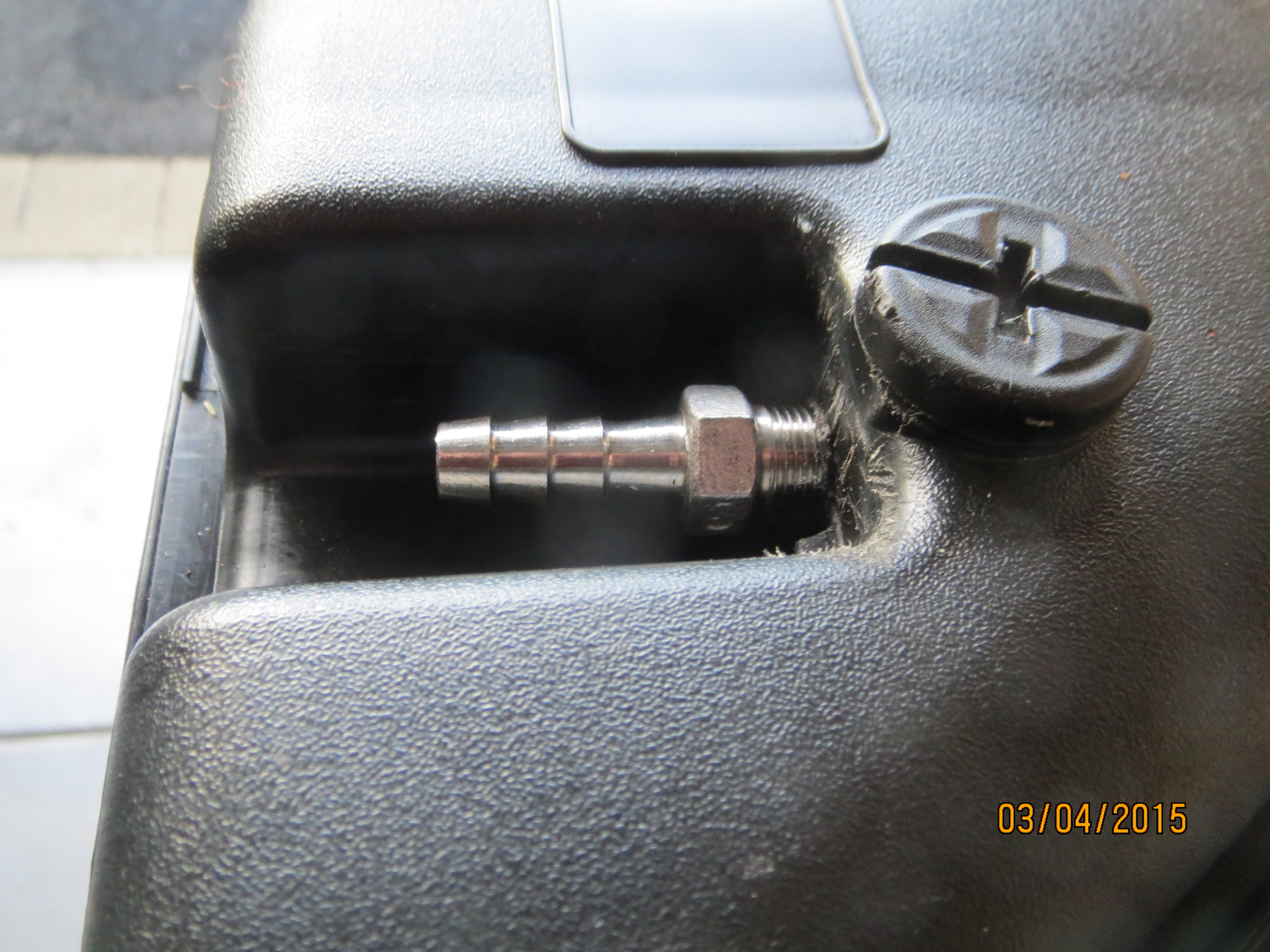

My solution to the plastic tank problem.
Never used in anger (yet)

That looks good!
