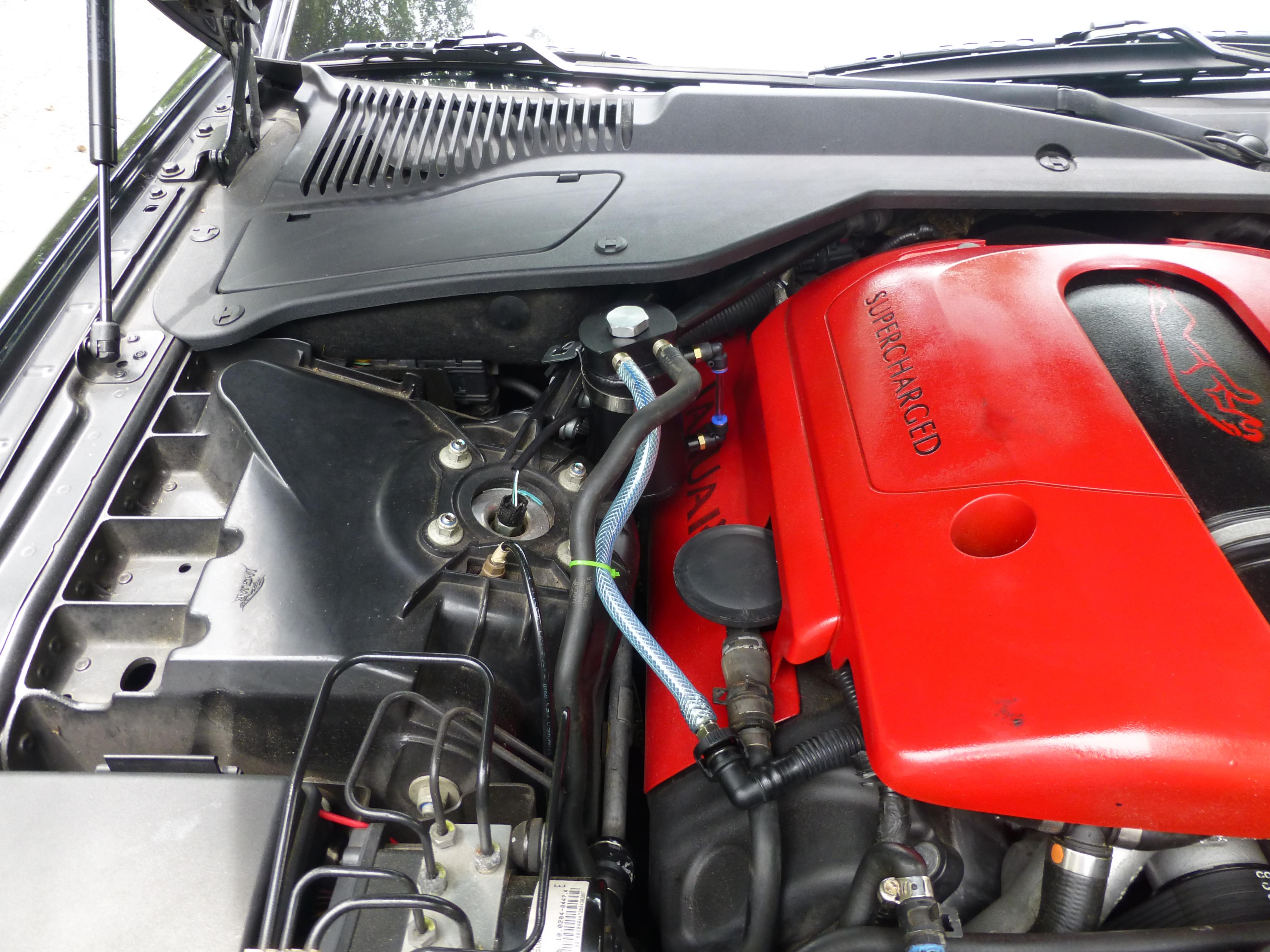

Today I installed an oil catch can with temporary hoses to the full load breather.
There was clearly visible oil inside the Norma connector going into the full load breather when I pulled it off. Enough to form at least one drip.
Hopefully it will help at least slow down the oil/carbon build up in the intercoolers which were absolutely filthy and clogged when I pulled them off
doing my supercharger swap about 1200 miles ago.
Will look at the part load breather another day. If I see oil there as well I will add another oil catch can however I am not expecting to see much if any oil there.
Attached Thumbnails What did you do to your X350/X358 today?-p1070368.jpg
I'm interested to see how much oil you actually collect.

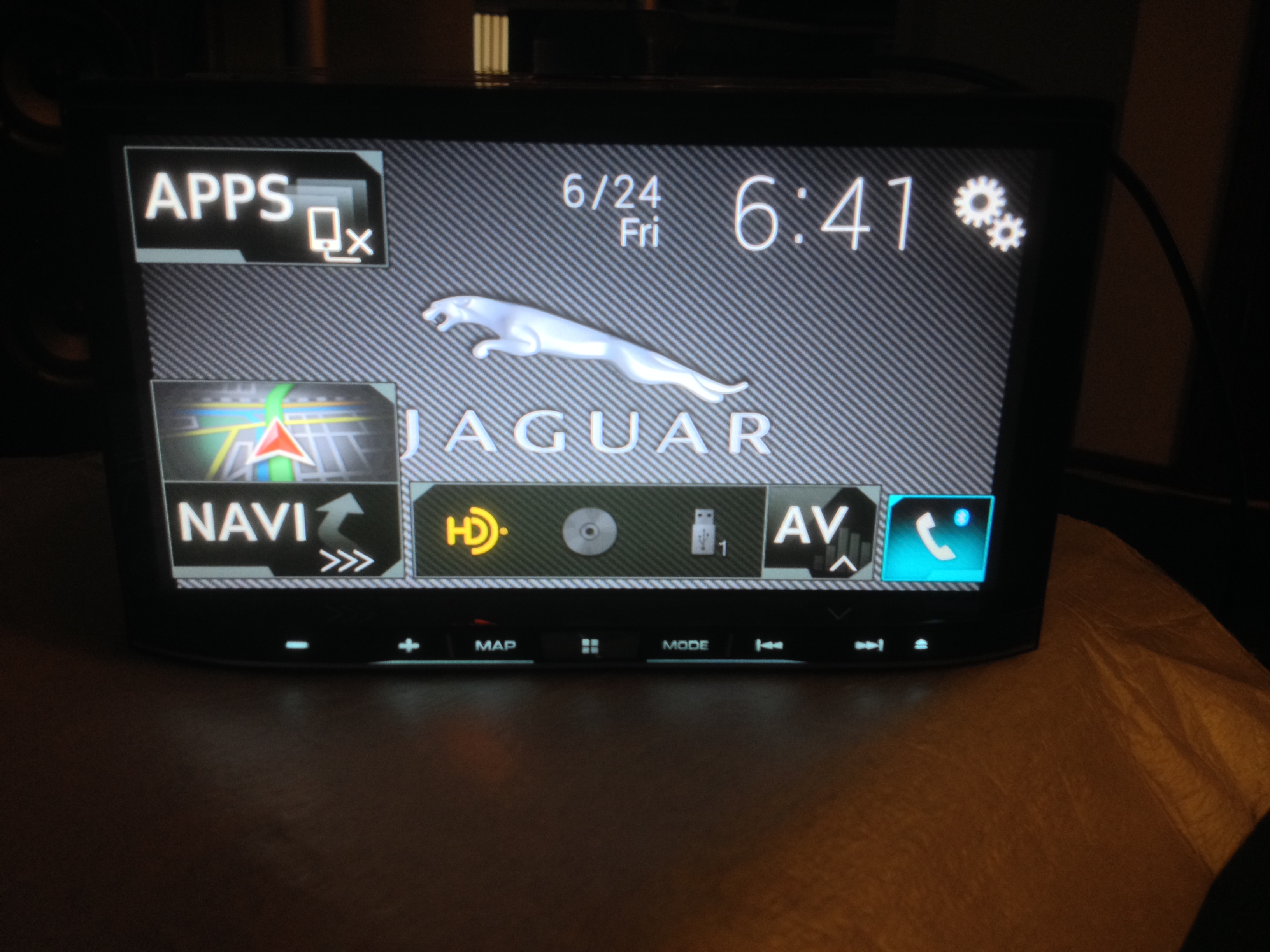

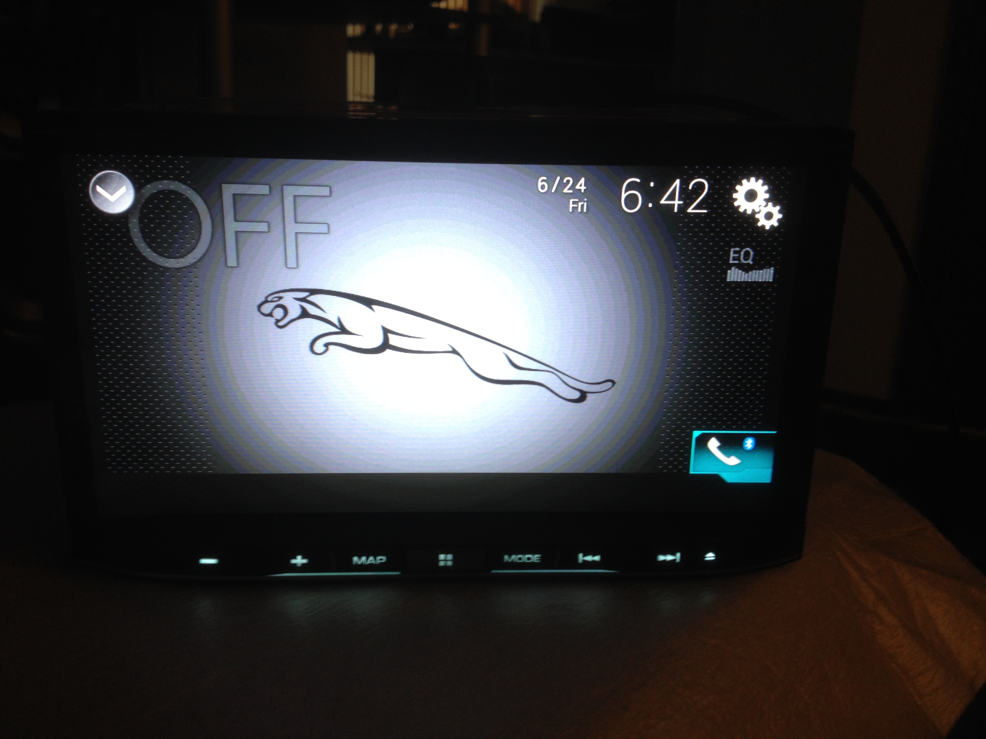

Today I got to do the shakedown on the mockup in the listening room of the audio components. Amplifier after mods performed breathtakingly. A listen to Fourplay's X or The Wailin' Jennys Bright Morning Stars was impressive. Now just waiting on the final few items and we can start installation.

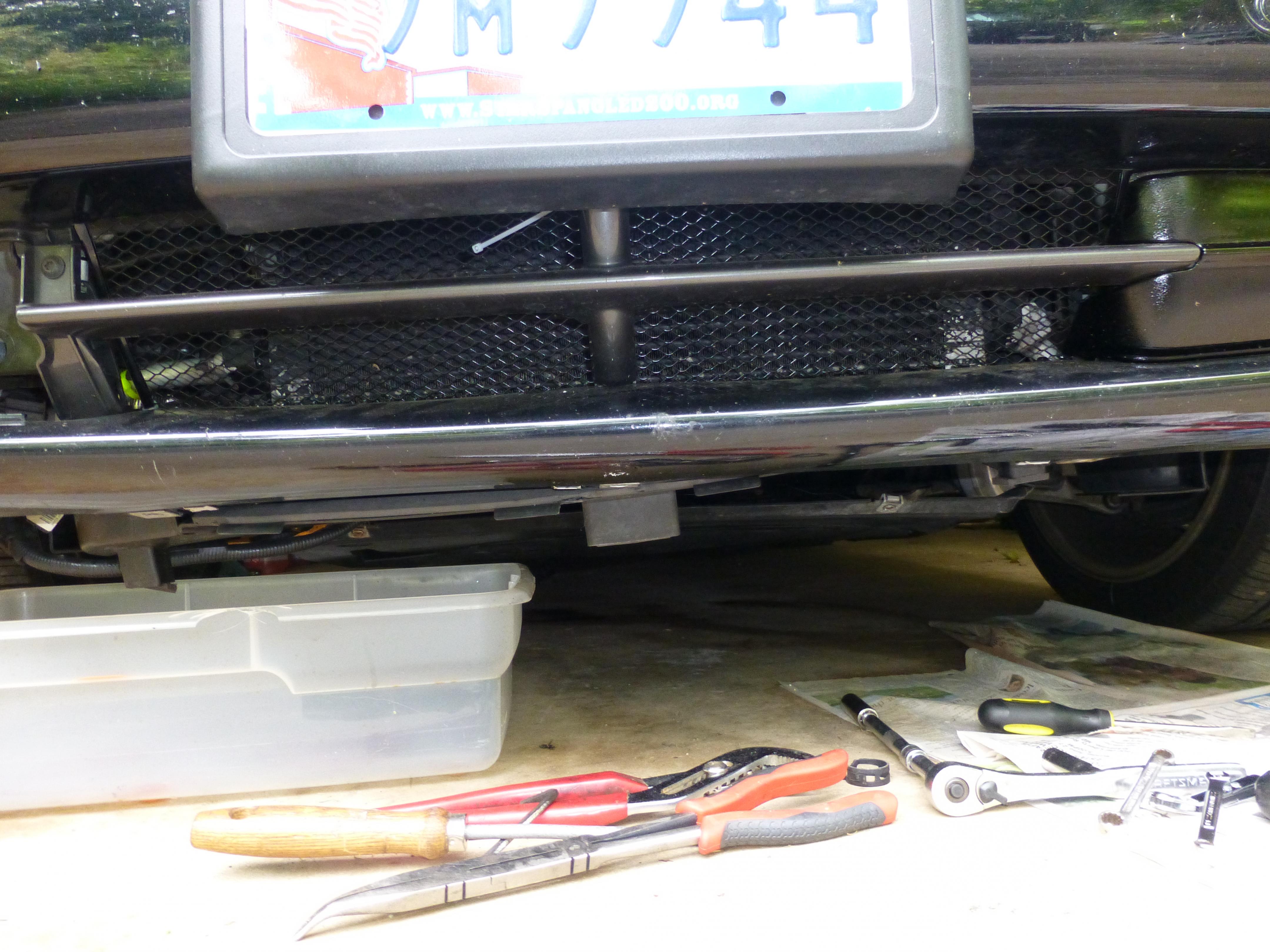

While I am waiting for my supercharger to come back from PSE, they found a dud bearing, I installed the upgraded IC pump in its proper location and installed a new aux pump.
I originally and mistakenly replaced the aux pump with the upgraded pump.
While I had the bumper off I upgraded the fog/spot lights to LED bulbs.
Next step is to reinstall the super charger when I get it. I am also going to wire my two 6" fans on the additional IC radiator to come on when the ignition is on at least for the Summer.
I was somewhat concerned with the hits the oil cooler has taken thru the lower bumper opening so I installed a black wire mesh on the inside of the
opening.
The errant white Zip tie I did not see until I took the pic. Its gone now.
Still WIP as I need to check the IC pump after I install the SC.
